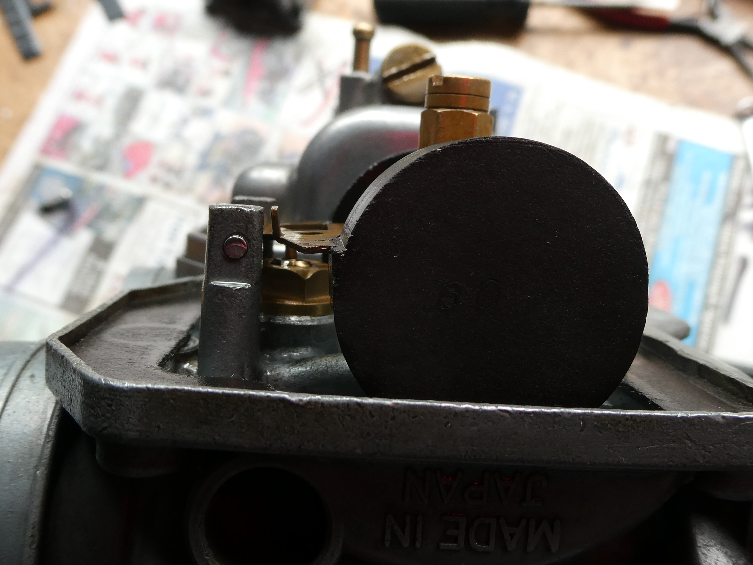

warren3200gt wrote:If your floats are in upside down the float tang will stop the floats rising sufficiently to fully close the valve. Are you 100% sure the stop tang is pointing down towards the float bowl and not up towards the carb body?
Yes the floats are the right way up, have checked and hoped that was the cause several times.

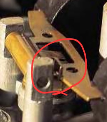

warren3200gt wrote:Here then.?
Where my less than straight line was meant to be.
Yes
Posts: 3110
Re: Z900A4 float levels
#33 PostAuthor: warren3200gt » Sun Jul 09, 2023 2:37 pm
This picture is the right way up. If they are like this then there's only two things that it can be.
1) your float valves are not sealing or the float valve springs are shot.
2) your floats are not as buoyant as they should be.
Screenshot_20230709_153136_Samsung Internet.jpg (39.53 KiB) Viewed 11215 times

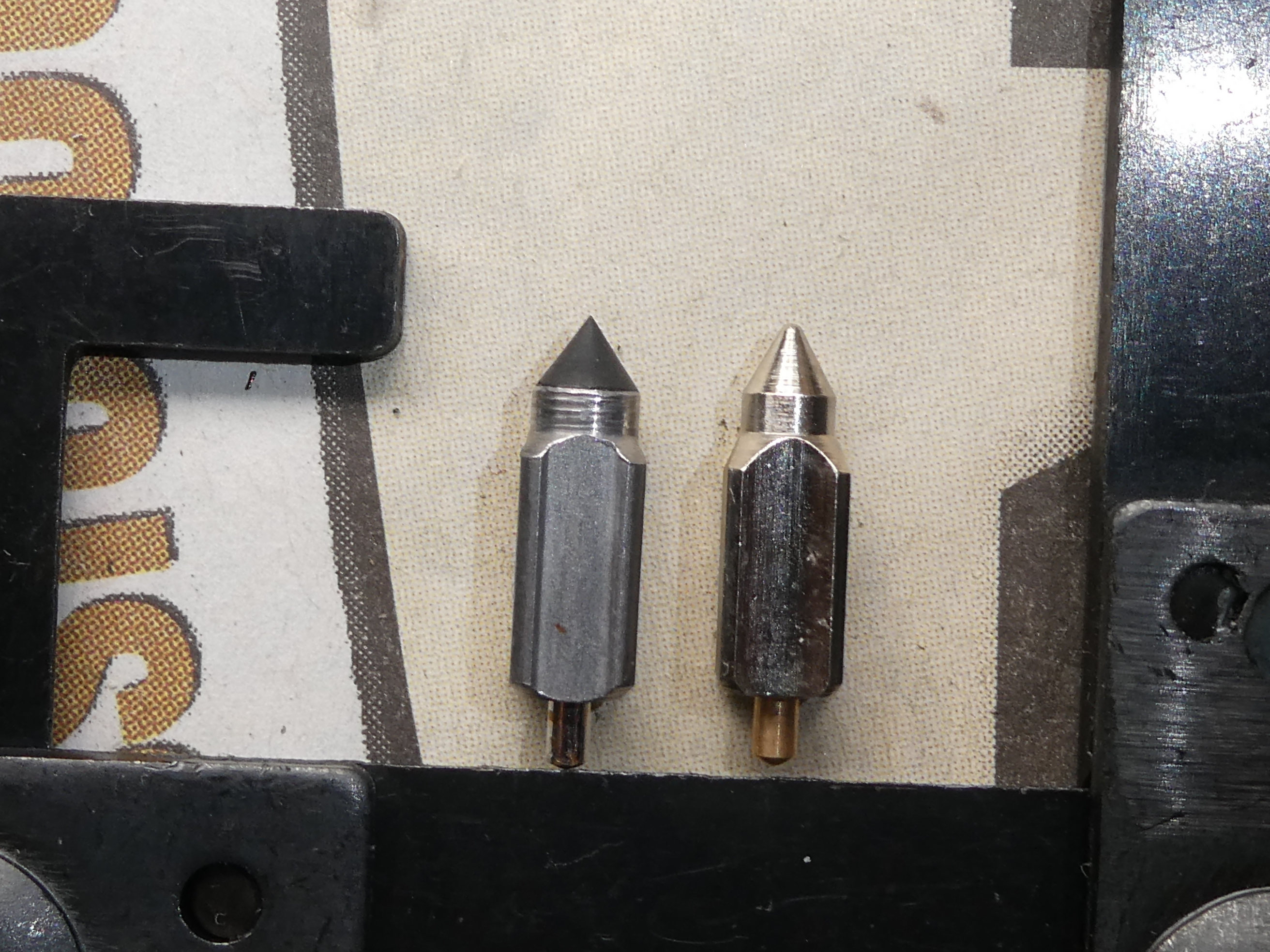

See attached photos re float, tang to bottom.
With regards to the valves. I have/had been using the rubber tipped ones, that came with the bike (not sure if they are original or aftermarket?) and not the Kester ones on which I have found that the sprung loaded plunger to be very sloppy with very weak springs. There is so much play in the plunger that it pushes over first rather than pushing up.
However, on looking at the side by side photo it can be seen that the rubber tipped ones are slightly longer but also the rubber tipped ones have a different angled profile than the all metal Kester ones. I am not sure if as a result the profiles mean that they are not interchangeable and can only be used with a paired seat?
Having said that I have tried both valves in the same seat and it has made no difference.

You have mail.
Valves, I've not ever used kyster valve or those rubber tipped ones.
Keyster are said to be good but looking at your picture the conical surface doesn't look very well machined to me. It looks to have grooves and scratches all over it. Don't think that would seal very well.
Regarding the rubber tipped ones as the are different length to the Keyster it means the static dry float heights you seem keen on are irrelevant. The dimensions Rob gave you are for genuine mikuni matched pairs.
Looking at your pictures the valve seat appears to be original mikuni so not sure either of those needle valves would work well.
I believe that mikuni did use the rubber tipped ones but not in 1977 so you could have a case of genuine mikuni seat, genuine mikuni rubber tipped valve, Keyster valve but none of them are matching pairs.

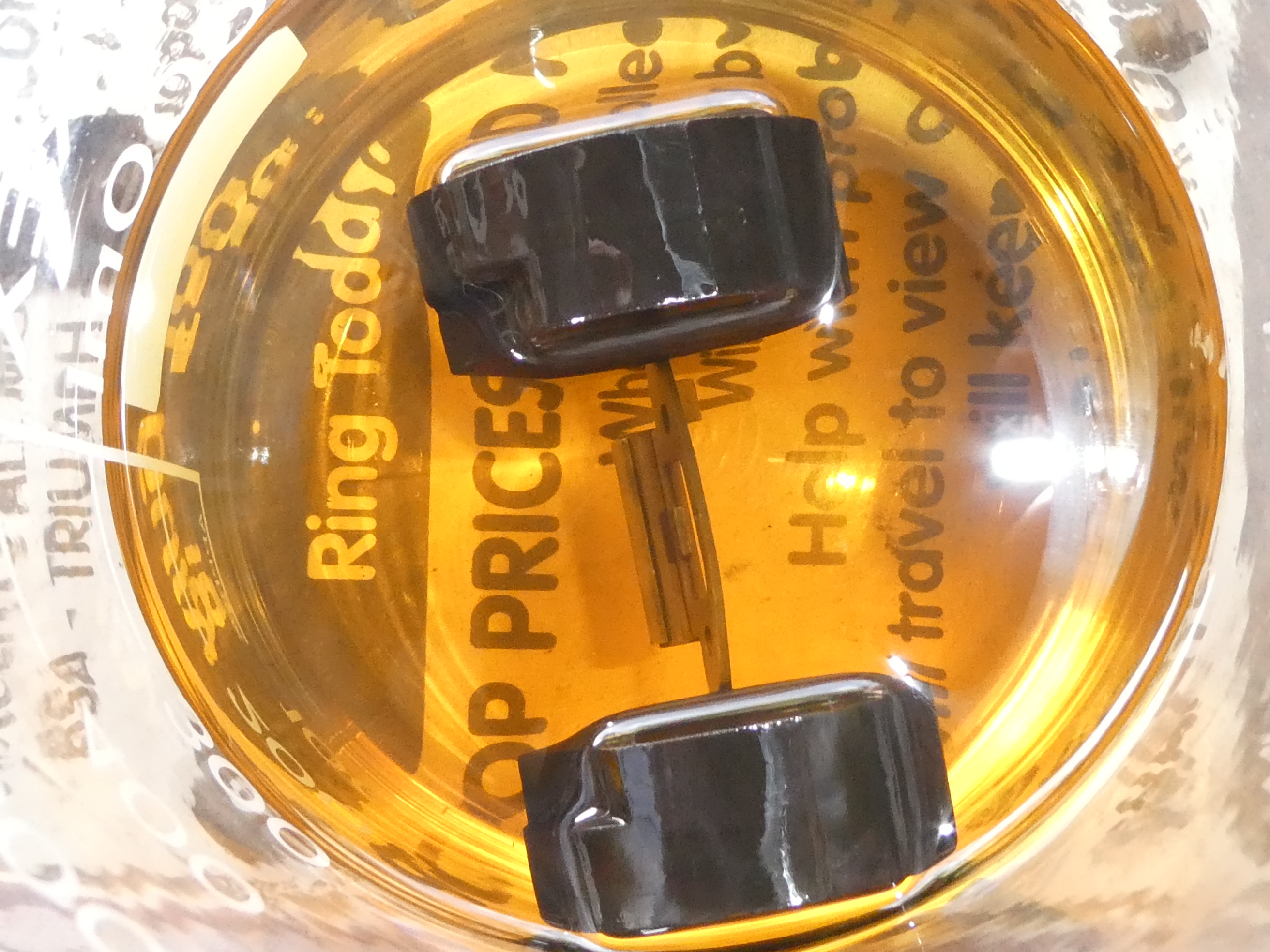

Your floats look very clean, so assume they are new?. Not aware of any aftermarket ones available so assume they are genuine mikuni and should be fine. Worth just checking they all float equally at the same height in a bowl of water and don't have any fluid sloshing around inside them from being perforated.
I think your issue lies with the mismatched valves and seats and if it were me I'd just bite the bullet and buy new matched seats and valve genuine mikuni sets from allensperformance. Co. Uk.
At least then you'd be working with a known quality and starting point.

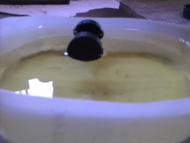

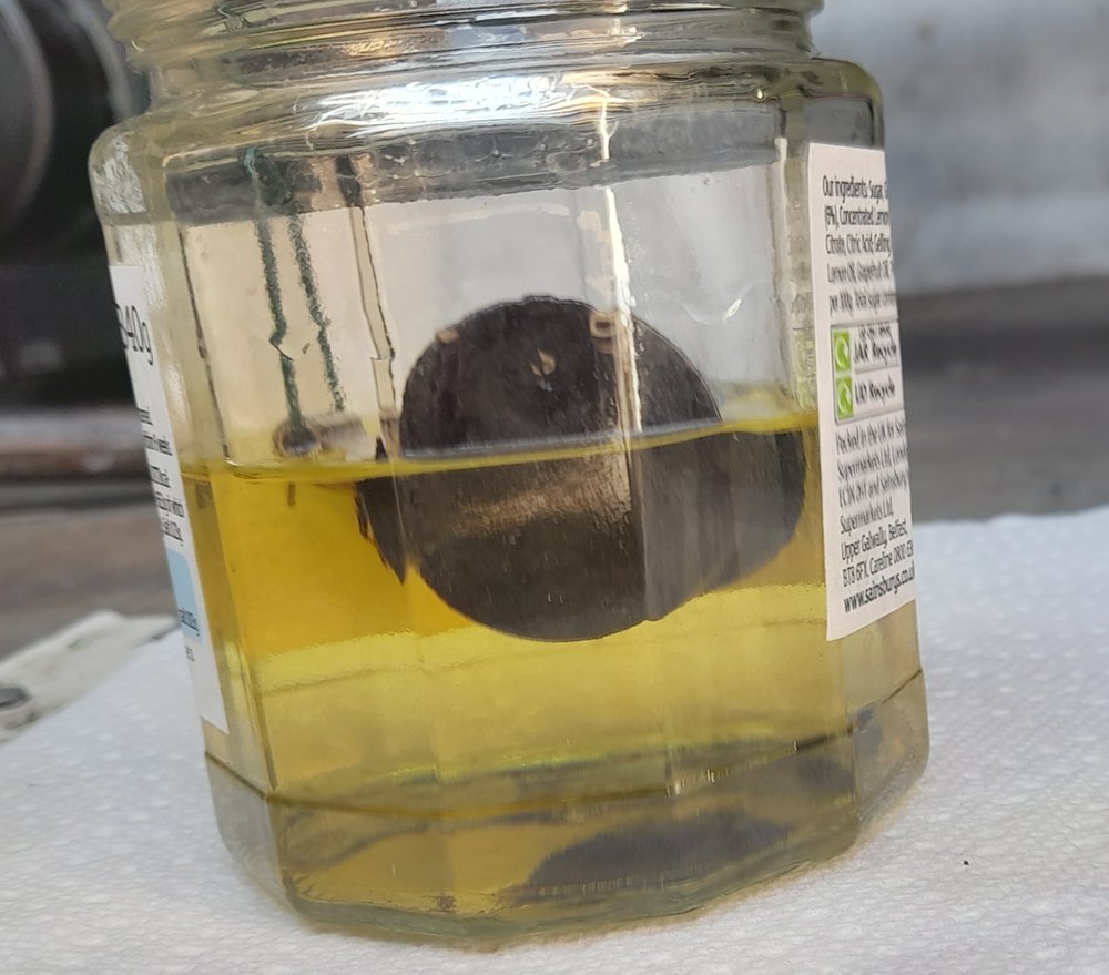

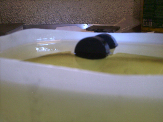

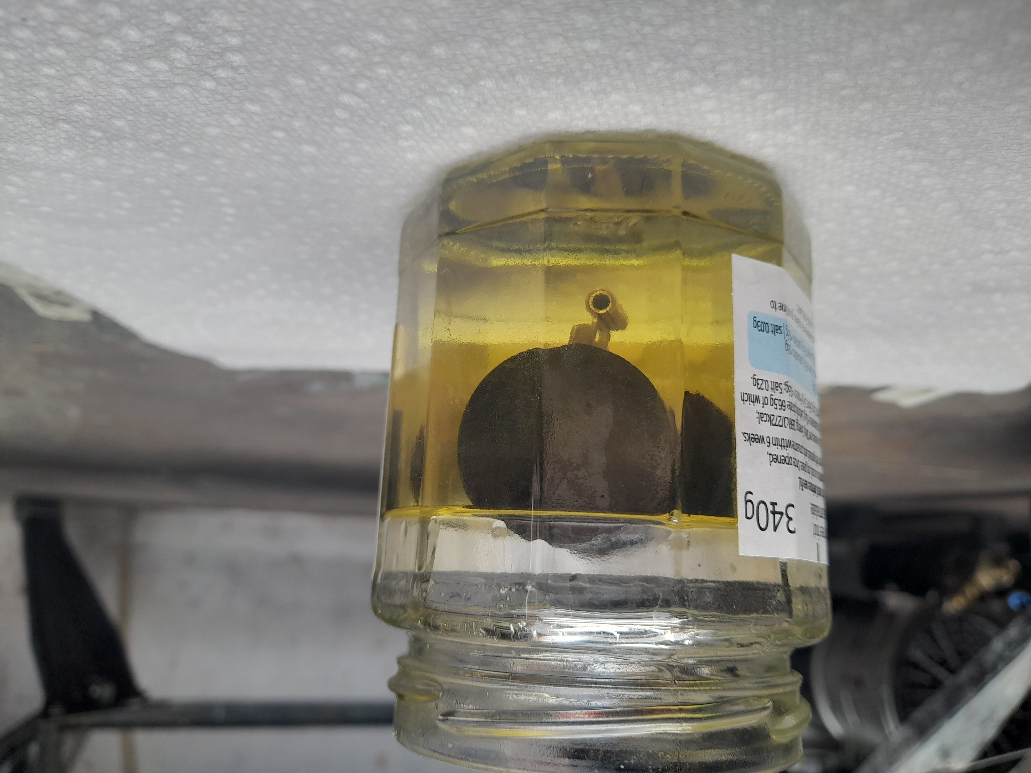

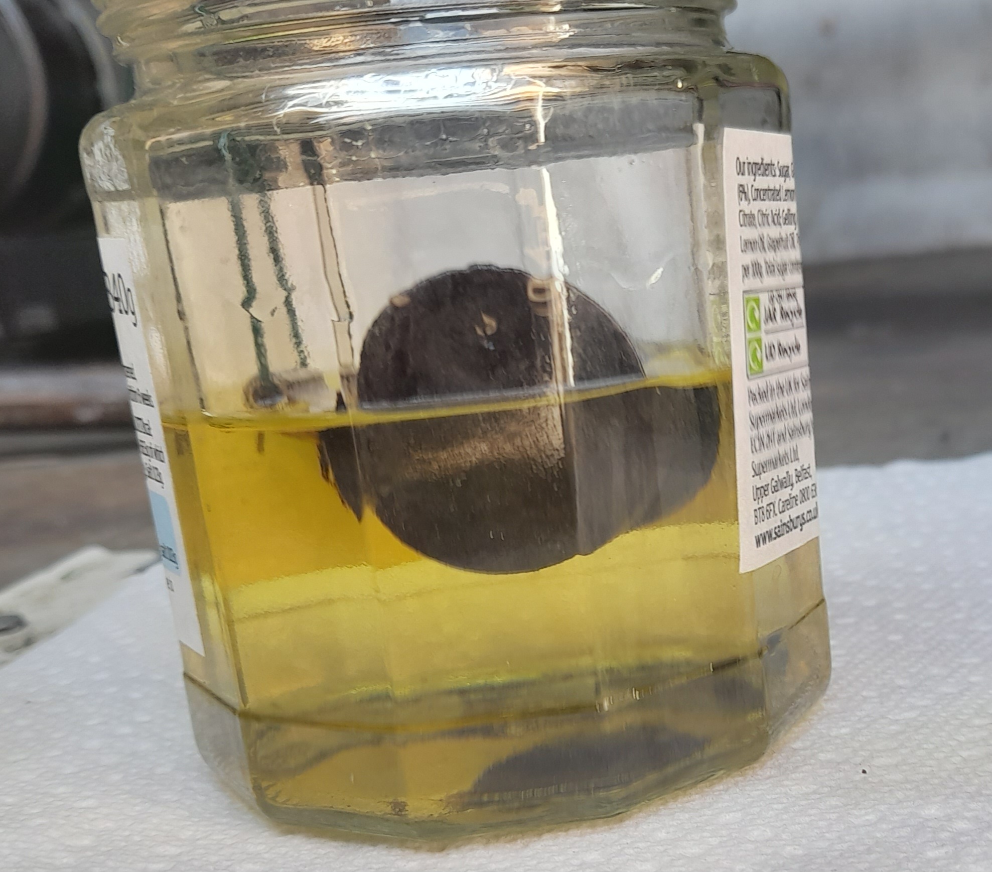

#38 PostAuthor: sprint » Mon Jul 10, 2023 11:53 am
The floats are original and not new replacements. Dropped them into some petrol, see attached. They all float to the same level so assume they are all OK? They are the sold type so nothing can get inside
I am not sure as to if the rubber tipped and no number/marking seats that came with the bike are original Mikuni, but I've have the same problem with either the original, Kester or mixed sets, so at a bit of a loss.
I will enquire to Allen's as to the availability of genuine Mikuni valve/seat sets but if they do not work not a lot gained?

#39 PostAuthor: zed1015 » Mon Jul 10, 2023 3:11 pm
Those floats are sitting miles too low.
There should be approx half the float above the surface and that's why the static height measurment is way off.
Original float valves for the VM 22/24/26 and 28 are solid tipped but the viton ones should be better.

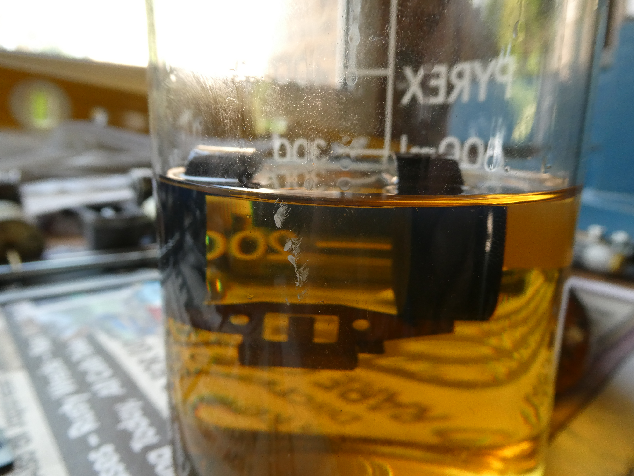

#40 PostAuthor: warren3200gt » Mon Jul 10, 2023 3:25 pm
I thought that too Rob so went and tested some spares that I have and free floating in fuel got very similar results.

warren3200gt wrote:I thought that too Rob so went and tested some spares that I have and free floating in fuel got very similar results.
The floats do degrade and get heavy over the years and if i get any that bad i replace them.
From new they should be close to half way.

#43 PostAuthor: warren3200gt » Mon Jul 10, 2023 4:25 pm
Disagree Rob. When mounted on the hinge pin and posts they are very much more buoyant than when free floating as a lot of their brass components weight is supported by the posts/pins.
The actual black float part of the floats I pictured sits about 50/50 above below fuel surface level when mounted and in the bowls.
