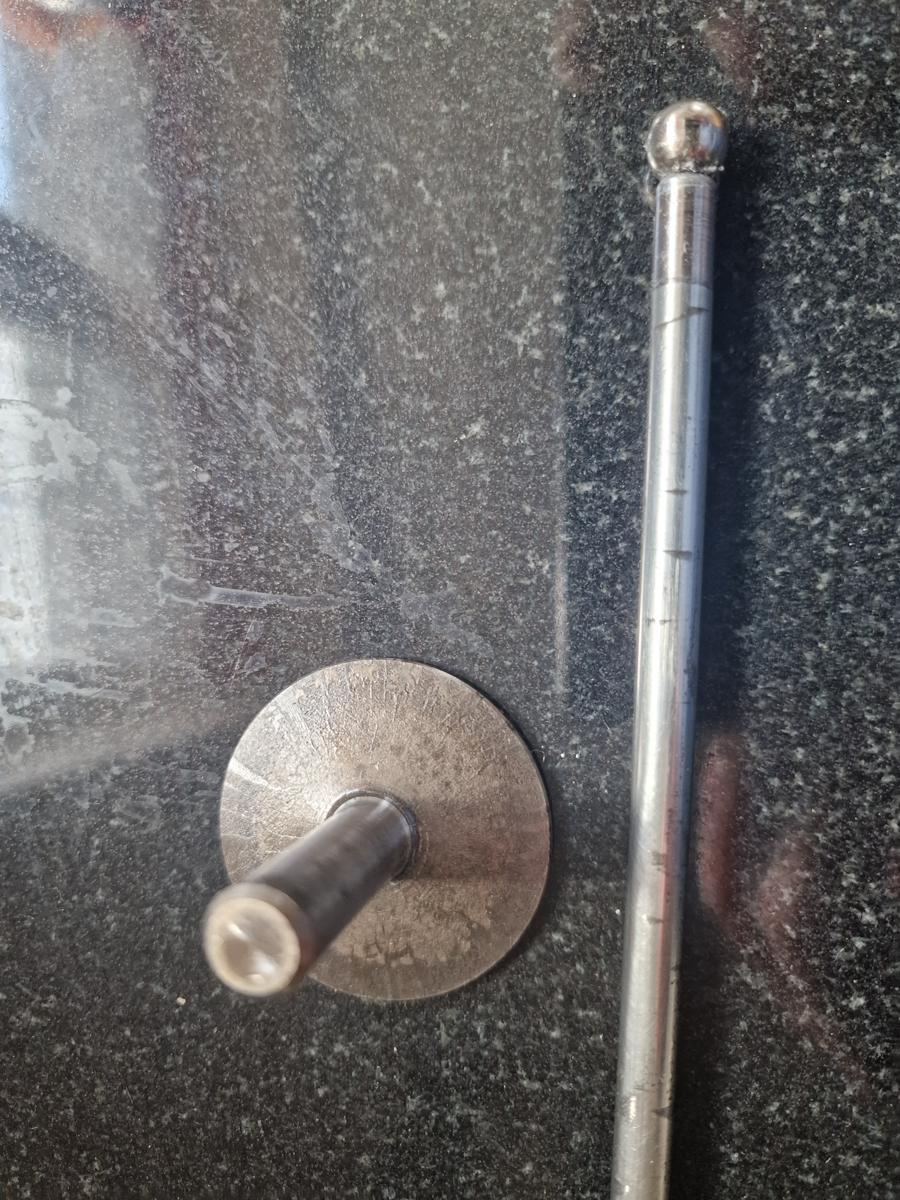

Right well stripped clutch cover off and drained oil, decided will change it anyway now as done 300 miles wudv changed it at 500 anyway after rebore.
Rob was spot on with his assesment! the push rod has indeed spot welded itself to Ball (see photo) so question rod looks ok apart from weld can i just cut ball off and get new ball bearing grind rod flat mushroom looks ok too but ball bearing has ground flat on part that touches mushroom as well as where its welded, must have got bloody hot to do that. On the plus side no particles in oil and grittyness i could feel was as it was,welded. So more work to do now
Thanks Guys

Don't penny pinch on this as the hardened surface of rod and ball will now be compromised due to the heat weld, others may say it'll be alright, but I would renew both

Fair comment Kev, thinking that myself the ball came away from rod fairly easily, it was 1 tiny spot weld on the edge of rod, but as you say it may have damaged the rod itself or at least the hardening the ball bearing is scrap anyway, mushroom looks fine though?
So now more parts to add to my growing list inc a new gasket set and rod seal too.

Rod and ball about £30-00 posted from zpower.

Afternoon Guys, right well got full clutch stripped, measured all 8 playrs all at 3.69mm workshop manual says 3.7mm new 3.4mm wear limit and can still see all the indents on both sides of plates no burn marks so think clutch itself all within wear tollerence limits, however did find 1 plate sticking, will have to check for burrs on the lugs. All plain plates look fine without any wear.
The springs are all same length as each other so again look ok, the main issue i believe was the welded ball bearing on push rod,xwhich will be replaced along with new 5/16" ball bearing. Think issue was at somepoint in its life was incorrectly adjusted, when i originally stripped it i thought thats how push rod was supposed to be with ball welded to top? Should have checked back then andcreplaced it, then wouldnt have to do it again. This is problem with old bikes they have been messed with many times so your not sure what is a bodge, a fault or as it should be.
