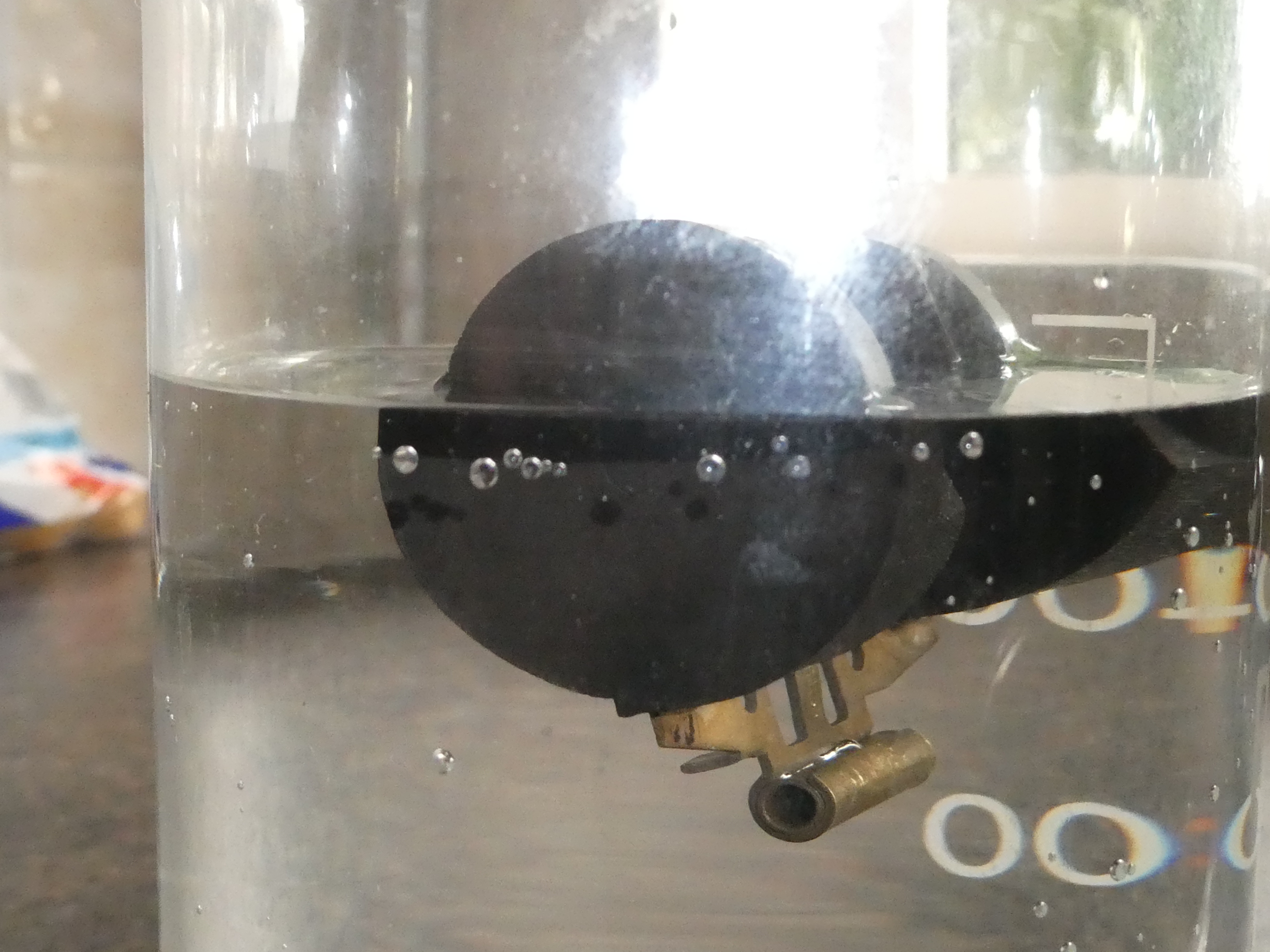

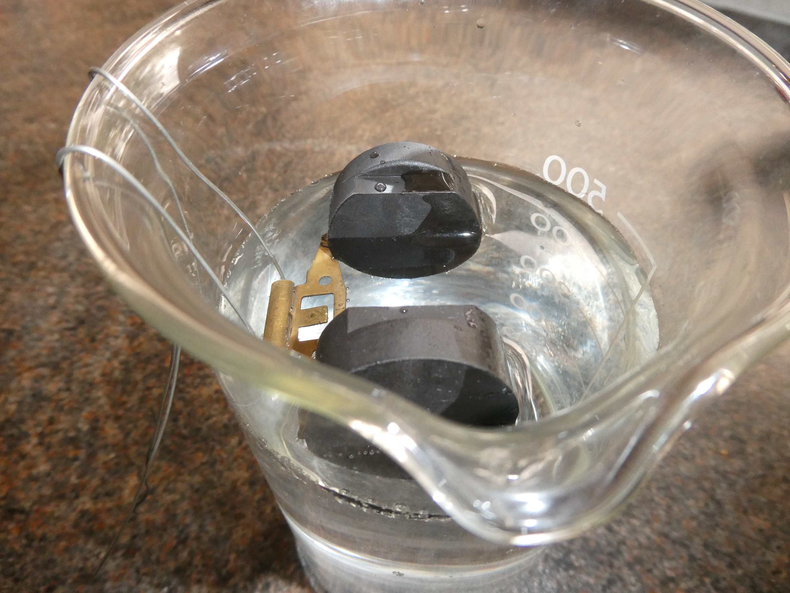

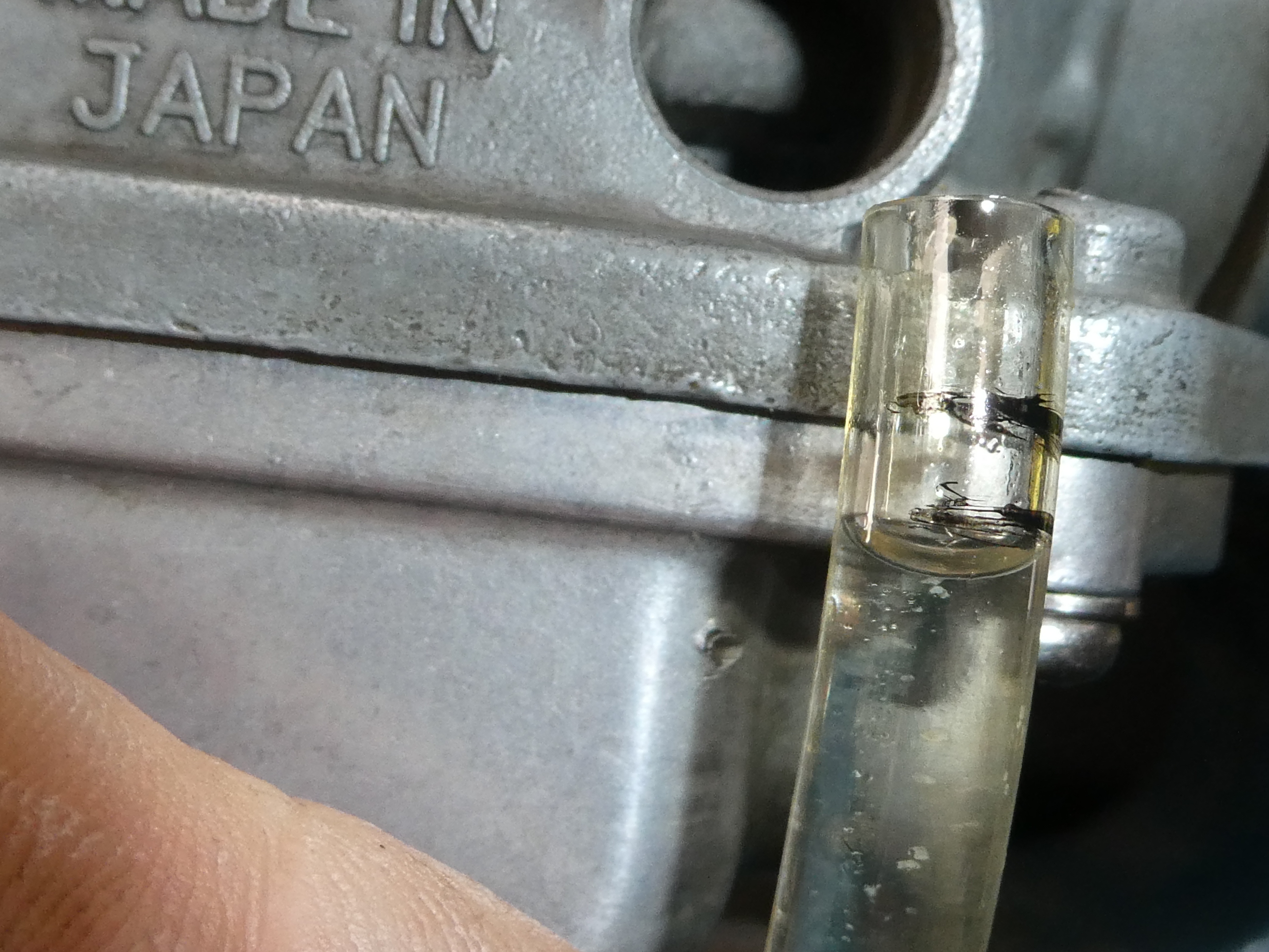

Tested one in water supported at the pivot and it was around 50/50, see attached.
Floats much higher in water supported or not. Would expect it to be lower in petrol as it has a lower density than water by around 28% so it will sink lower until it has displaced it's own weight.
Original Kawasaki seats and valves are also available at £74 each, daft prices but I guess it's old stock and not made anymore?
Kester sets should be OK, hundreds if not thousands must have been fitted so if they all exhibited to problems I am experiencing it would have been well known by now?

In my pic they are in Shell V power .
New floats don't have to be that expensive if you know where to look but as long as yours don't sink too low and you can still get enough adjustment on the tang they should be ok.

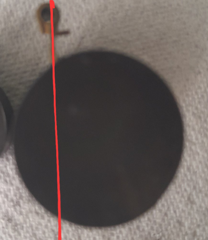

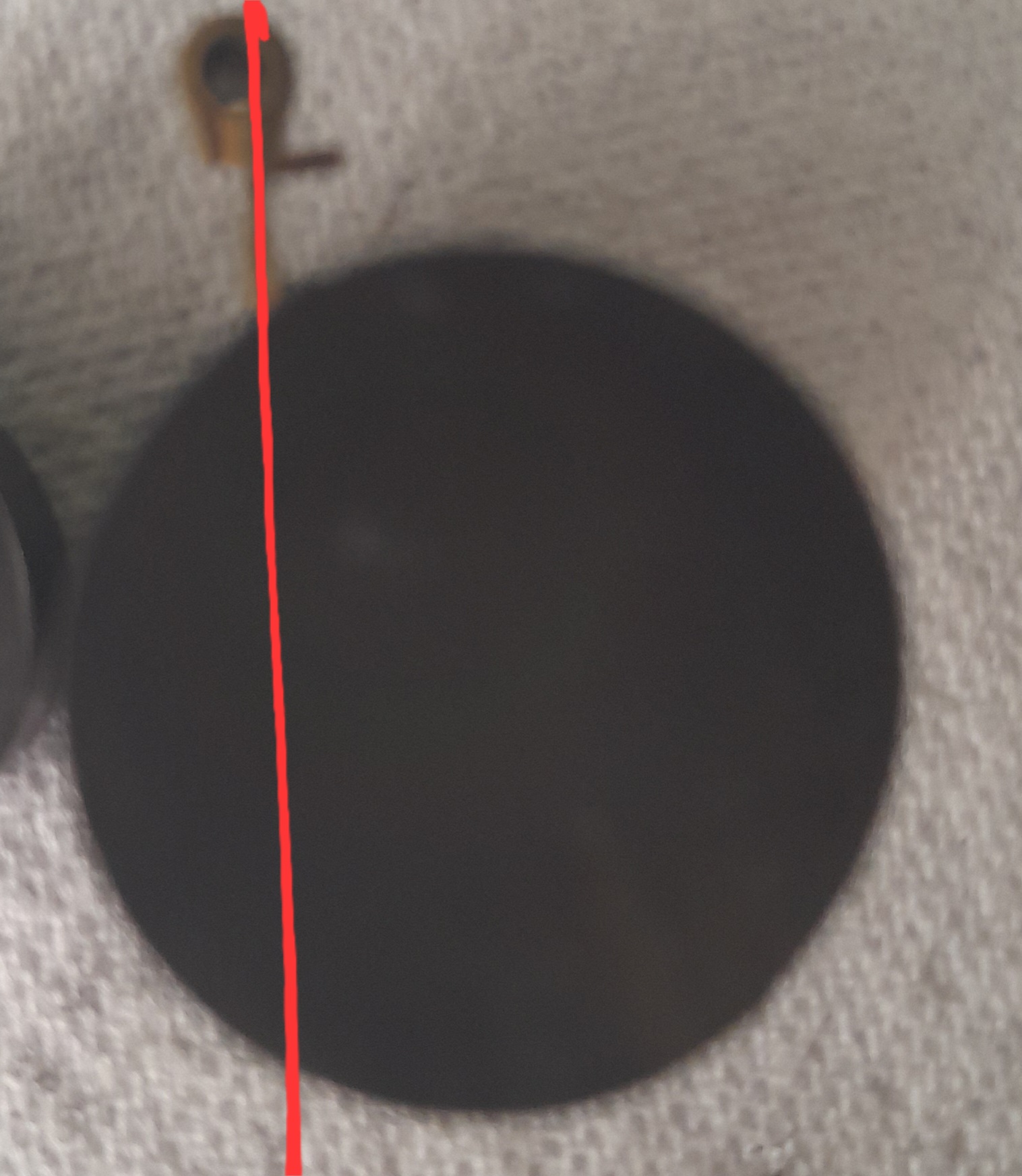

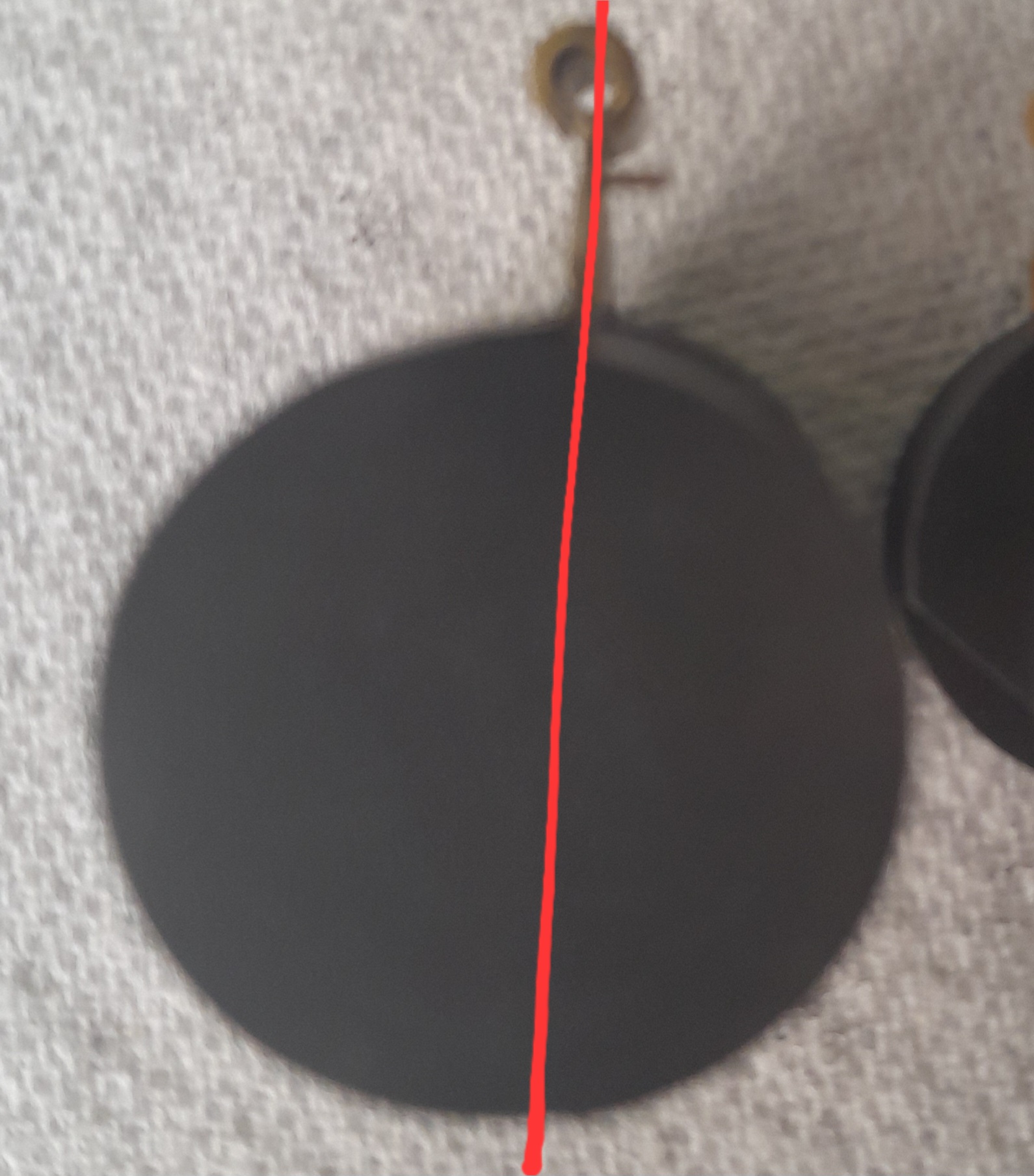

OK, in the vein of not having to spend £450 or even £100 on new floats that have greater bouancy I decided to see if there was a little or no cost way of achieving shutting the fuel flow of the needle without having the bowl fuel level too high or having the tang bent up excessively so that the needle doesn't drop straight and risks jammimg open.
Well it turns out its simple. Keeping the main hinge plate level just bend down the floats at the point it enters the float. Lowers the float in the bowl without changing the tang position from where it would be with more buoyant floats.
A quick test reduced the bowl fuel height by 4mm between these two floats. Both tested with the tang level with the hinge plate.
Straight hinge plate about 50% up the float body (excuse my less than level red line!)
Same float set with the floats bent downwards.

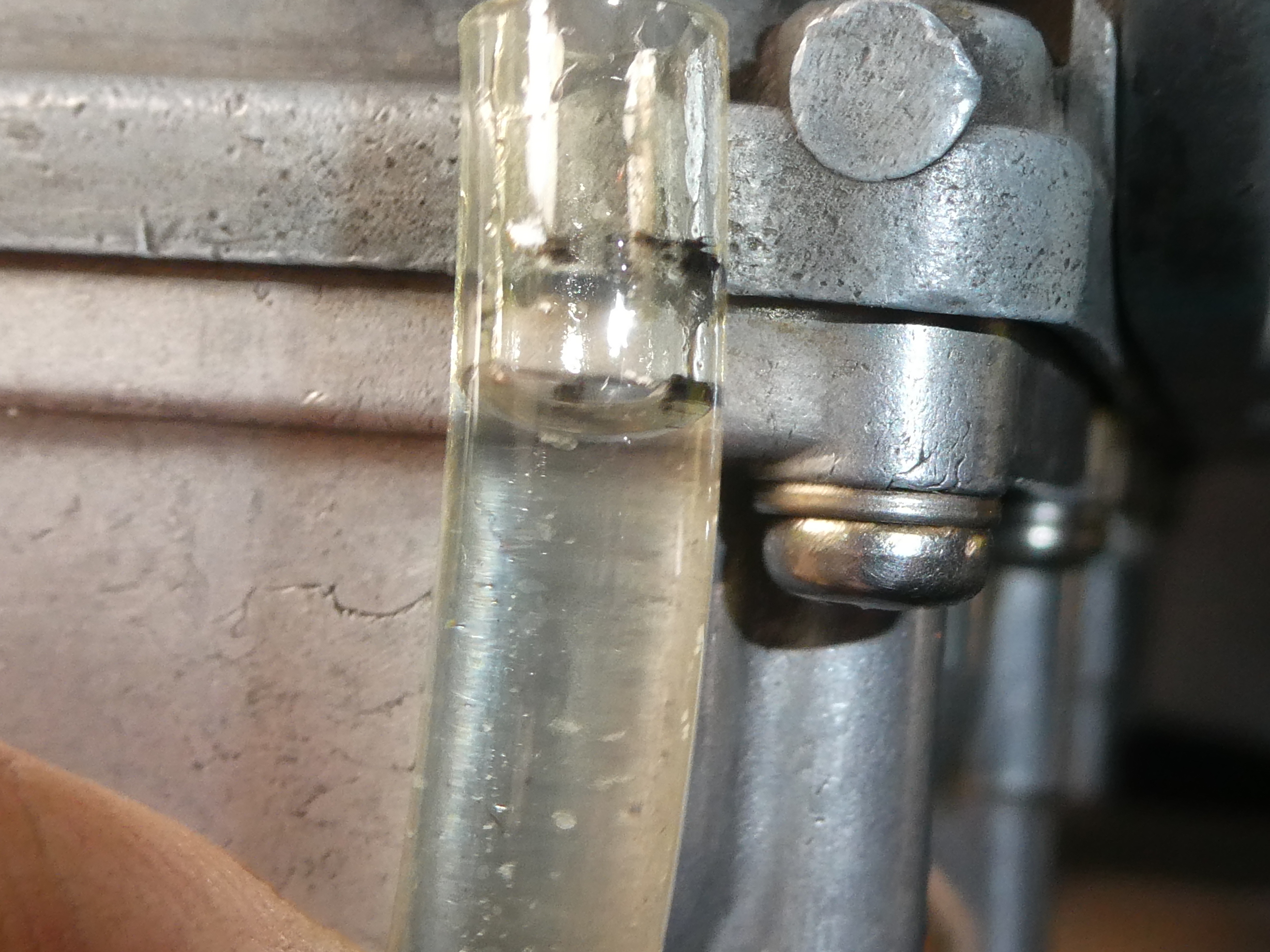

Running the engine with the tap off until it dies won't completely empty the bowls. Pilot jet is higher than main jet so once that is above fuel level it'll kill the motor. Even if you used feathered choke, lowest possible pick up point, it won't completely empty the bowl.
You could measure the float drop from the body mating surface to the bottom of the float then measure the bowl depth to see if the floats would even reach the bowl bottom. Adjusting the float stop tang would resolve it if they did.

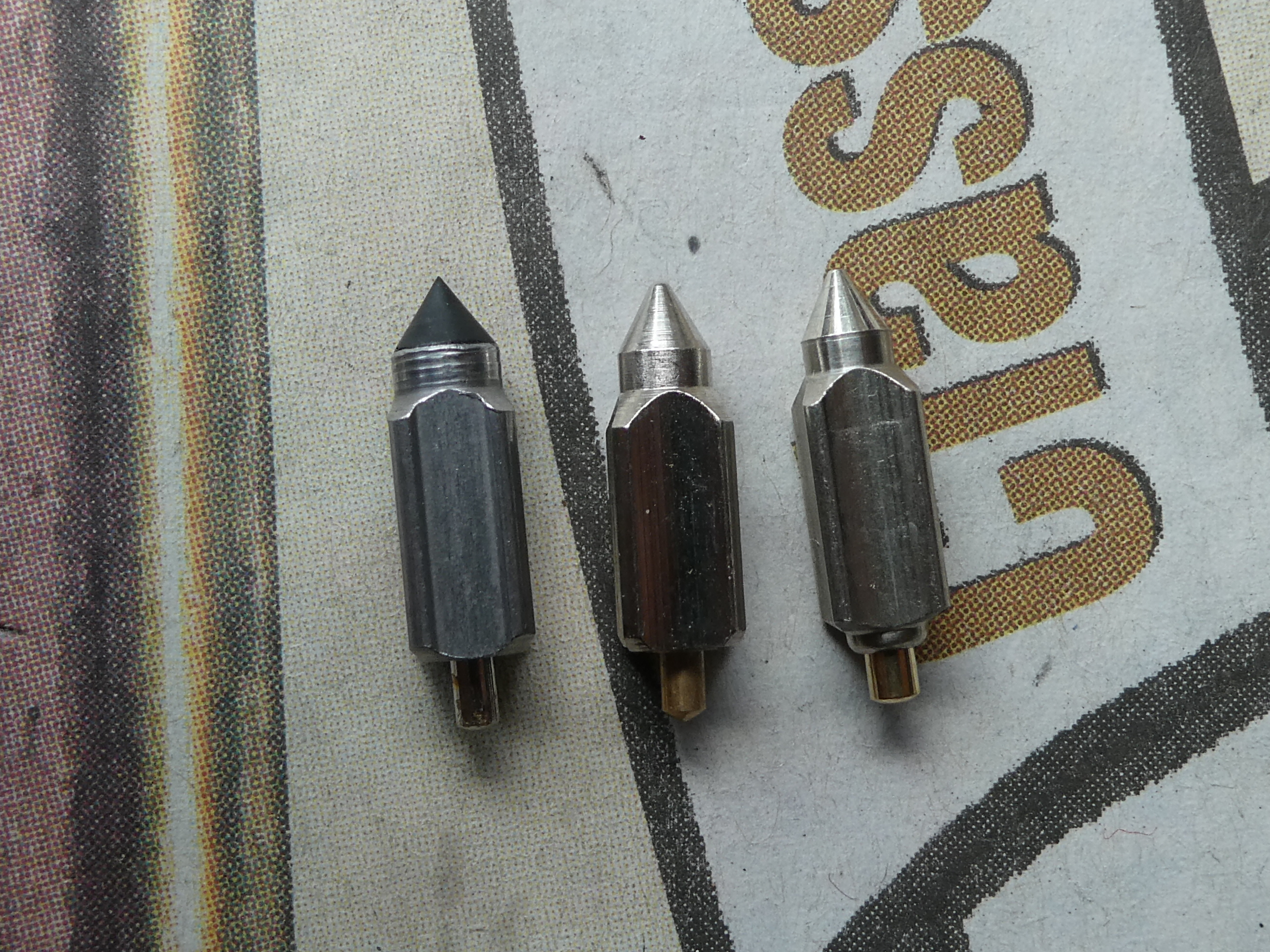

Kester seats/valve arrived this afternoon.
Attached photo of all three sets I have.
There does not seem to be any appreciable difference in the overall length of the valves and the seats are all the same dimensions except for the ones that came with the bike, with rubber tipped valve, which has a 2.0mm dia hole, this is clearly for the Z1, A & B's which has that size. The other two have 2.3mm dia holes which are both for the Z900 & Z1000's.
On the left is the one that came with the bike, middle is from a white box set I believe I got from Z Power (which I thought were Kester?) and the one on the right is the new Kester one.
The middle one I consider to be poor quality with the sprung loaded plunger being very 'wobbly' and with a very light spring. The Kester one is well made and has a far better plunger assy.
1. Fitted the new Kester assy's with the float height set to around 24mm and the 'wet' levels remained high.
2. Looked to fit 2 washers under the seat flange but would advise against doing this as the clearance between the tubular section of the pivot is very close to the seat body and on two of them the float jammed against the seat.
3. Set the float heights to around 27mm and at this setting I achieved the 3 to 4mm below the body flange requirement, at last, see attached.
So I do believe that replacing the seats/valves for the Kester sets has had an impact and in my case a much higher static float level of around 27mm has been required against the 24mm recommended. So it does reinforce the need to do a 'wet' level test.
Hopefully now that the choke plunger seats have been done/fitted and now with the correct 'wet' float heights I will now have a rich free bike?
Thanks to all of you who have taken the time and effort to help with your practical tests and advise.

The one in the middle looks like ebay generic shite. If you zoom in on the tip it's a rough as a 5 quid hooker. Also notice that the Keyster one has a support collar around the sprung load plunger to stop it wobbling from side to side.
The excess float height required is due to them being less buoyant so require more before shutting fuel off.
How far above level is the needle valve tang now?
Once the choke plunger are fitted fingers crossed problem solved.
