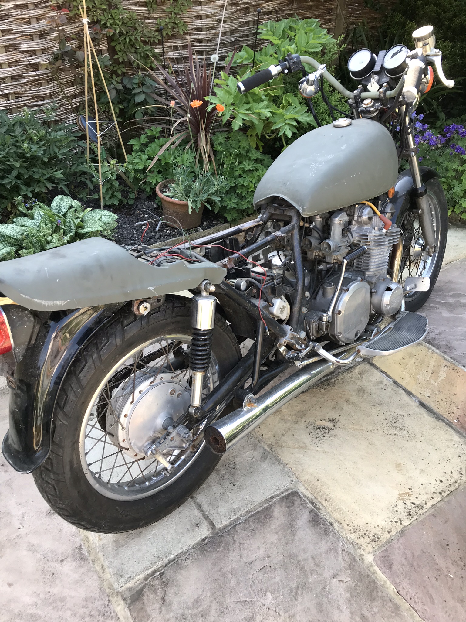

I still haven’t been out on mine yet, the tank is away being sprayed and the small tank I use for setting it up isn’t up to running it on the road. I’m hoping the tank will be back in a couple of weeks.

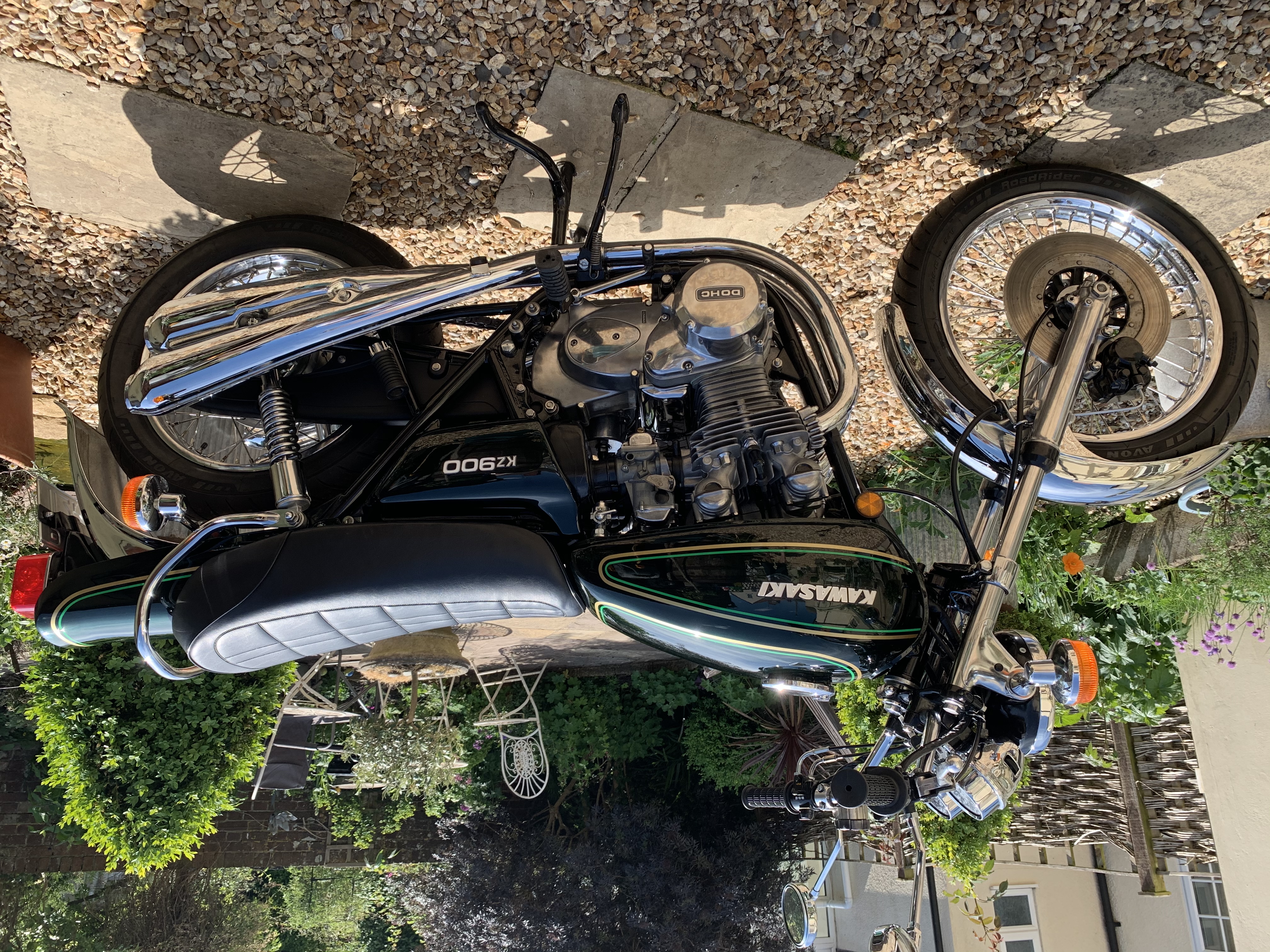

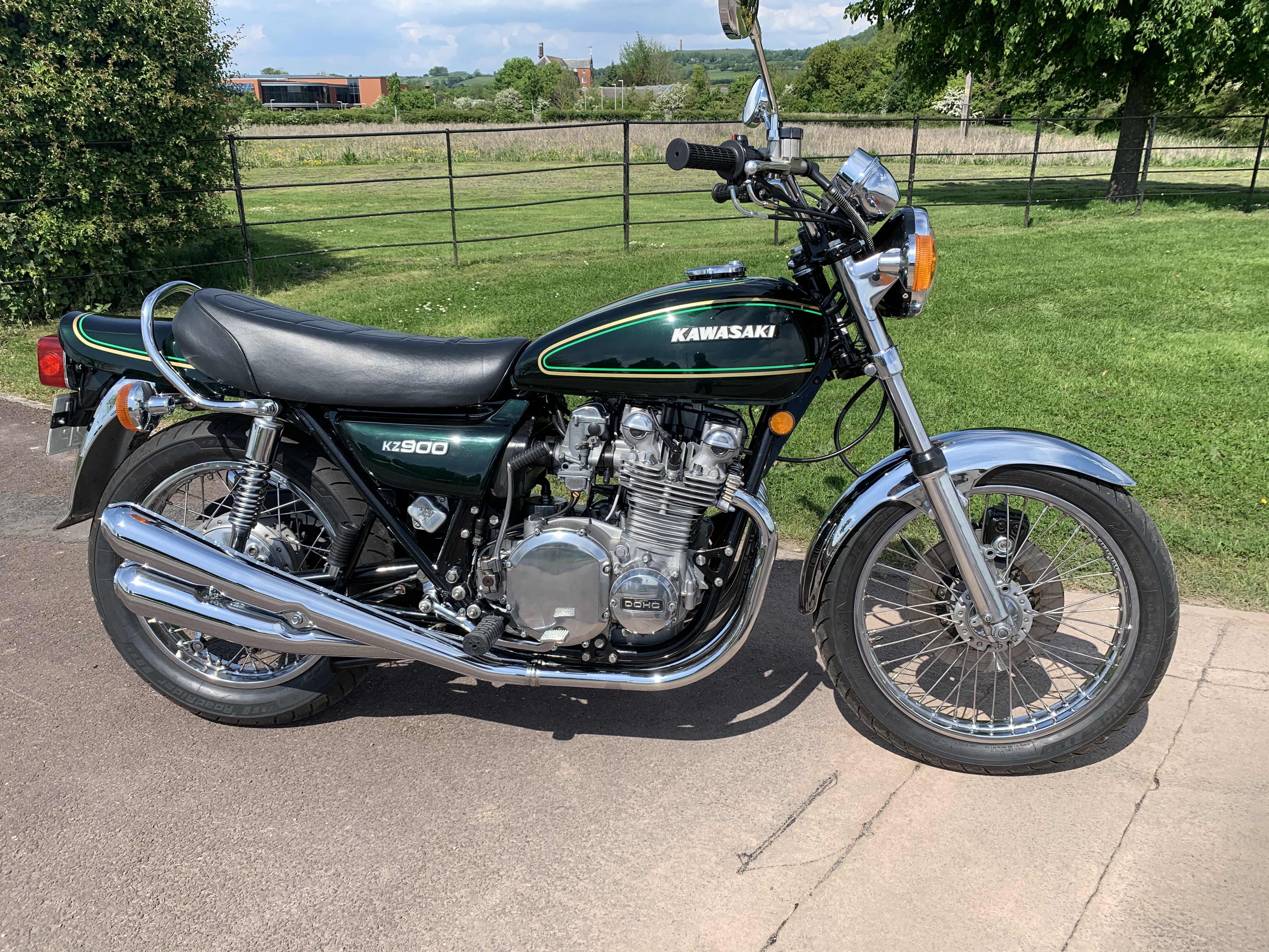

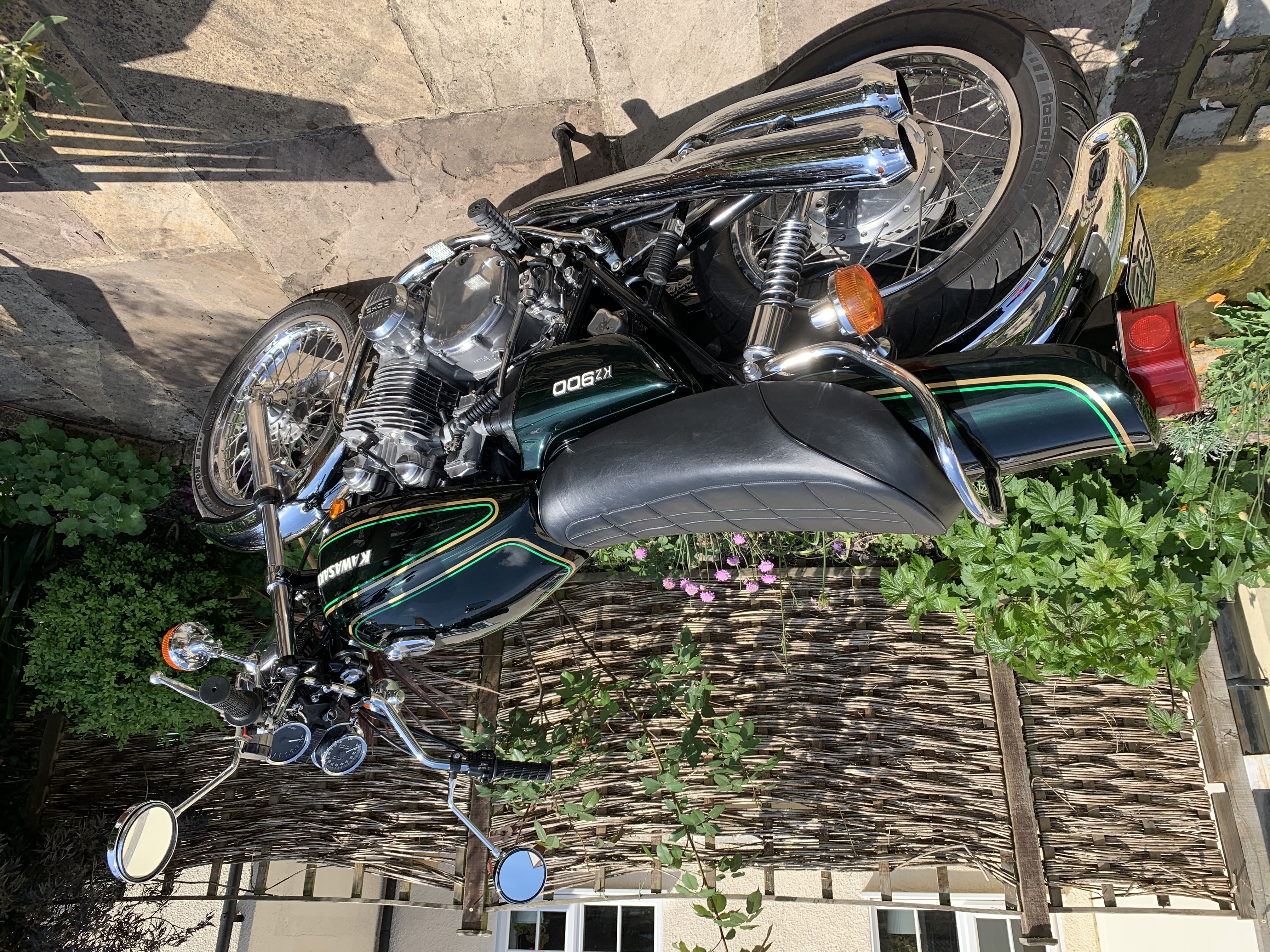

Ok to finish this thread, I’ve fitted Dyna S ignition system while I was waiting for the tank, I got the tank back today and it works, it runs lovely with no bogging at 3k revs. So it looks like I’ve cracked it.
Thanks for all the advice you’ve given me, I don’t think I could have done it otherwise. I think it looks a bit better now :biggrin
