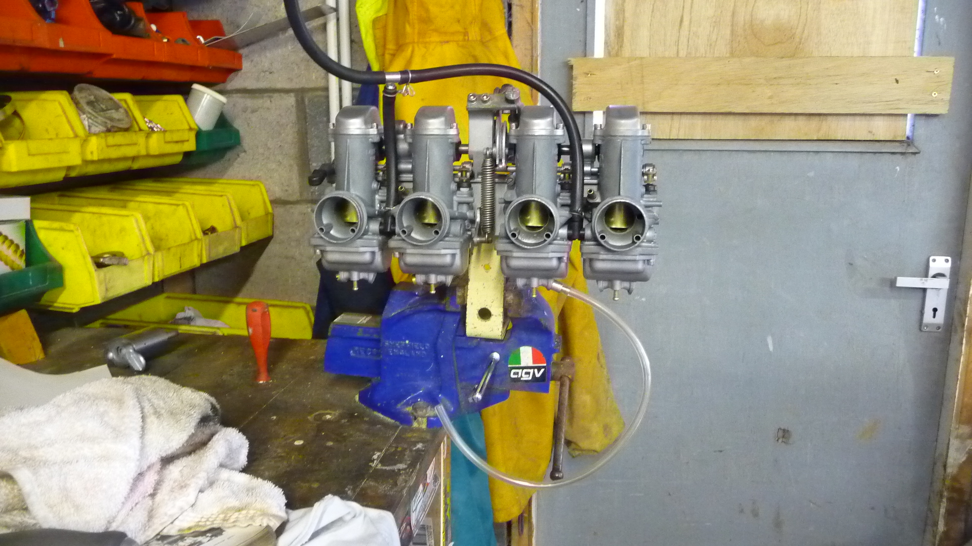

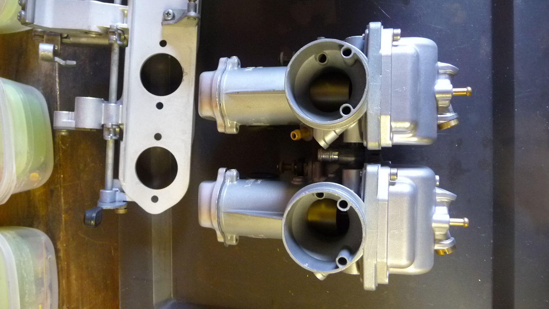

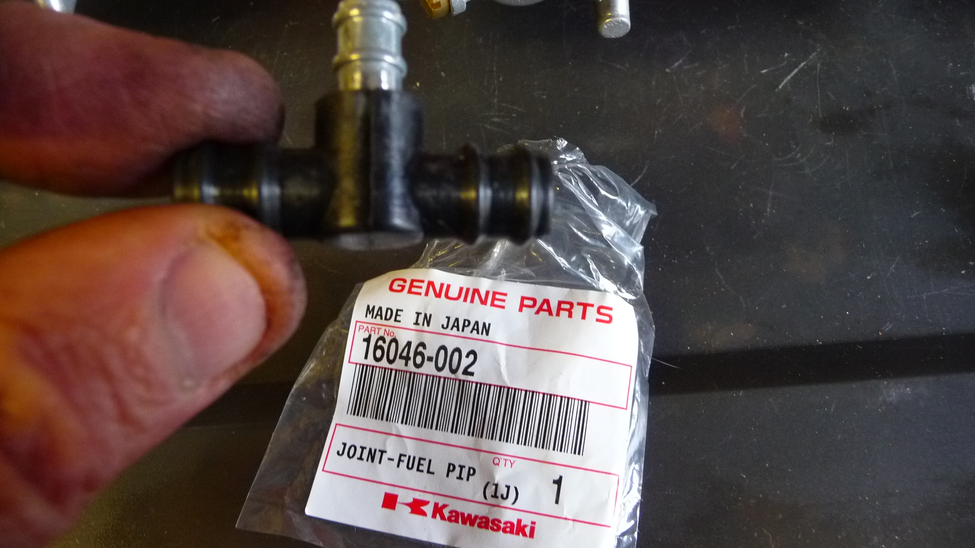

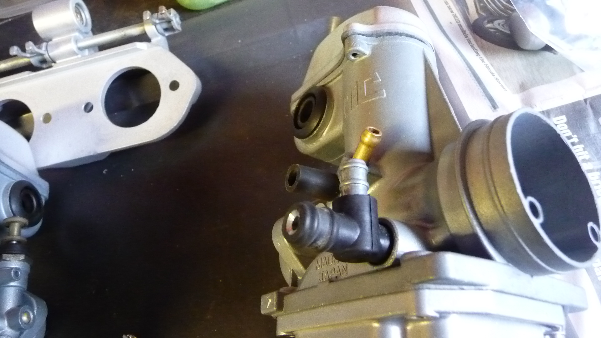

Fully rebuilt for your info to reference tee pieces, float level check tool in place.

Wow your carbs look like brand new, did you have them vapour blasted or ultrasonically cleaned or both? Wish mine looked as good, that said they at least have all new internal conponents so hoping theres a vast improvement in running.

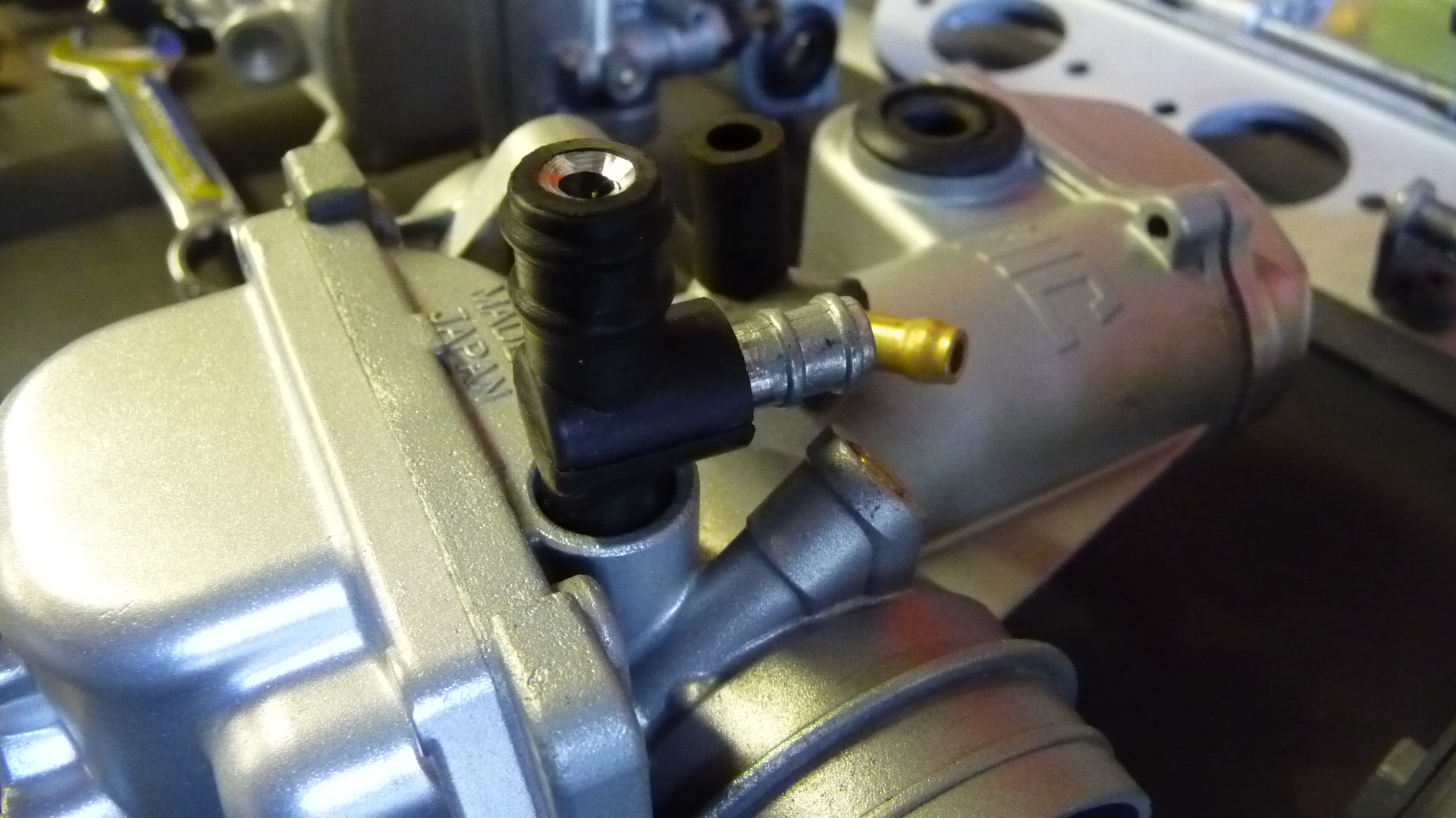

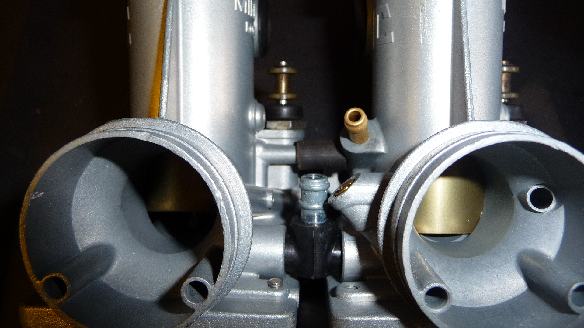

One thing i did notice on your photos the T pieces seem to enter all the way in, both o rings, mine by comparison only the 1st enters the 2nd o ring is on the edge, however they dont seem to leak at all.
What i cant understand is my T pieces are brass, the o rings are set in the grooves and once carbs are fitted to the bracket cant move, so either thats the way they've been made or somethings shrunk which isnt possible, unless their the wrong T pieces for the carbs?

Gray17 wrote:What i cant understand is my T pieces are brass, the o rings are set in the grooves and once carbs are fitted to the bracket cant move, so either thats the way they've been made or somethings shrunk which isnt possible, unless their the wrong T pieces for the carbs?
If they are brass they are non stock aftermarket or home made.
The originals were only ever aluminium with either the bonded rubber sleeves or 'o' rings but if your brass ones don't leak it isn't really a problem.

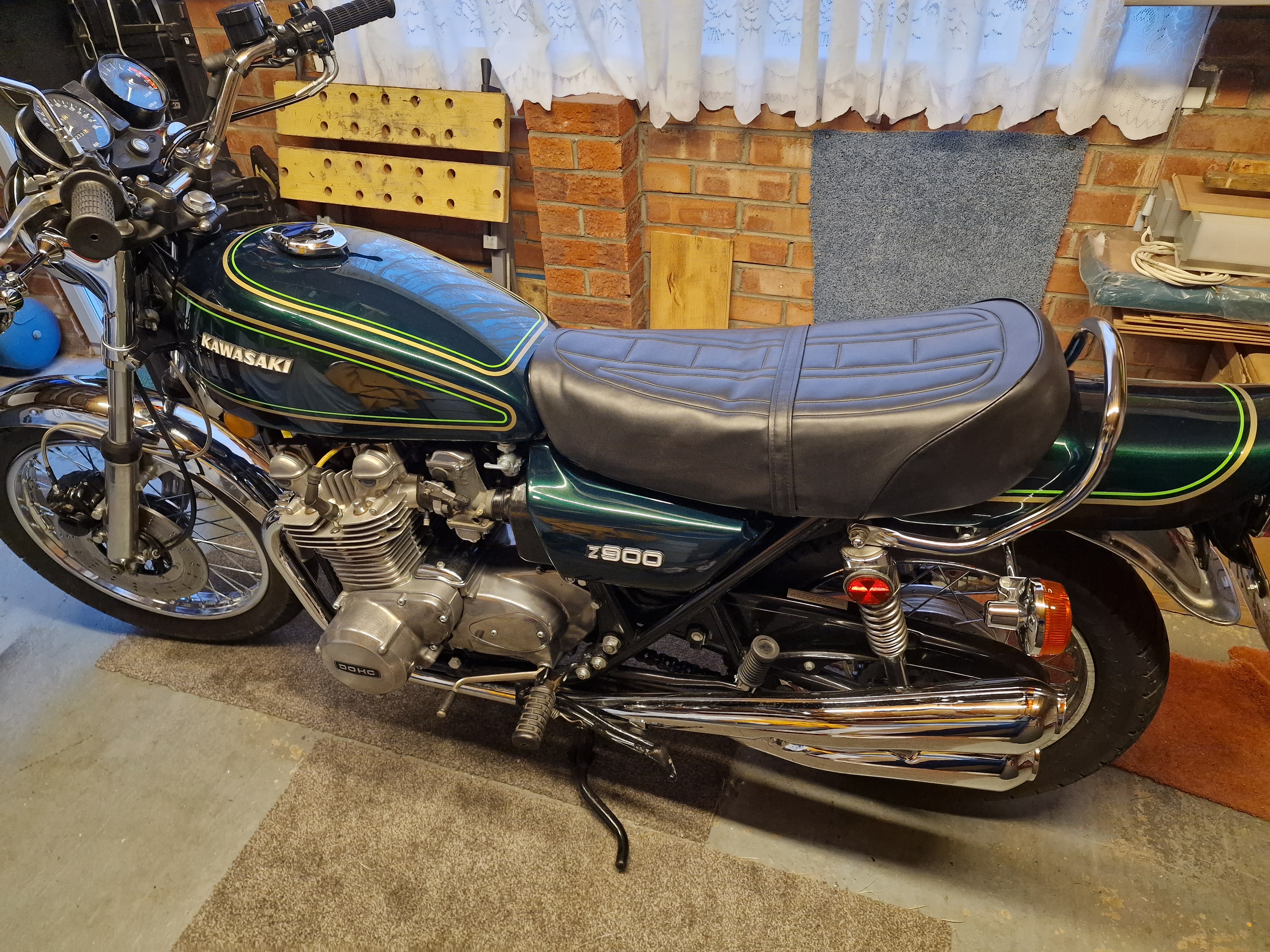

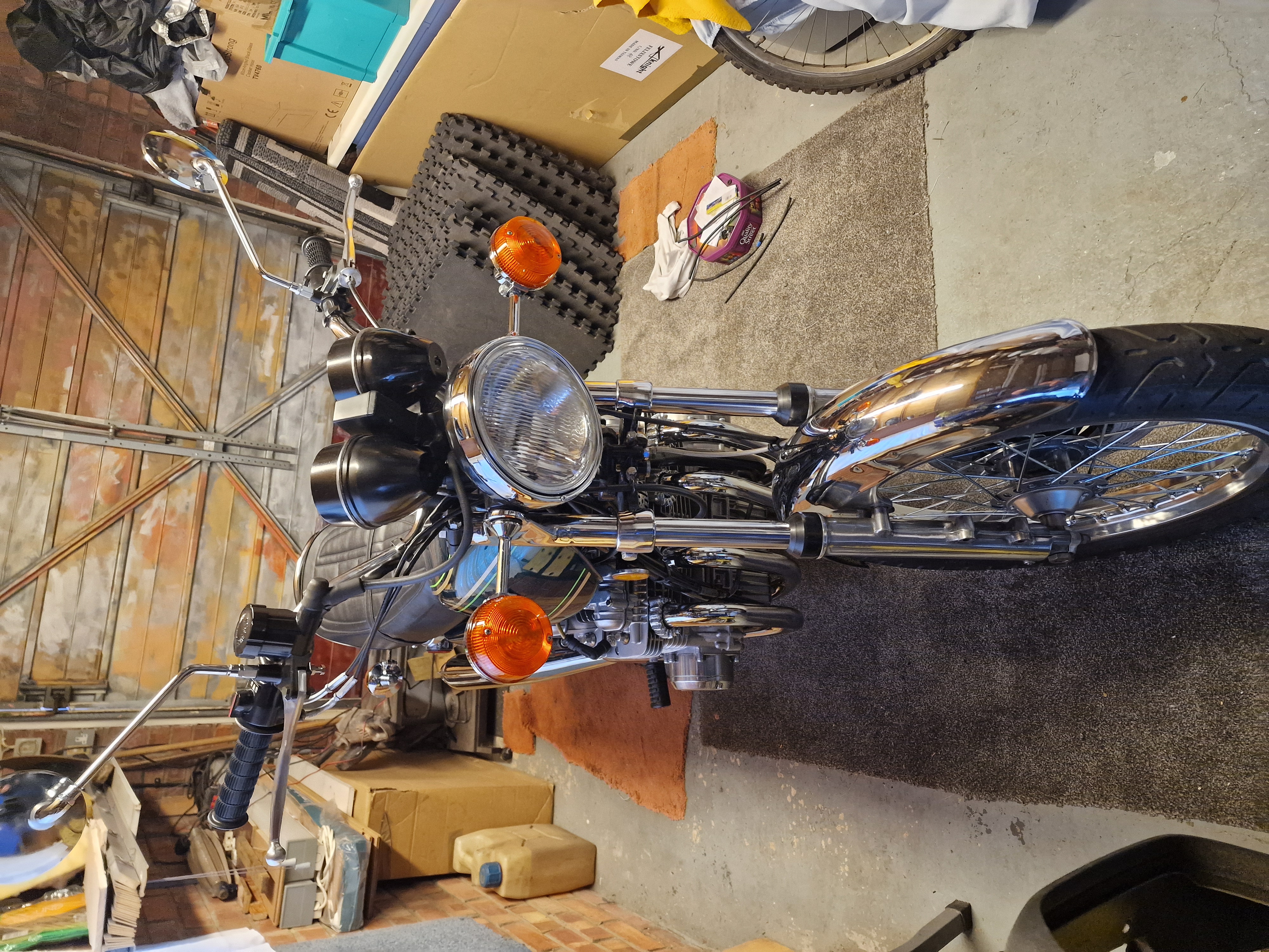

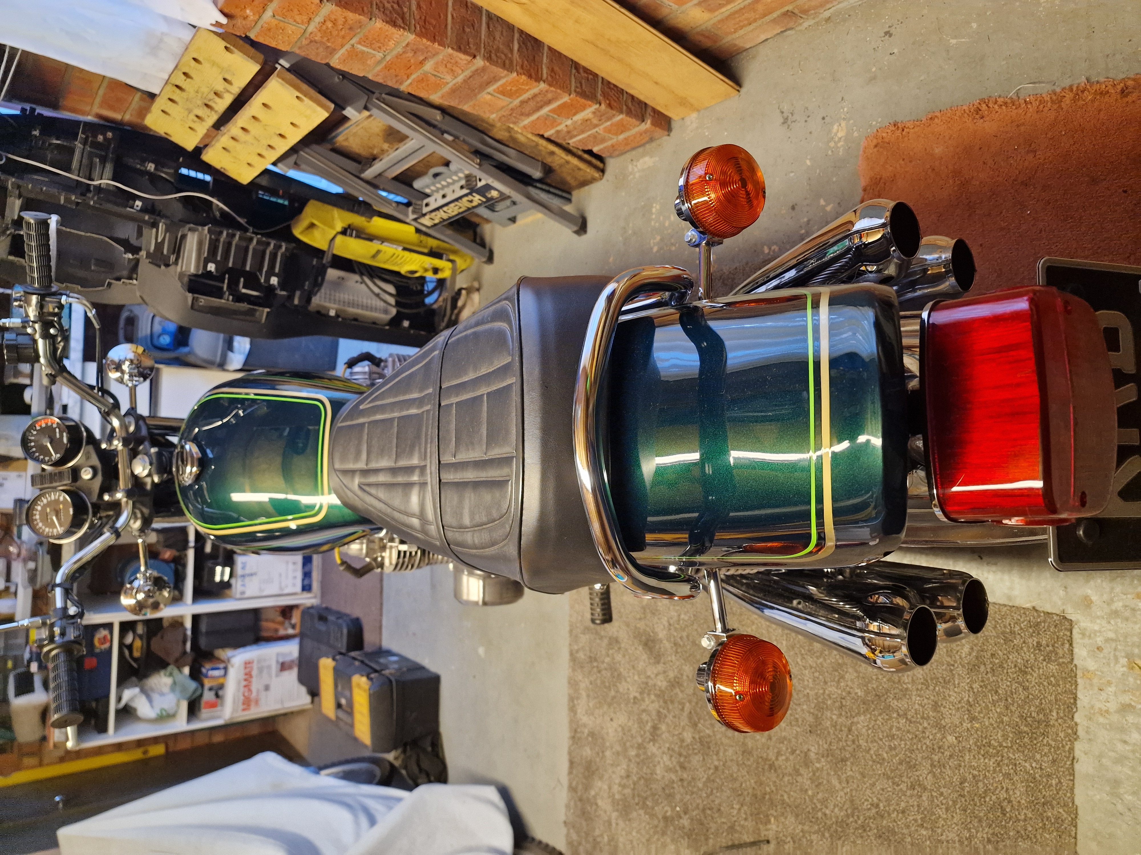

Heres some photos of finished article.

Bike looks great well done
Re: Z900 A4 fuel leak any ideas please?
Bike is looking great , very nice job .

I think the tee pieces you have were aftermarket ones ,seem to remember them for sale somewhere years ago , but as said if they aren’t leaking then they are ok .

The brass tees are aftermarket and they are superior to the OEM ones in terms of performance and longevity. These outsell the OEM one by 10-1 and are a good alternative if you want reliability and don't care that it's not original.
They should push in all the way so both o-rings are inside the body.
