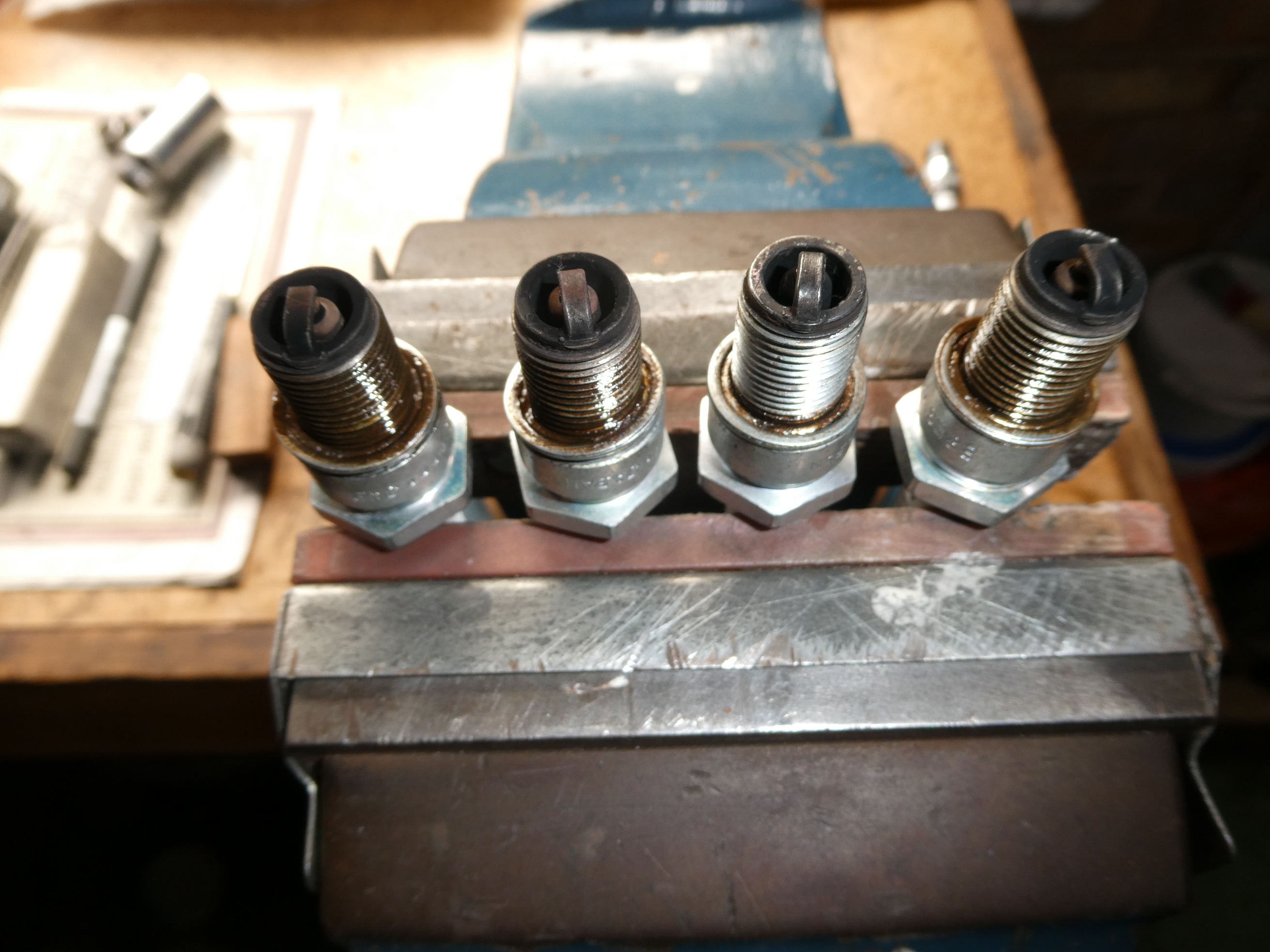

This is the pic you posted in the thread; Black Plugs.
Were they in correct order left 1.......2......3.....4 Right??
You could;............put the B8 back in, weaken the mixture screw on number 3 only, drop the needle by one groove on number 3 only, remove the air filter and take it for a run.
Look at the plugs when you come back and that should help you decide if you have an oil control problem.
What exhaust? four pipes or four into one? If its four pipes is one more oily or sooty than the others at the end? Number 3 perhaps.
What condition are the coils and leads in. Did you swop them over and see what happened?
Have you measured the internal resistance of the coils? Have you measured the total resistance of; plug in cap with lead attached to coil and down to the plug on the other end to see if there is a difference between one coil / lead/ plug setup and the other combination?

Whilst I accept it may be oil fouling my gut feeling is that it is not as a result of oil fouling. There is no smoke on any of the pots and the bike has been on the road since I did the engine some years ago, this a fairly recent problem.
Photo of plugs was before I removed the carbs, cleaned them replaced the seat/valves, had the choke plunges done etc, only No 3 now remains black and sooty.

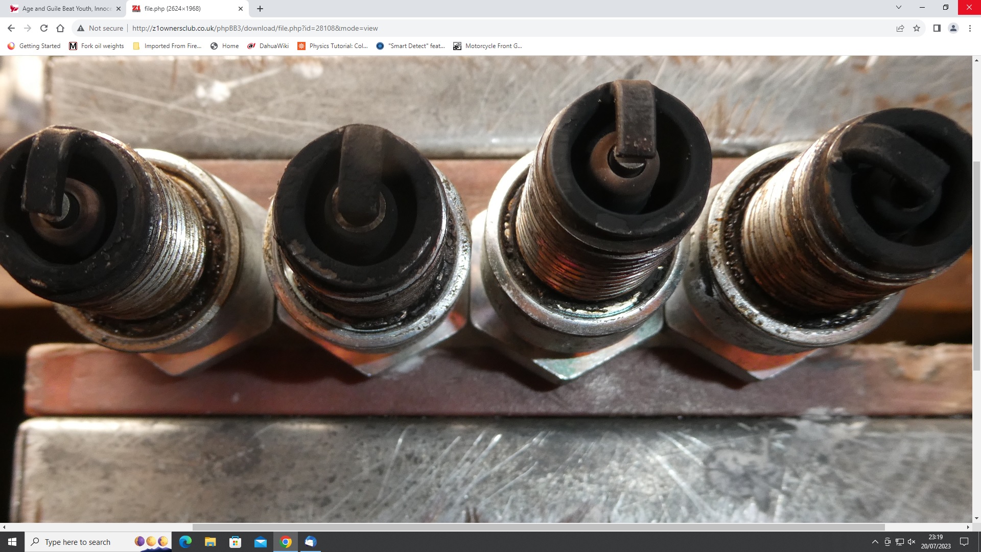

Another photo of the 'now' situation would allow a better assessment of the many changes that have happened since that photo was taken. In the picture; number 3 does not look too bad ~ rich, but on the safe side of correct!

If its oil, you cant remove it from the equation. If its excess fuel you can artificially weaken the entire landscape by removing the air filter temporarily. If its oil it will still show up that way. If its excess fuel it will all go weak. If its both, you will get something entirely different looking!
If you can do another picture; try to resist the temptation to rub the soot / oil with a finger to see what it is. There are some critical indicators for heat range, mixture and ignition timing which rely on being able to see where the deposits are and where they stop / taper out!

Last photo, No1 on left to No 4 on right. Unfortunately I have wiped most of the carbon off No 3. The others have what I consider OK brown centers with the usual black threaded outer circumference as bike was on tick over for a while.

Good effort but no cigar :D Really need to see all four and not on tickover, sorry but i am determined to win the £500 for finding the answer.

It does look superficially as though the number three is richer than the others but well within the range of adjustment provided,... for a set of 40+ years old, worn carbs.
