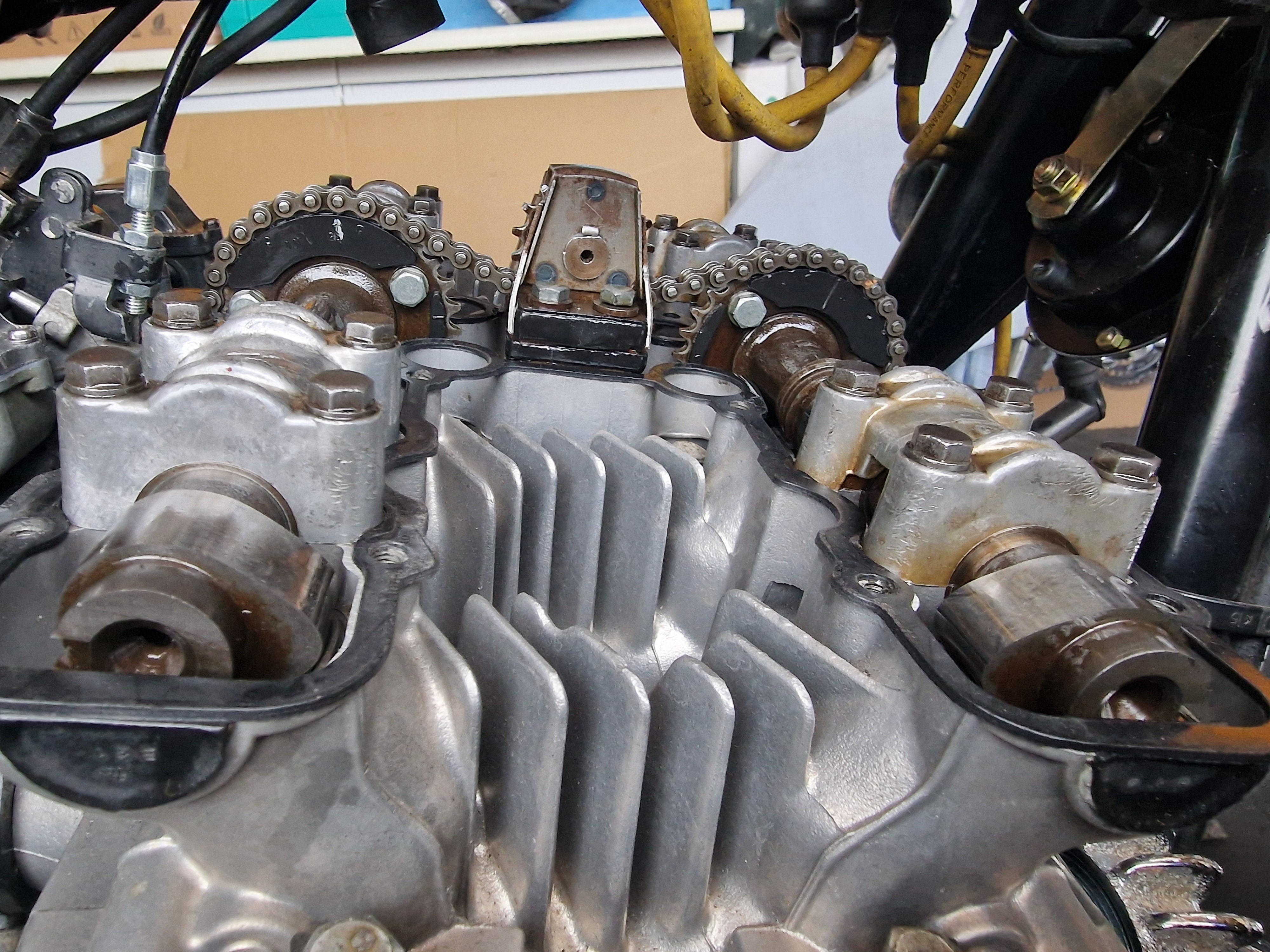

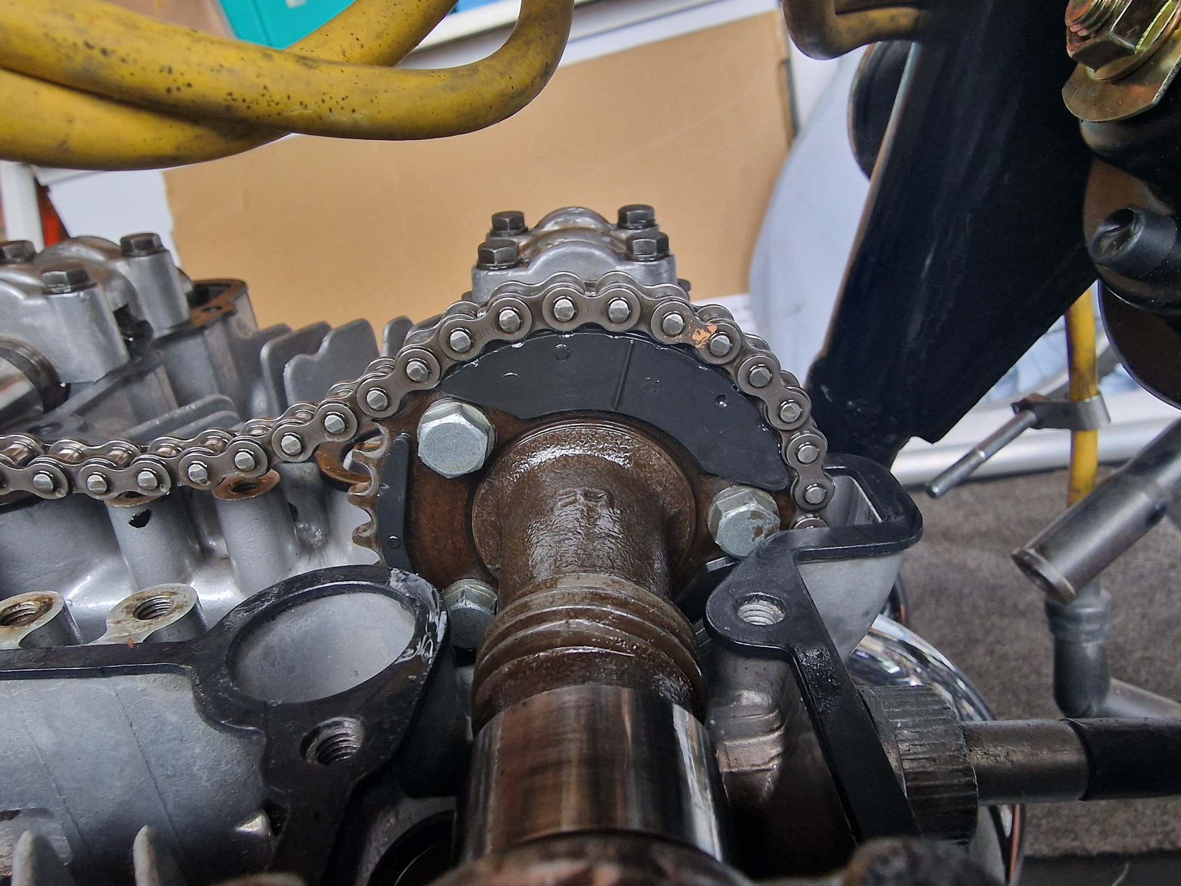

Update : First of all decided to re check cam timing as reasoned if this a tooth out then no matter how much i fettle itt will never be right, so off with cam cover (not easy in frame, why on earth not 5mm more clearence?) Set pistons 1 and 4 at TDC and alligned T mark (see photo) checked position of exhaust camshaft, then counted 29 from Mark (yes i know it says 28 but after reading loads of posts it starts at 0) so by my reckoning looks ok. Whats your thoughts?
I found a post stating look at cutouts in camshaft that they should be level with head mine are (see photo)
Before moving on will await replies.

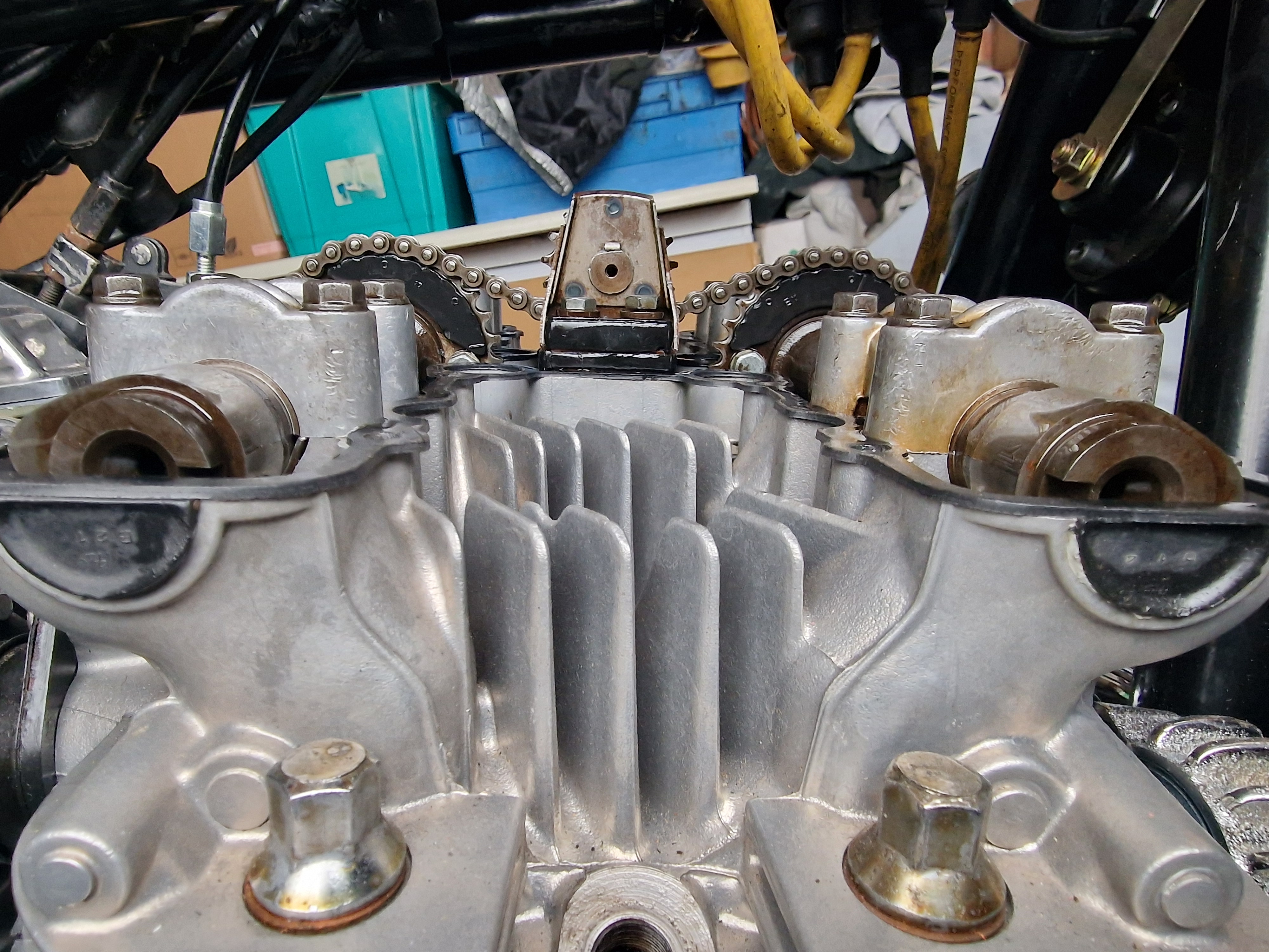

Ok sorry if youve seen previous photo realised engine 180 out returned to correct position its exactly as the workshop diagram you can even see the white 28 mark now on the inlet cam cog however whilst im pretty sure exhaust is correct by the single chrome screw on cam if anything its a little low, which reading a prev post think thats ok yes?, rather then 1 tooth back it would be above the head level. If someone could confirm ill continue on my elimination.
As both gauges and timing light have arrived which will be next steps.
Photo of new cam position.

#93 PostAuthor: Ultim8pc » Wed Apr 17, 2024 4:25 pm

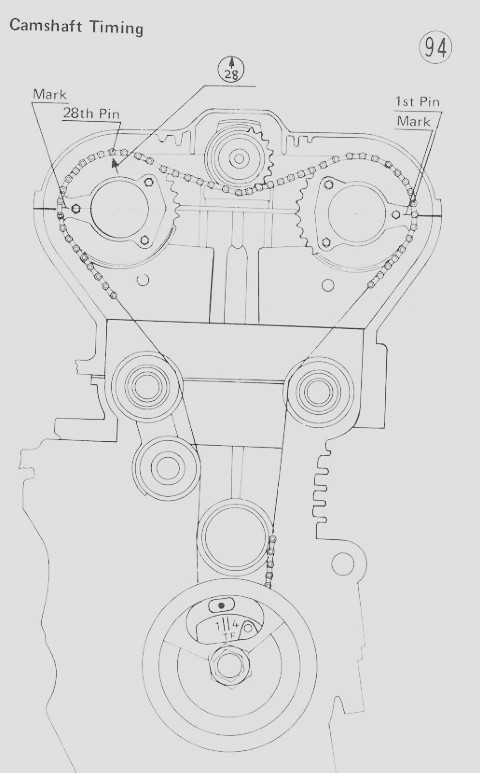

See the image from the workshop manual.
You may find that when the exhaust arrow is lined up with the head, the inlet one may be slightly pointing down due to cam chain wear.
If you are a tooth under (27) then the inlet cam arrow would be one tooth up.
The only way to be sure is to remove the top roller and count the number of links.
Hope this makes sense.

#94 PostAuthor: warren3200gt » Wed Apr 17, 2024 4:48 pm
Can't see the position of the exhaust cam mark as its hidden behind the cam cap on your picture.

#95 PostAuthor: r3sc » Wed Apr 17, 2024 7:00 pm

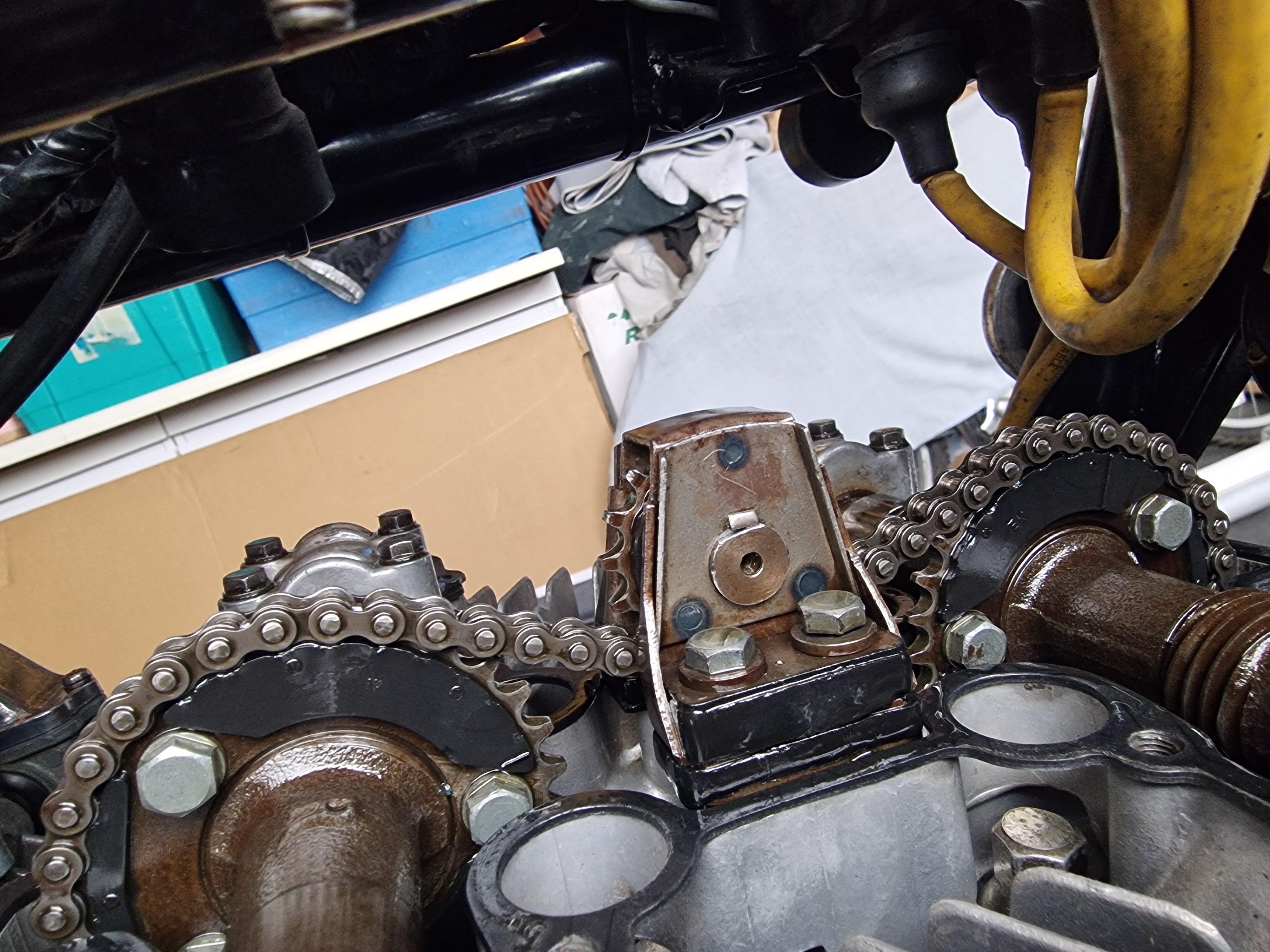

I’m not convinced. The position of the visible cam sprocket bolt on the exhaust cam looks out of position to me and lacks symmetry with its opposing bolt head on the inlet cam. A careful re count and re check is definitely the way forward.
Looking forward to hearing the pin count.

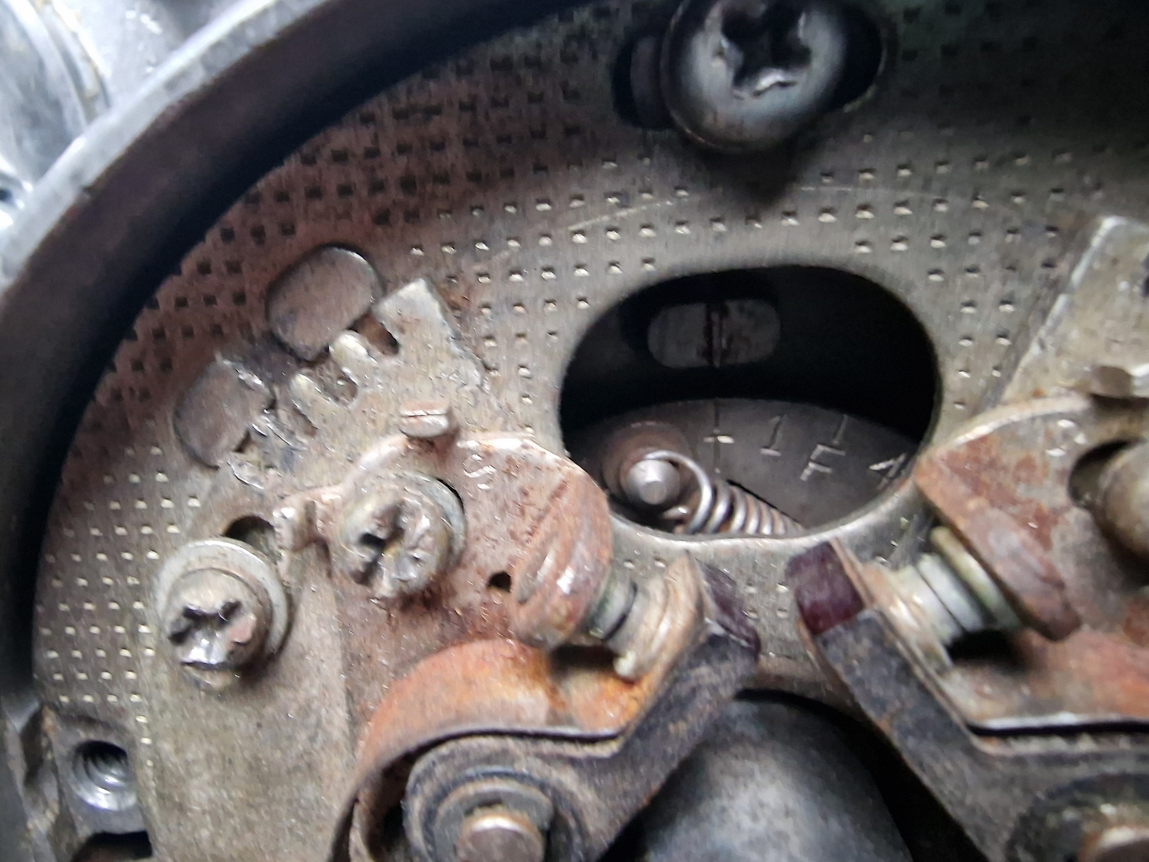

I think I would also strip out the points and either replace them or strip them down to clean and check them along with lubrication of the moving point pivot shafts.
If the points are so corroded the moving point arms could be sluggish.
I’d check them for sure.

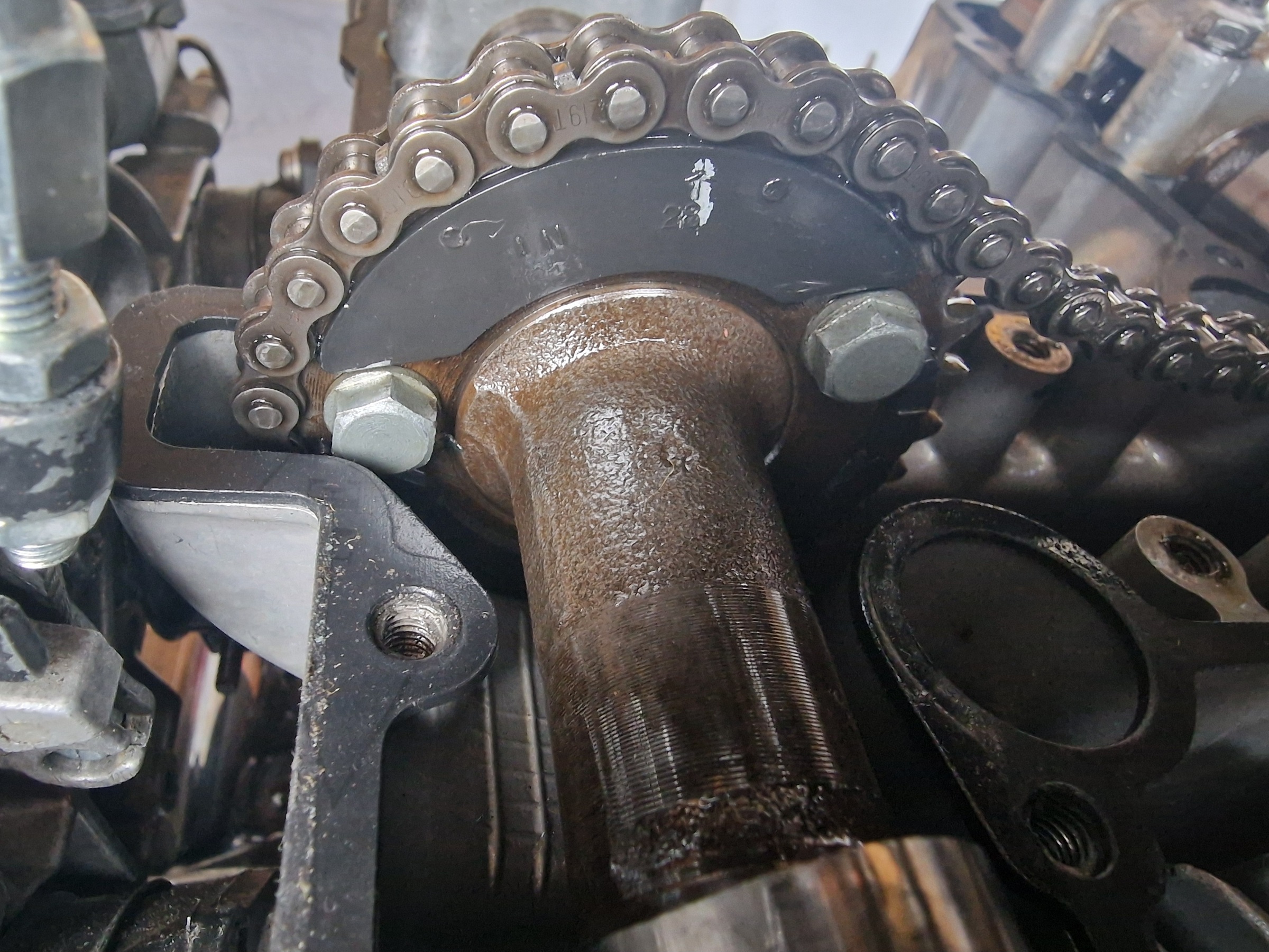

Ok thanks for replies Guys, i will re check exhaust cam tomorrow and take photo of its position, trying not to get the cam bucket in. Was trying to use 1 photo for both but maybe better close up of each cam separately. Im pretty sure they are directly opposite each other but will re confirm.
As for points yes did notice that myself, it was over a year ago when i originally stripped it, and had a move in between, although it was wrapped in a blanket and then a nylon over cover its possible damp has found its way in. Will strip down and clean and lubricate, if in.poor condition will replace them.

#99 PostAuthor: zed9 » Wed Apr 17, 2024 9:52 pm
The inlet bottom cam shell seems to have been bent slightly as its pointing outward a bit where the shells meet by cam cap, have to zoom in to see it.
More importantly the top idler mount bolt on the right is loose and not tightened down!!, you dont want this coming loose.
For the points you can rub some 600 grade wet/dry (use dry) folded over so both points are sanded a little which can take any high spots you get on the contacts from arching then set the gap. Next do timing with strobe.

#100 PostAuthor: sean_rfi » Thu Apr 18, 2024 8:18 am
I'm not sure if its some form of optical illusion but, as Zed9 says the lower inlet cam shell appears distorted or not supported (can be seen in the first/top photo).
It almost looks as tough some of the casting is missing?

#101 PostAuthor: warren3200gt » Thu Apr 18, 2024 8:36 am
sean_rfi wrote:I'm not sure if its some form of optical illusion but, as Zed9 says the lower inlet cam shell appears distorted or not supported (can be seen in the first/top photo).
??? Gasket obscuring the cap foot?

#102 PostAuthor: warren3200gt » Thu Apr 18, 2024 8:43 am
It looks to me like you've counted the first pin as the the one the mark is pointing to. It should be the one above the mark. This would rotate the inlet cam anticlockwise by one tooth which would make the sprocket bolts on the inlet cam a mirror image of the exhaust cam as they should be.
And as previously advised the rh idler sprocket bolt looks loose.

#103 PostAuthor: zed1015 » Thu Apr 18, 2024 8:46 am
That's the shell location tab which prevents it from spinning in the journal.
The "missing" casting is the machined recess for the tab.

#105 PostAuthor: Gray17 » Thu Apr 18, 2024 9:23 am
Thanks for reply Guys and good info, got plenty to go at today.
Firstly Zed9/Sean you are correct about both cam cap and loose idler bolts this is as i had removed it to accurately count the chain links and havn't fully re tightened as may need to come off again, needless to say it will be correctly torqued down before cover goes back on.
As Zed 1015 says the cut out is a machined part of the cam cap, so assume should be there, there def isnt any damage to it that i can see.
I will re check the inlet camshaft position and re count the links in case its 1 out, how much does this 1 tooth effect performance? When i took it for its 1st run it was sluggish at low revs but once over 2.5k i thought it pulled quite strongly, of course i've nothing to go on as never had one before. If i compare it to a modern injected bike its def not as powerful but then its only got 83bhp as opposed to my Blackbird with 160 so no comparison really.
Points will be removed cleaned and re gapped and all parts lubricated.

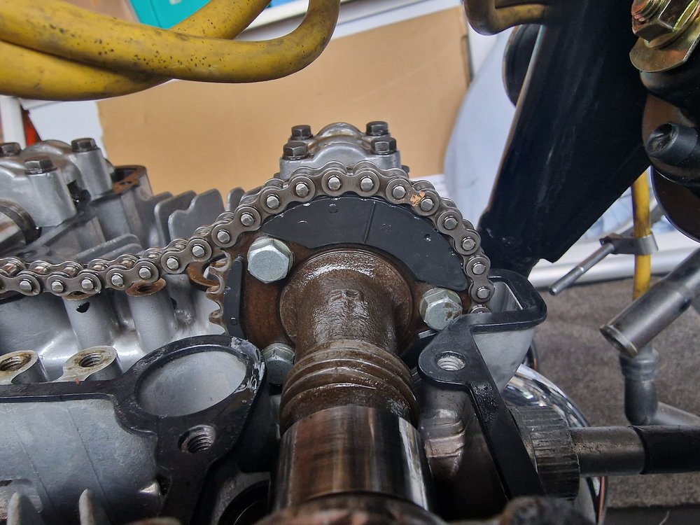

Close up photos of cams
Note top guide roller removed so can count links, also there is a faint mark on back side of exhaust cam this is about 1mm below cam cover gasket face, i then counted 28 links from link above that mark and it is on the white mark on inlet, in both cases the notches on the cams themselves centres (ie same amount showing on both above and below surface) are level with head face ex facing forward and in facing backwards, the long part of cam cog y piece bolt is about 1mm above face on exhaust the T mark is spot on.
Update lifted cam chain off cog could faintly see an arrow etched into cog dead centre of chrome bolt hole, marked it with a white marker, re fitted chain again keeping it taut, set it to T mark then checked alinement of white mark with head face ( yes did lift gasket 1st) it was about 1mm below face. Next counted 28 from link above white mark, this was spot on with mark on inlet cam. Re fitted top idler wheel temp then Rotated engine 360 re checked still spot on.
Spoke to Warren who confirmed it seemed ok, so pretty sure that is now as it should be. No adjustment was needed so it was ok when originally set, but better safe then sorry!
