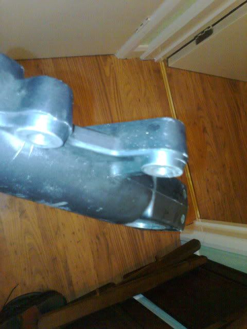

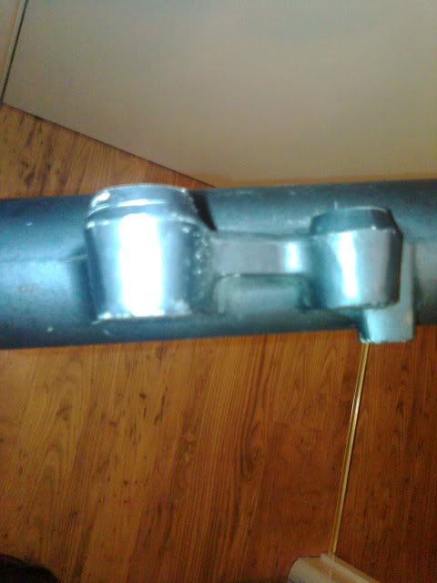

Here's some photo's of the lugs......
I want to take 4mm off the left lug (as viewed in the above photo) - it's the bottom lug of on the leg, you can see the scratched mark in the upper bit of the lug which is 27mm thick - and will make an adaptor plate for the other mounting point.

#10 PostAuthor: zed1015 » Wed Feb 22, 2012 8:25 pm
Won't do any harm taking 4mm off that protrusion as it isn't cutting into the main structure.
It's a straight forward job.
You could do that easily on the pillar drill with a piloted counterbore.
