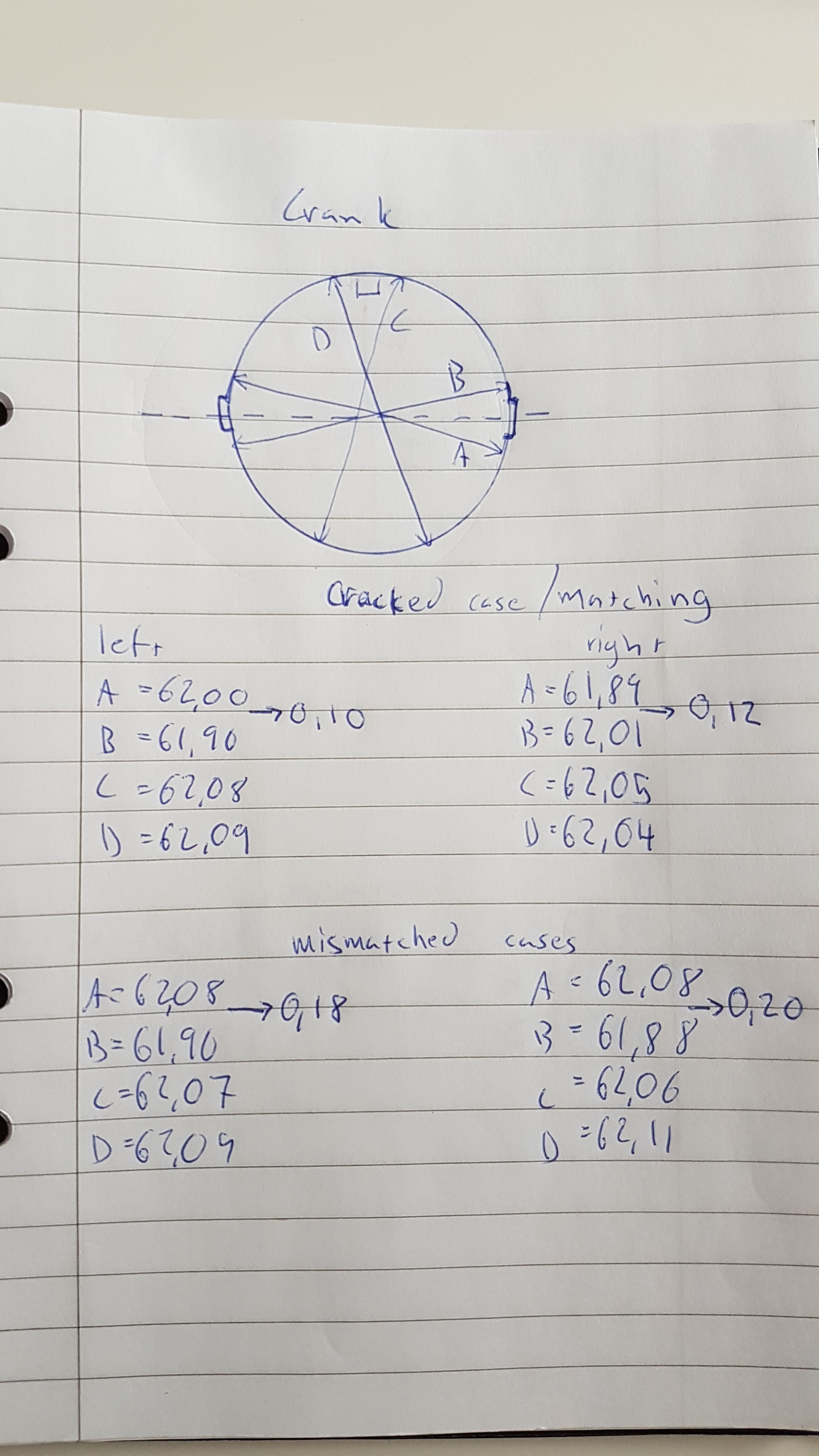

Finally got the last measurements.
The mismatched cas has a bit larger offset compared to the matching case.
Left crank side: 0,18mm vs 0,10mm left
Right crank side: 0,20mm vs 0,12mm
Please see scetch below to see how I measured. A vs B above

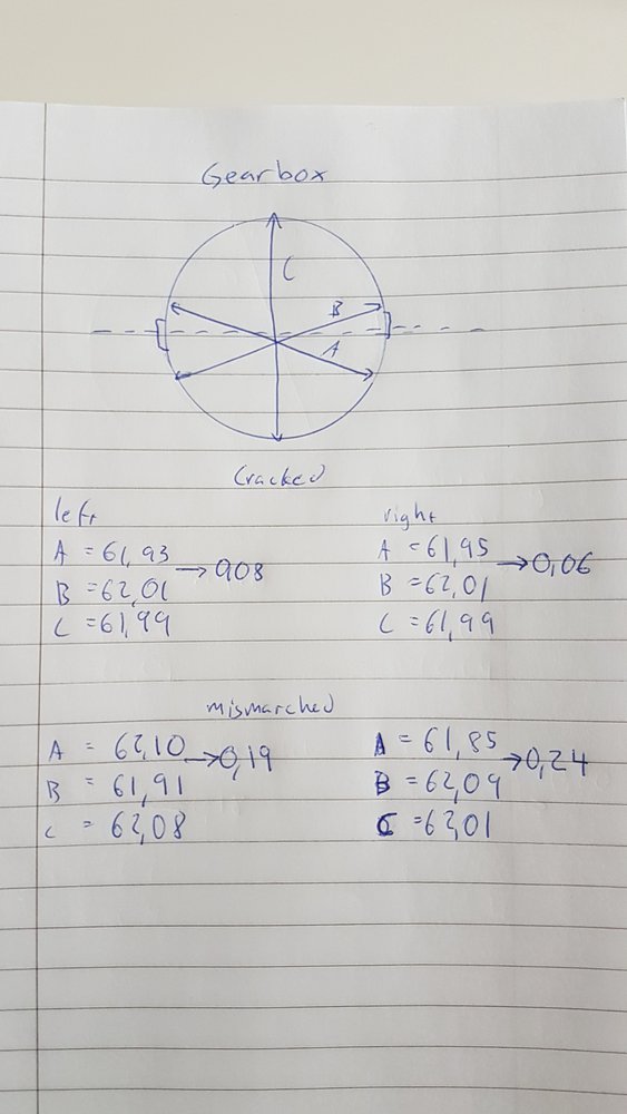

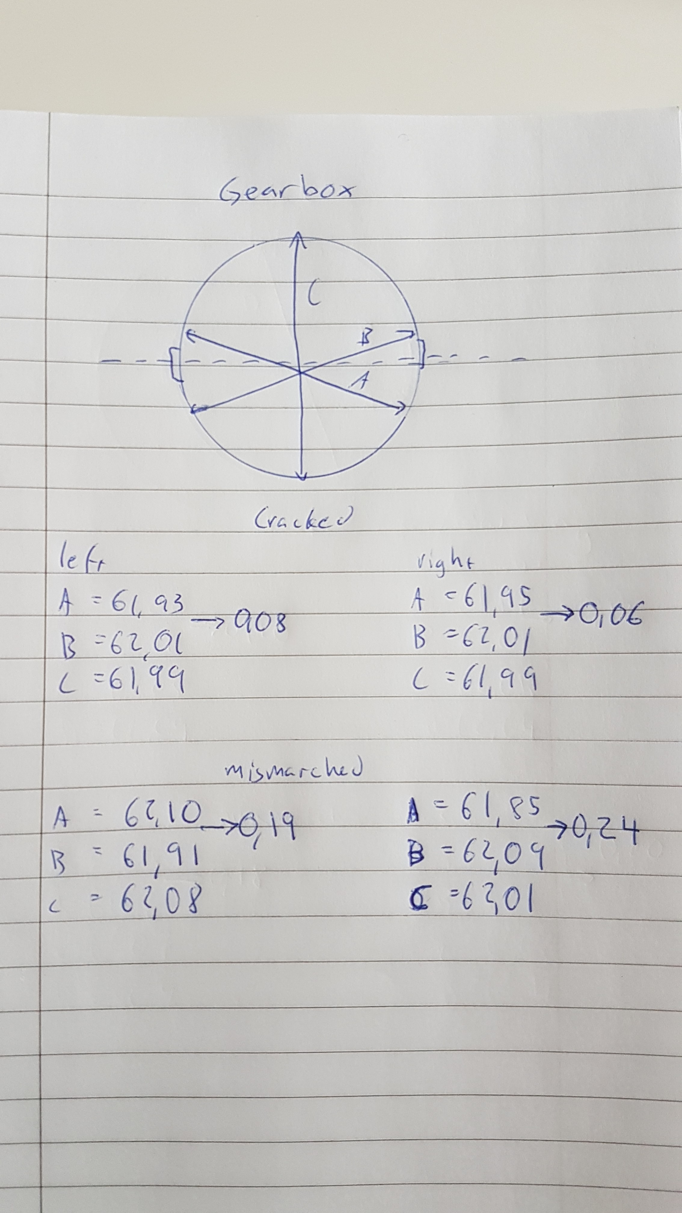

And the result for the gearbox. Simular to above.
Does the mismatched case pass?
Should I use the center crank clamp from the mismatch case? So the forces from the cases on the crank will be in line?

Re: Matching upper and lower crank cases
Looks like you are good to go.
Use the centre cap that matches the upper case.
As you can see even the matched cases are not perfect , height wise (D / C) they are very close and not tight which would be the main issue,the run out measurements in other axes are comparable to the mismatched ones.
I would dry assemble with the crank and gearbox and bolt it all up as a final check and ensure that the outer gasket faces are reasonably aligned.
Again check this by bolting on the outer cases, clutch cover etc without gaskets to see how they sit.

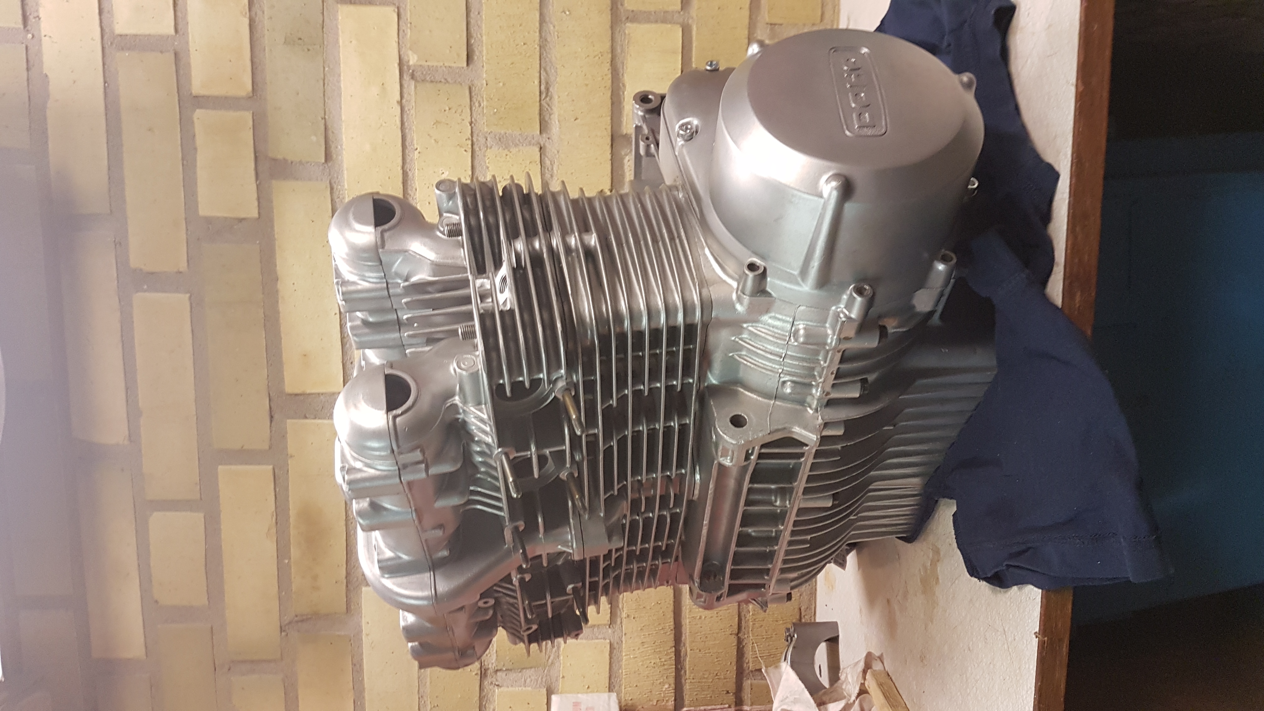

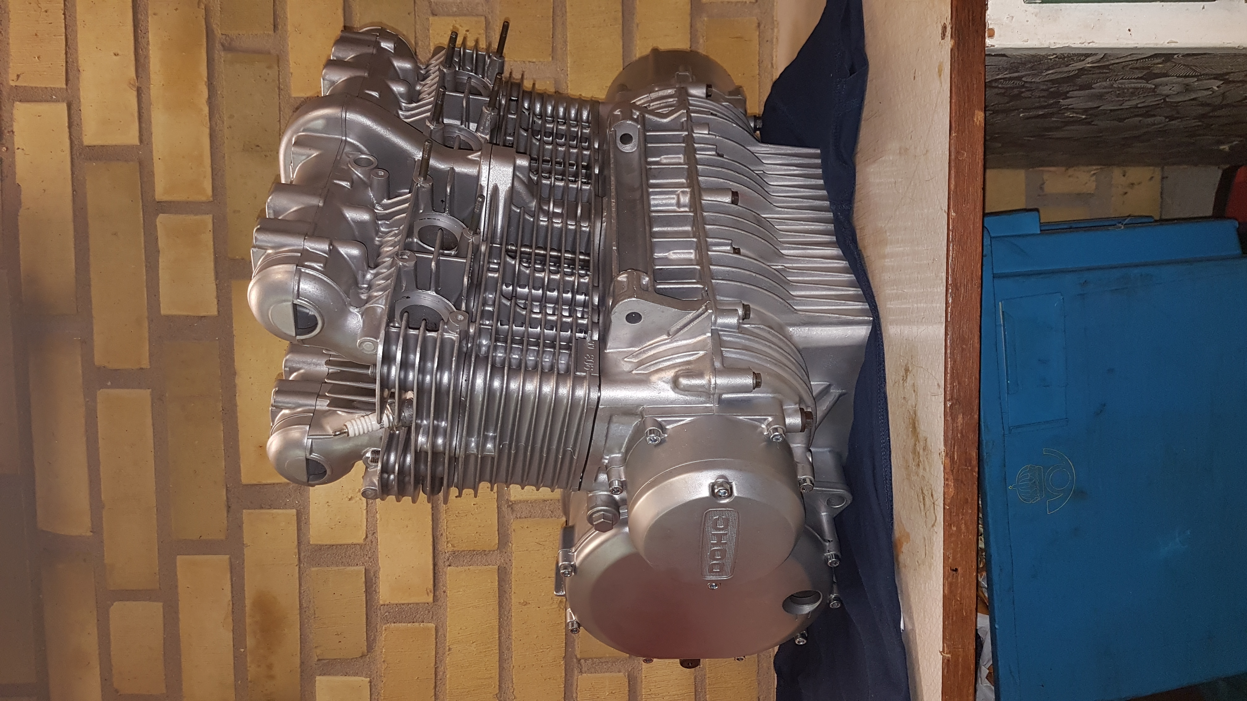

Late night in the garage yesterday and everything is now dry asseblmed. It all goes toghether really smooth! Everything from how the crank lies in its position to how the case covers sits tight over both cases. Looking really good.
As a test I let a powerfull led flashlight be in the case and let the rest of the garage be dark to see if any lights would be seen where there should be no light. Not a light leakage to be seen.
I'll take this as the final Good to go on using the "mismatched" case. Not mismatched any longer...
And having the engine almost mounted I couldn't resist to put on cylinder, head and cover to see how it looks. Pretty good in my somewhat biosed opinon...
Thanks for all the useful help!
