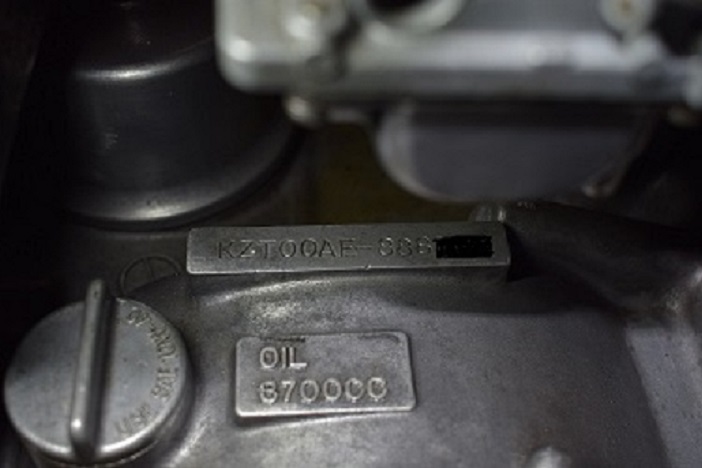

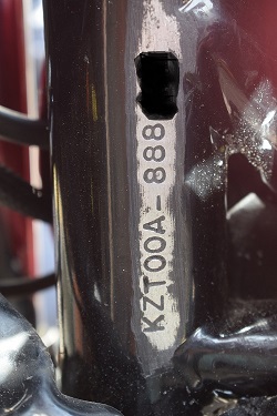

i would like to see some pictures of the frame & engine no's

#7 PostAuthor: warren3200gt » Tue Mar 21, 2017 6:24 am

#8 PostAuthor: chrisNI » Tue Mar 21, 2017 8:29 am
That's weird... :oh stamping looks genuine though.

the frame number is not an a2 the frame numbers do not go that high the engine number is z1000mk2 & models after that . the frame numbers look too thick & suspicious to me maybe its had a frame change in the past & they have stamped the engine number on the frame

#10 PostAuthor: zed1015 » Tue Mar 21, 2017 12:10 pm
Both been re-stamped.
Font is generic machine number/letter stamps and number pad on engine is later long type which should have a raised border .
Only early cases with short number pad had no border.
This always gets lost when original numbers are removed.

I did notice the engine number pad didn't have a raised border but wasn't aware that all later models had it, so you live and learn. It's a shame cos it looks to be a nice bike but now definitley not worth what he wants for it.

kztooae...engine number denotes mk2 (square cam cover)so either z1000e mk2 or possibly 1979 ltd like I have.frame number for ltd models are kzt00b so I'd say tread carefully...

Surely MKII engines start with 08xxxx. I've never seen any Z frame or engine number start with an 8 and I'd like to see the info that the VJMC verified it from. :??

The seller was reticent about giving me the pics below and took some cajoling. After posting on here and talking to Martin (PR Manager at K Europe) its been confirmed that it's either been nicked and re stamped, or written off and re stamped. I can't think of any other valid reason to do it? so I've walked away from it. Either way those numbers are not genuine.
