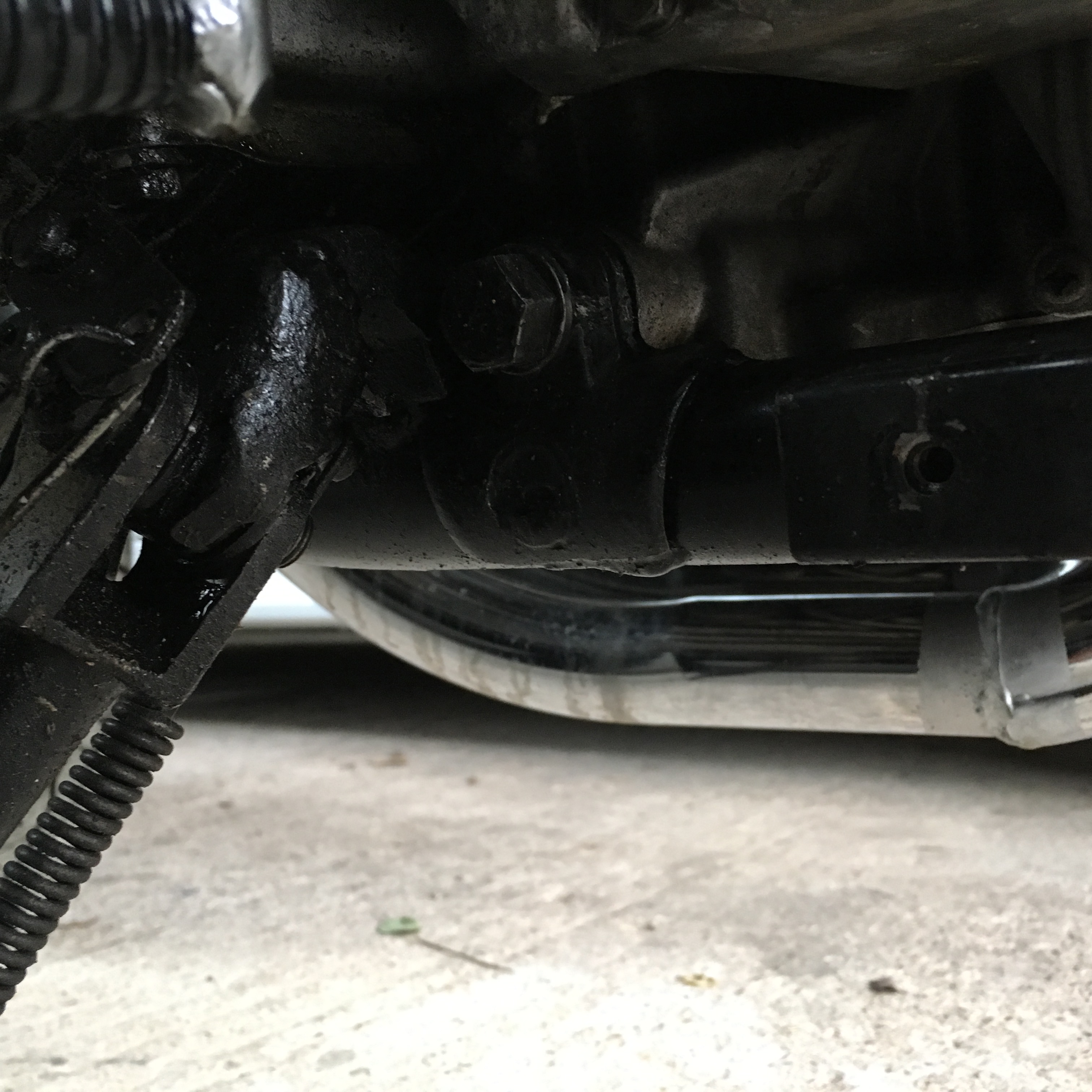

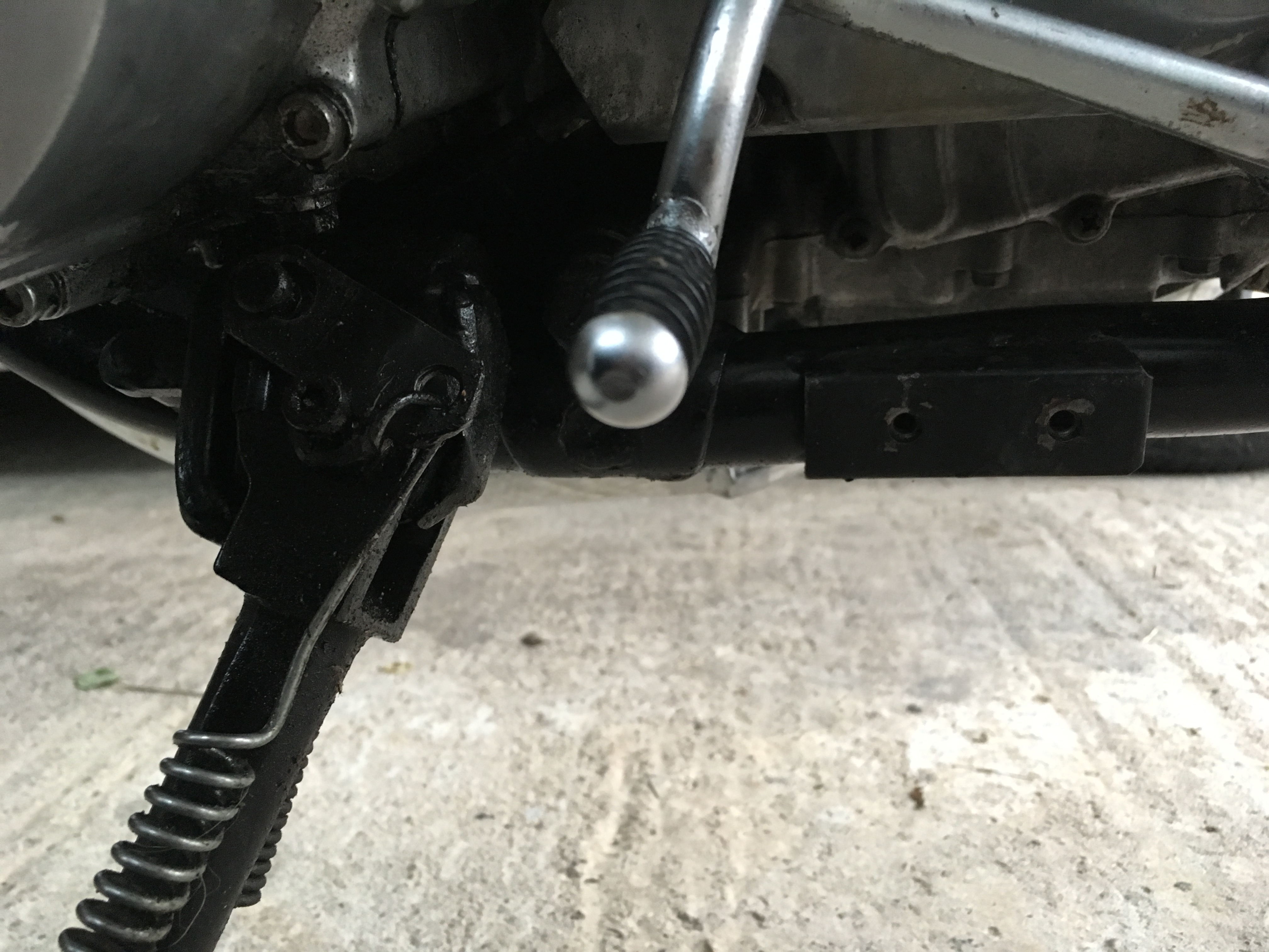

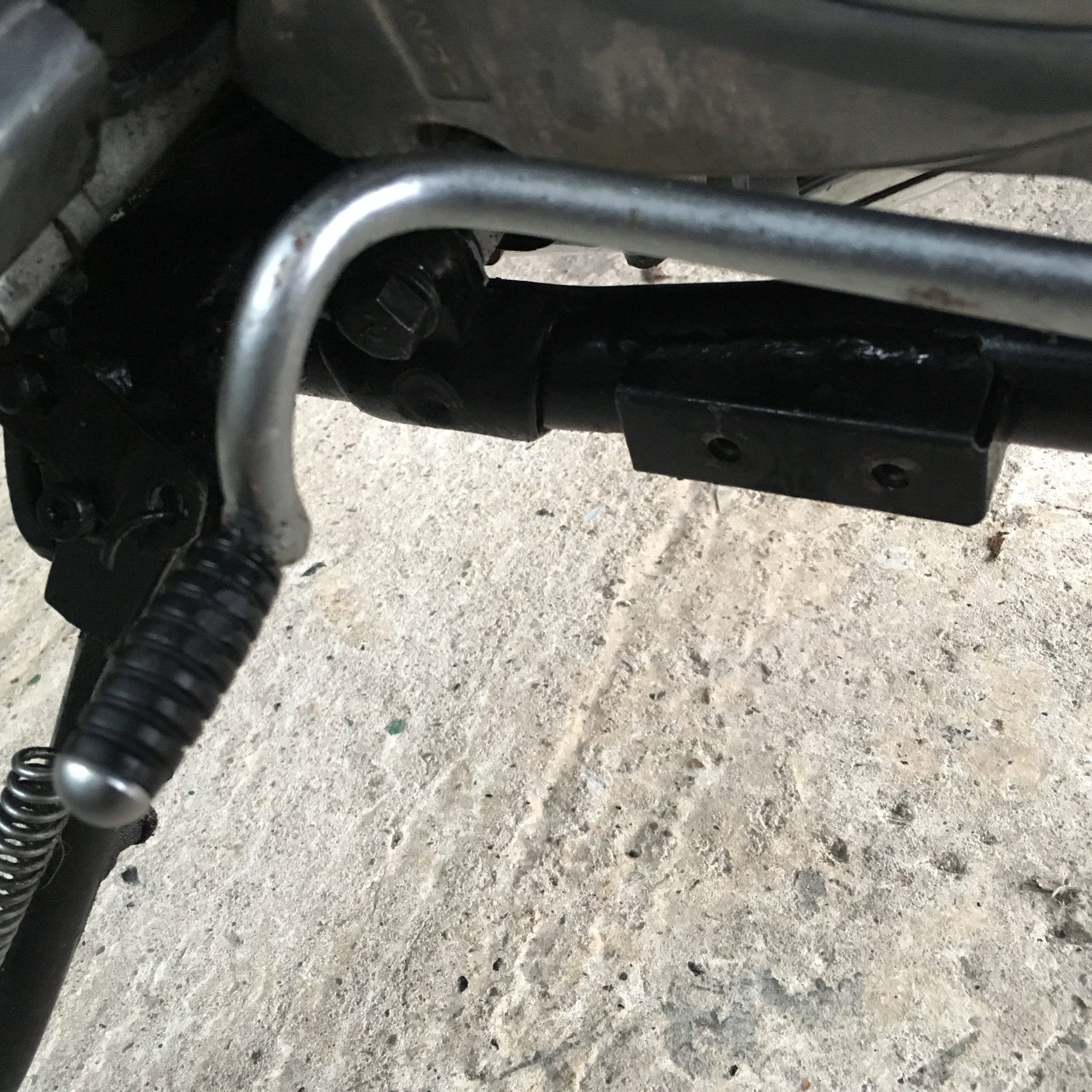

Can anyone advise please ?
Z1000a1 German import, Frame No KZT00A014052
Has anyone come across anything like this, the sidestand is on a welded bracket further forward than usual and there is a welded bracket with 2 tapped holes where the sidestand bracket usually is ??
(try to ignore the funky gear lever !!) :lol:
Any help / advise much appreciated,,
Steve

Has the side stand been moved to allow an airshifter
to be used?

P.S....that's not a standard A1 side stand
07962421462
Posts: 4690
Re: Z1000a1 Side Stand !!
#4 PostAuthor: z1bman » Wed Mar 29, 2017 4:24 pm
its where the side stand switch would have been mounted. not seen one on a z1000a1 but they are fitted to the german z1r of which your gear lever is from

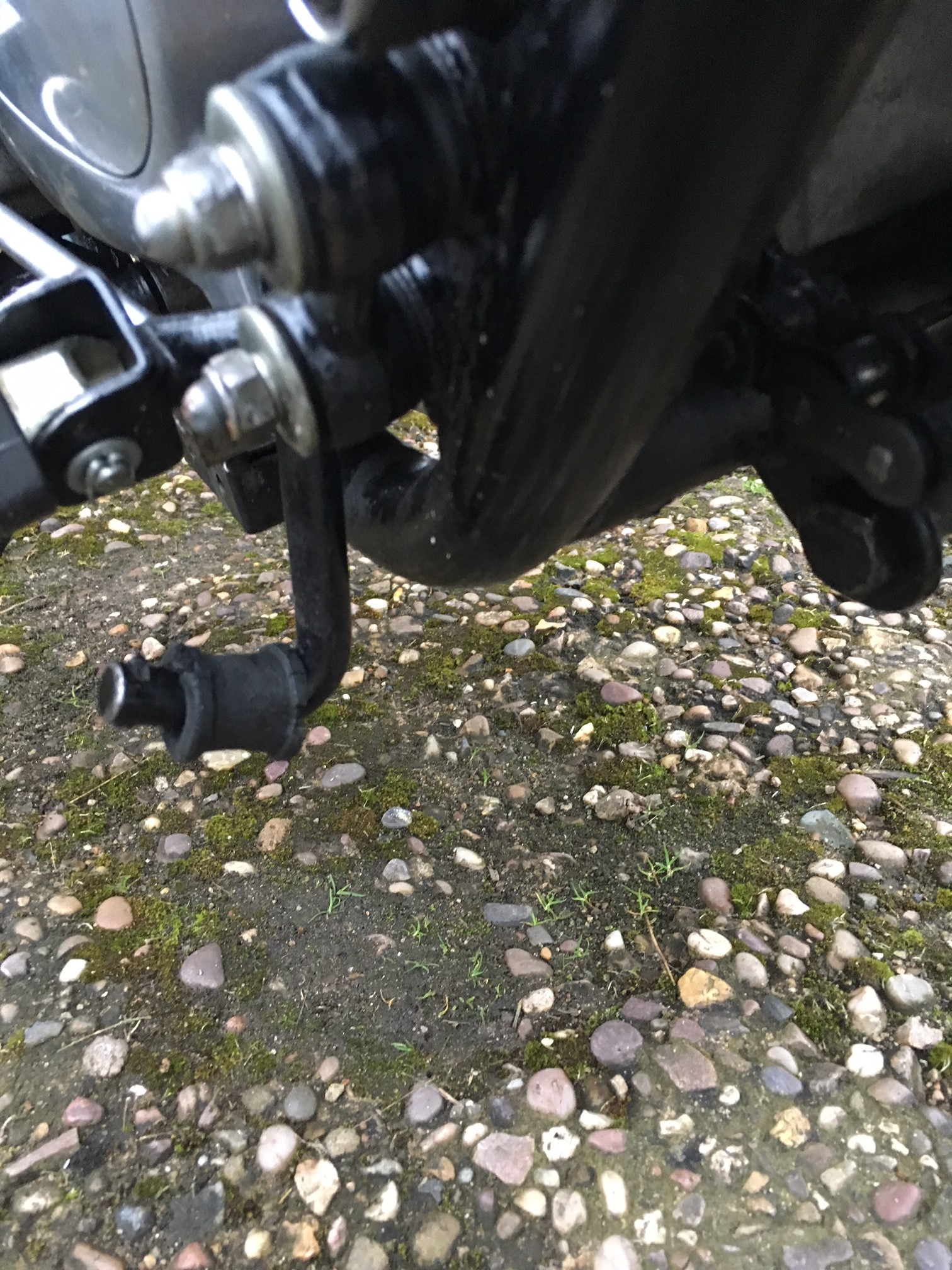

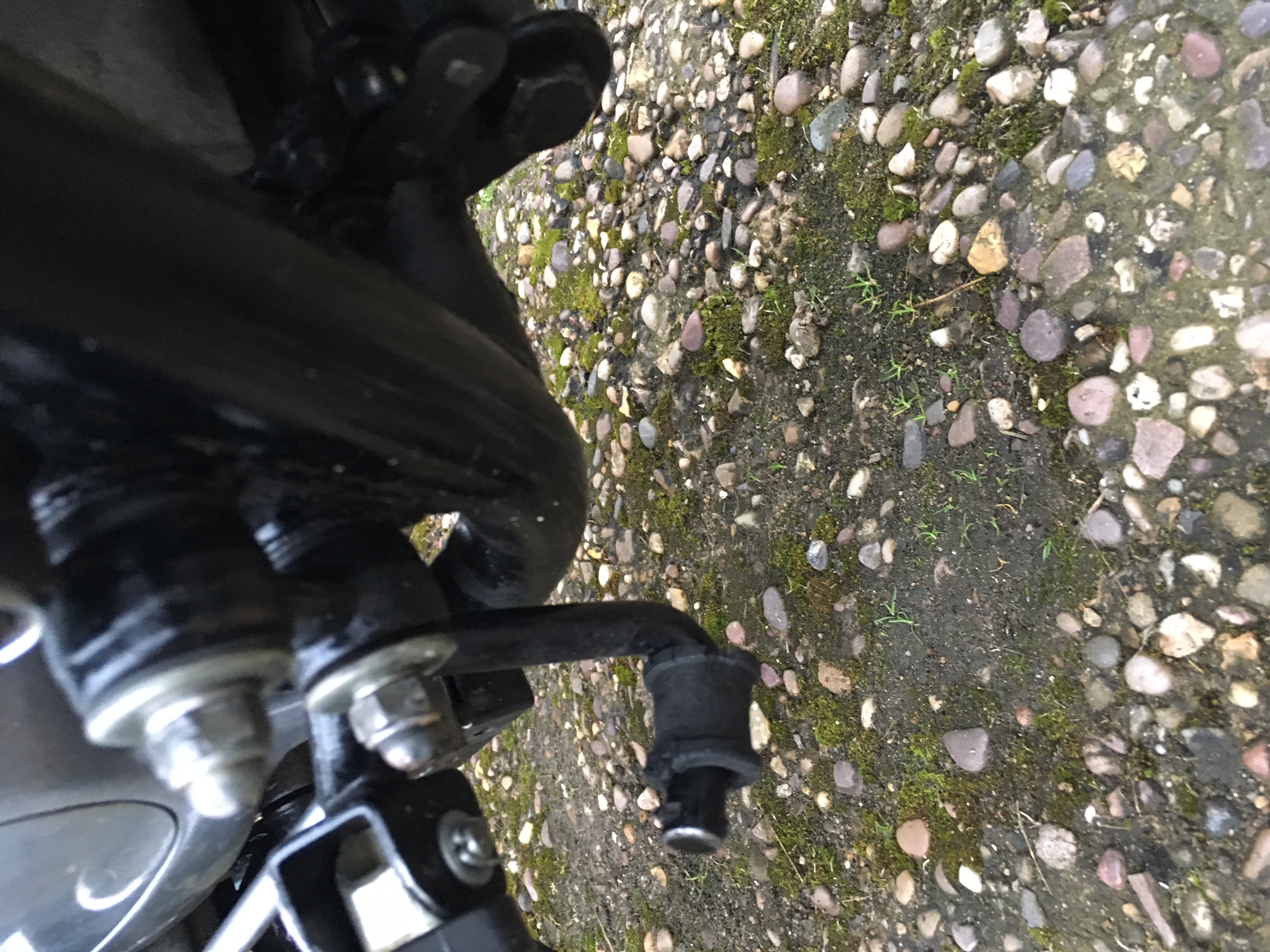

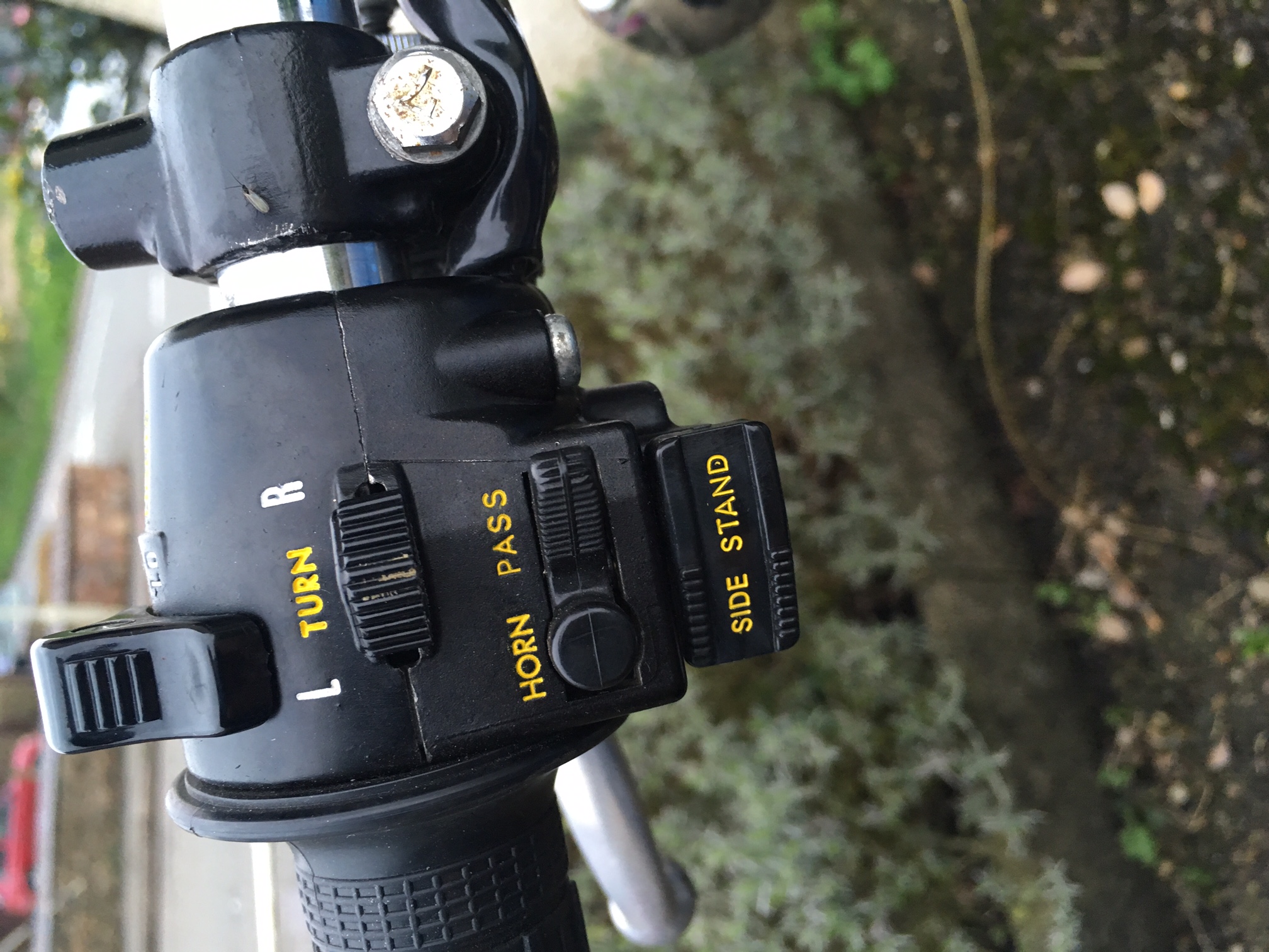

A couple more pictures -
The foot peg includes the side stand stop.
The left hand switch with side stand button.

#6 PostAuthor: chrisu » Wed Mar 29, 2017 6:07 pm
that is standard for german market bikes. god knows why.
I can post a picture of one of my Z1000Hs which is the same but has the switch still intact.

#8 PostAuthor: z1bman » Wed Mar 29, 2017 7:21 pm
some of the 550 & 750 ltd's used the same switch

#11 PostAuthor: BigZCas » Thu Apr 06, 2017 7:59 am
Hello Neil,
Sorry to be a pain.
Do you have any idea what the part number is for the rubber part that slips over the foot peg bracket, the Side stand hits it when it flicks back ?
