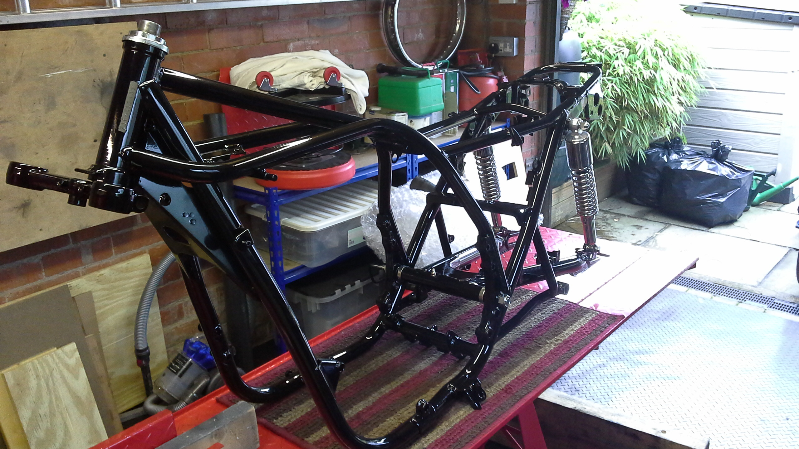

Just some advice needed on an up and coming A4 rebuild.
Im at the point now were ive got the frame back from the powder coaters and over the weekend ive attached the swinging arm and rear shocks. Just talking to some kawa lads the other day and they recommend i go no further, fully rebuild the block and lay it on the floor, then lift the frame sideways on over the block to ease installation. Their opinion was that if i tried to get the big lump in afterwards, it would be a real struggle. Any views on this would be appreciated. Paul.

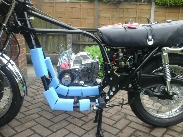

#8 PostAuthor: swampy » Sun Oct 08, 2017 8:56 am
save loads of bog roll and kitchen roll tubes for the job.
then make a cut in them down there lenthg and use them to wrap around frame tubes and tape in place.
i found this to serve very well to protect the frame during engine installation
