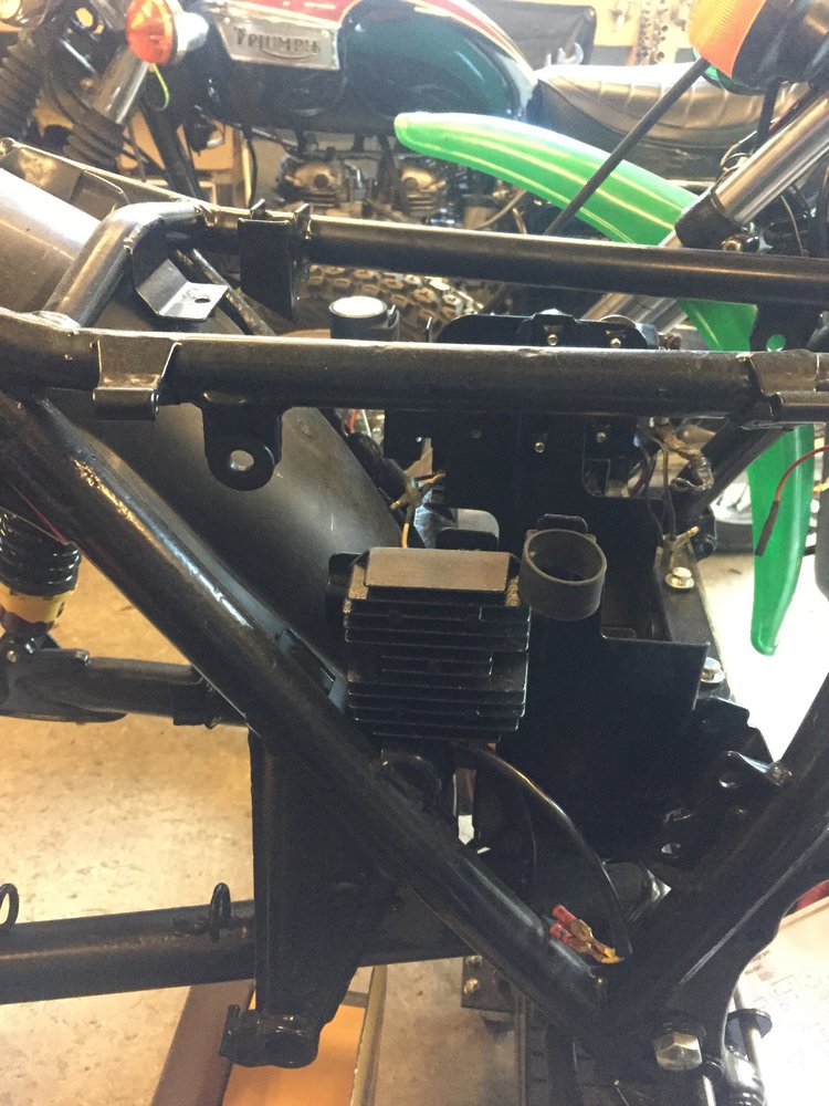

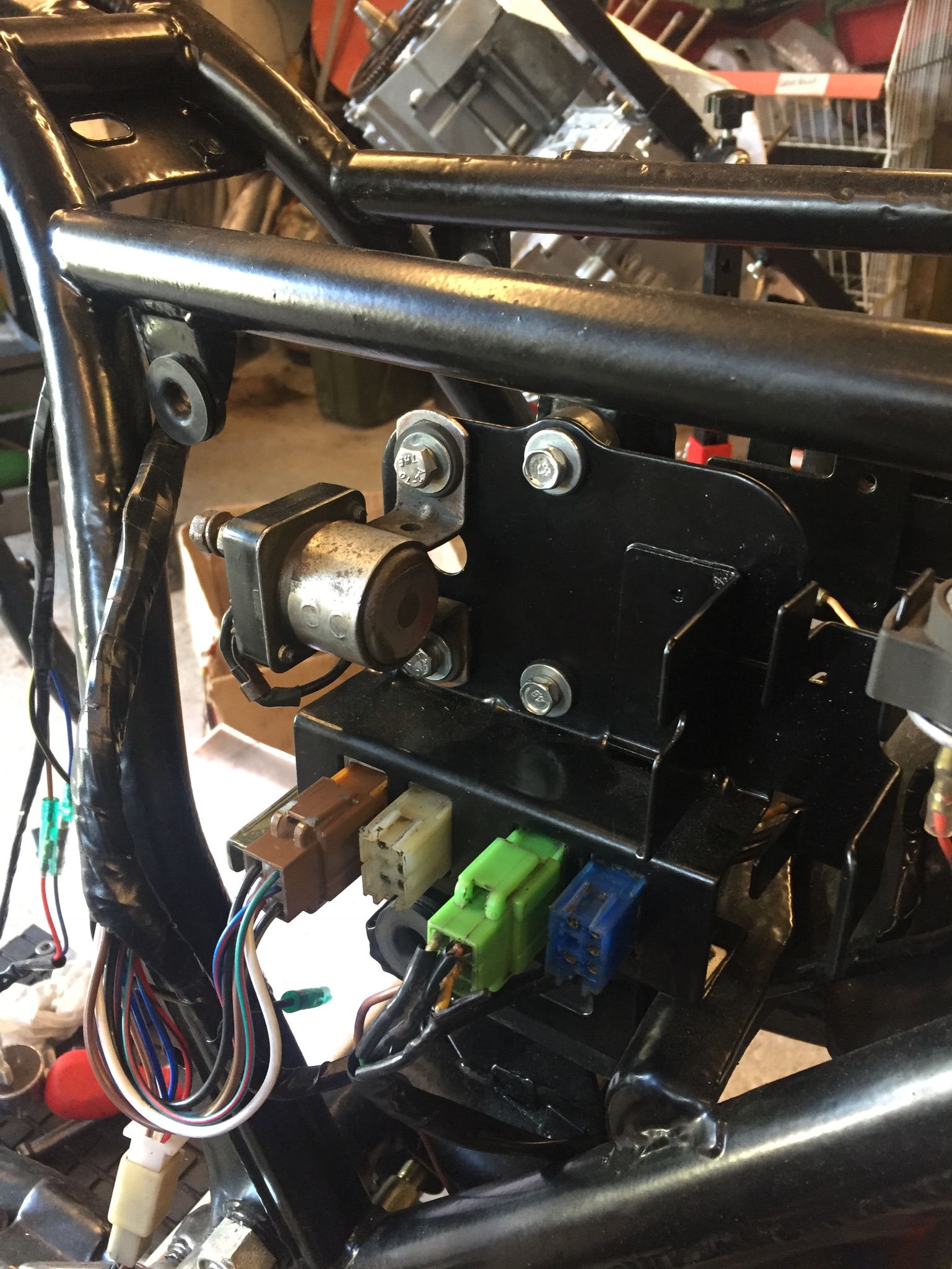

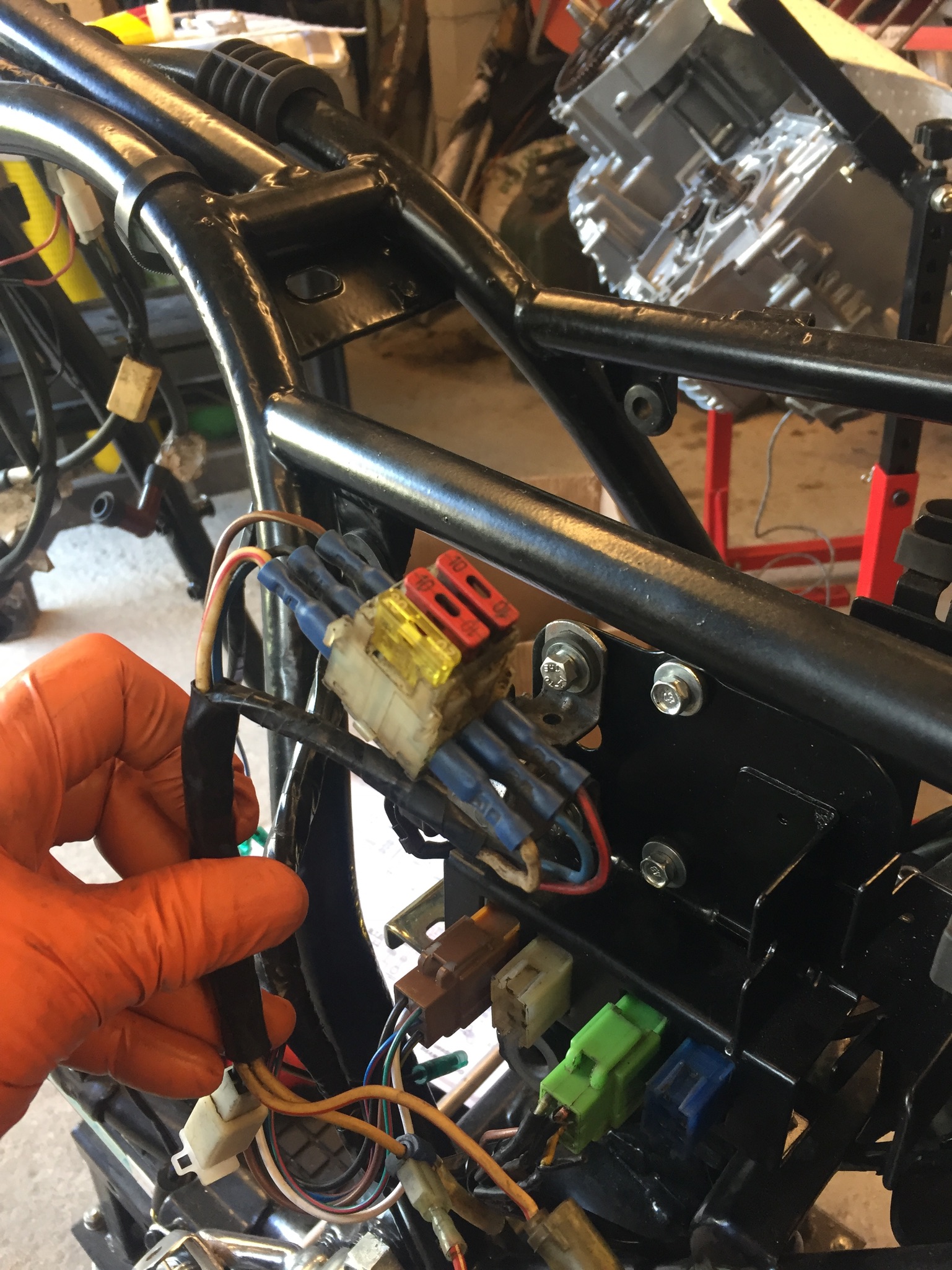

Hi all - little hold up on the engine assembly gave me the time to have a poke around with the wiring. This has raised a couple of issues. Pics attached.
1. What is the white plug on the wiring block - I don't have anything to plug into this and am not sure where it goes or what the loom needed for it is. If anyone has got one spare I would be happy to buy it.
2. It looks like someone previously has swapped out the original fuse box for a bladed arrangement. Again any tips on if this should be kept or put back to original would be gratefully received. Again I dont have a fuse box so if anyone has one surplus to sell that would be ace.
Re: Z1000A1 Electrical box queries
White is the socket for the rectifier,looks like you dont have one on the panel,green should be the voltage regulator and blue is the genny input,brown is the loom,has the bike been converted to combined reg/rect unit? fuse box dont look too clever would go back original meself...Paul J

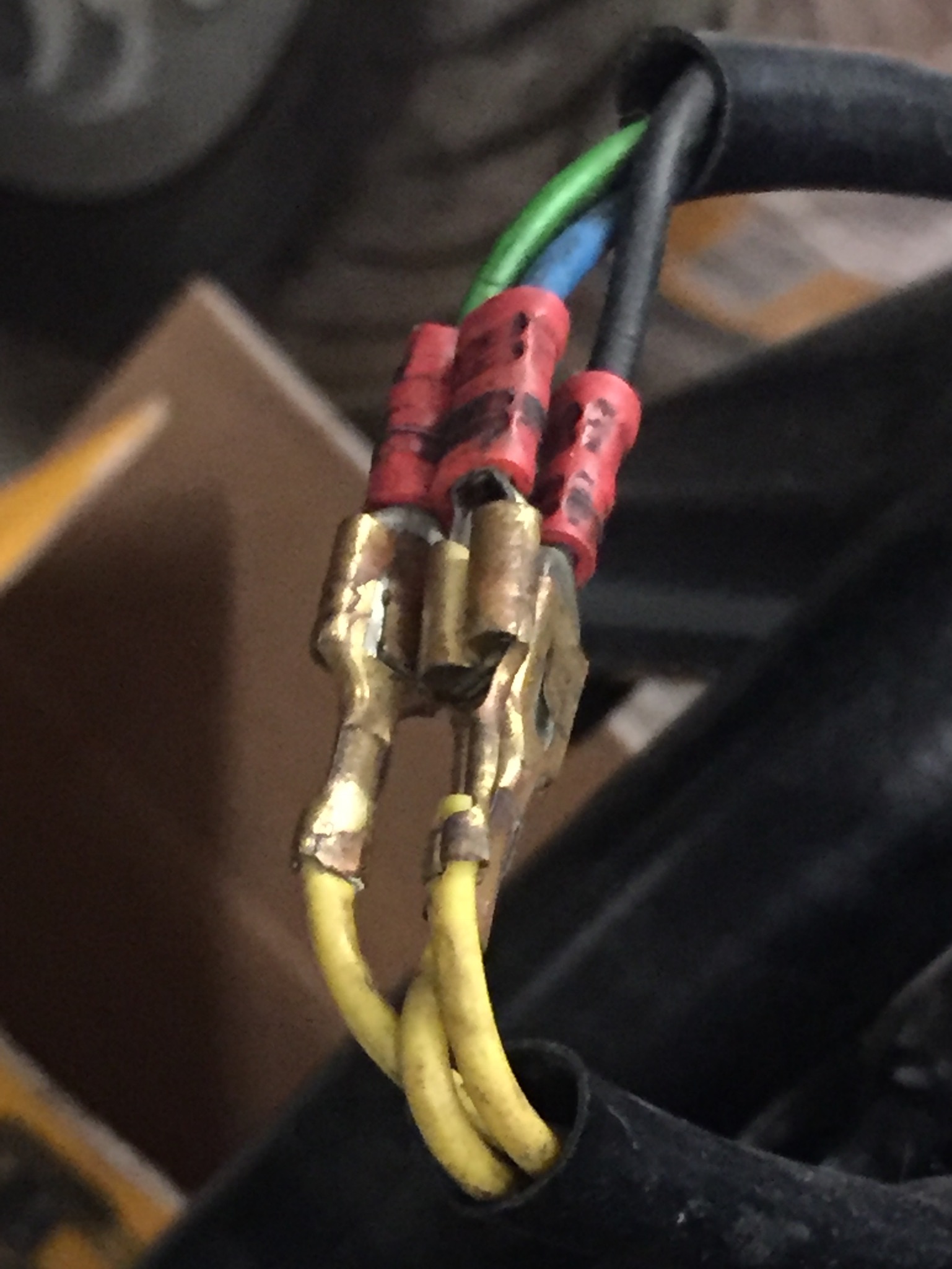

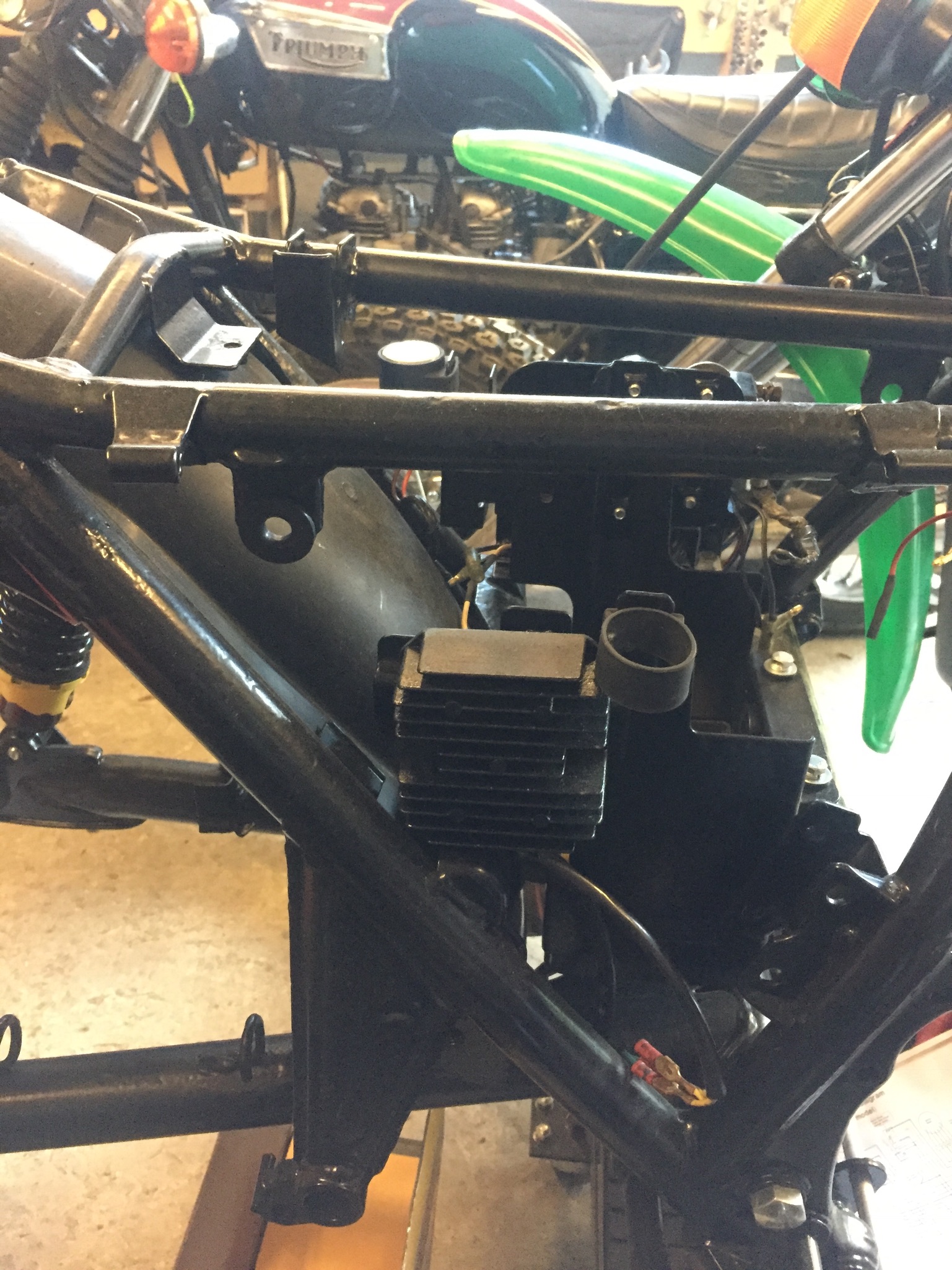

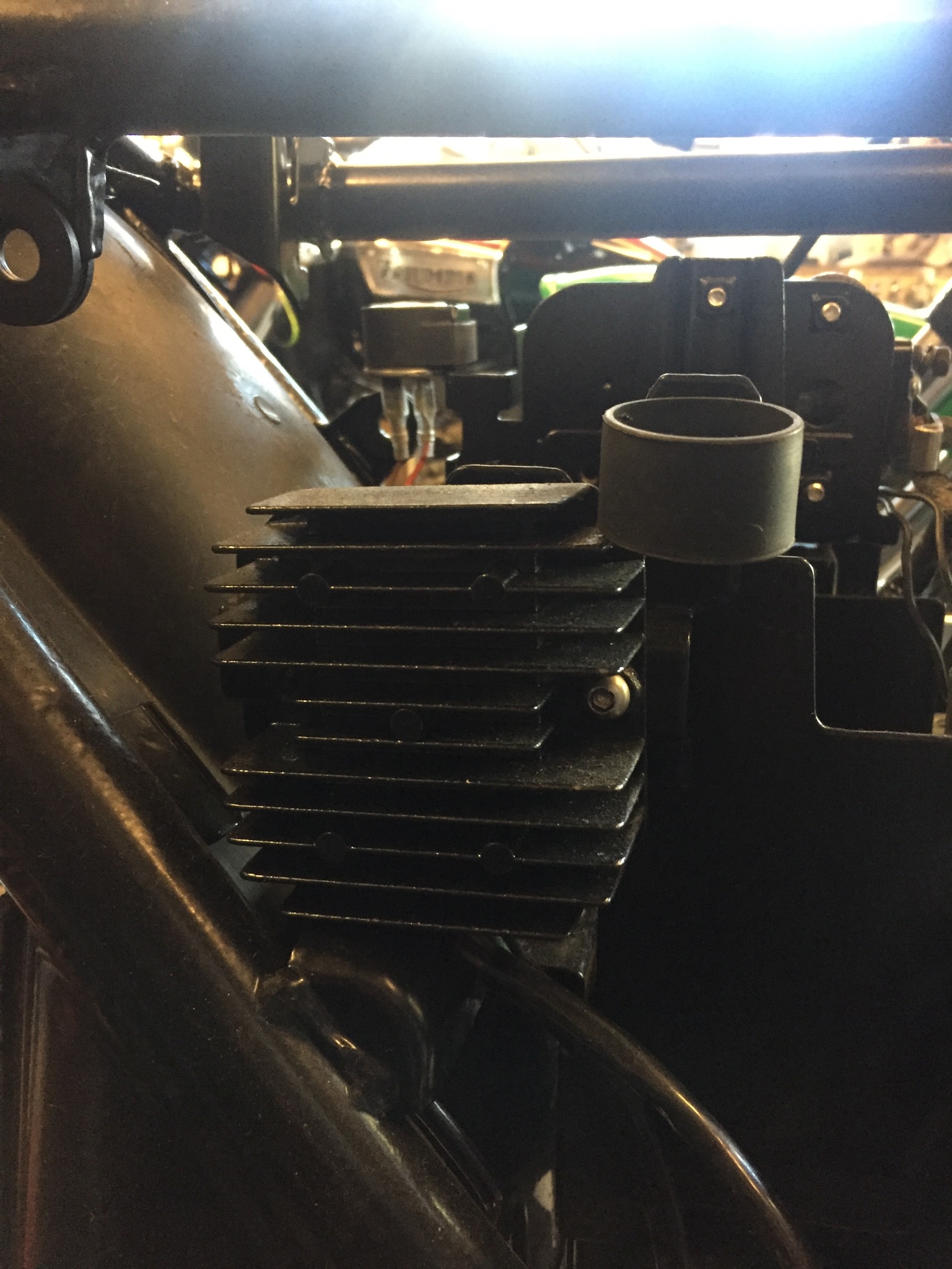

Thanks Paul - all I have on the other side is one of these Sorry to sound thick but I only got a load of bits that were basically from one bike, but who knows?There have been some wiring alterations on the original loom which was just a mess in a carrier bag, so I bought a new Zpower one.
Yep looks like a generic combined regulator /rectifier,would go ahead and re use,dig it out and let me know if its 5 or 6 wire unit and i will tell you how to wire up and test..bye the way its best to mount these units were there is a good airflow to aid cooling,on an a4 a good place is under the battery box,may be poss on your thou..Paul J

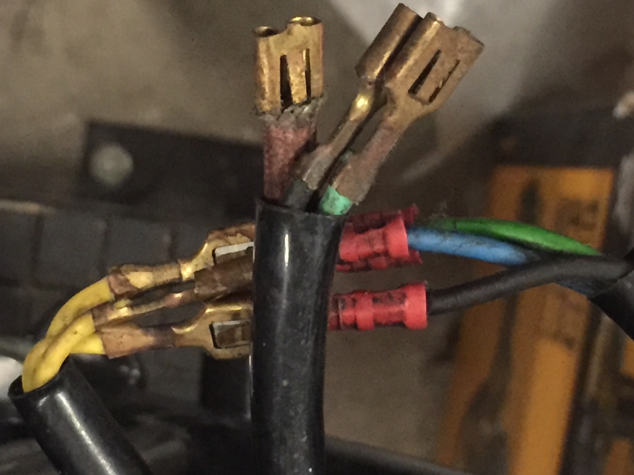

Cheers Paul - it looks like a six wire setup - two looms with three in each.
Apologies for the poor pics I had packed everything away for the day. Grandson time!
Three yellows are genny outputs any order to the black blue and green,on other loom black is volt sensing put that to live side of the back brake switch so unit goes hot when ign on,the green is frame earth,the red?old braided cable is the feed to the battery live...with engine running you should get about 50 v ac between any of the 3 genny yellows,look for around 14.6 dc across battery at 3k revs..Cheers Paul J

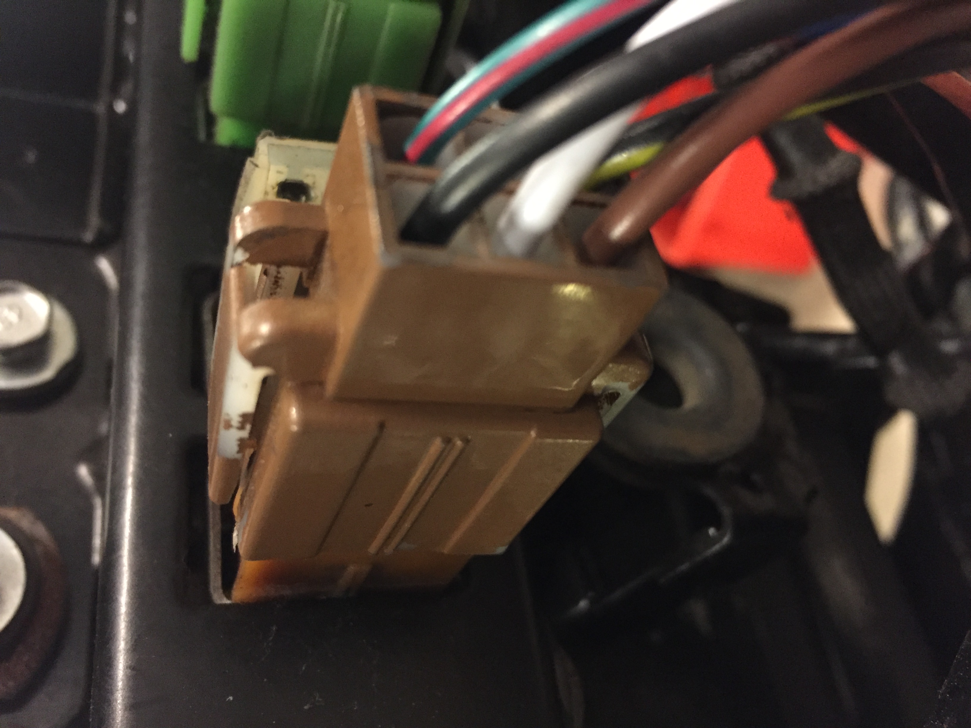

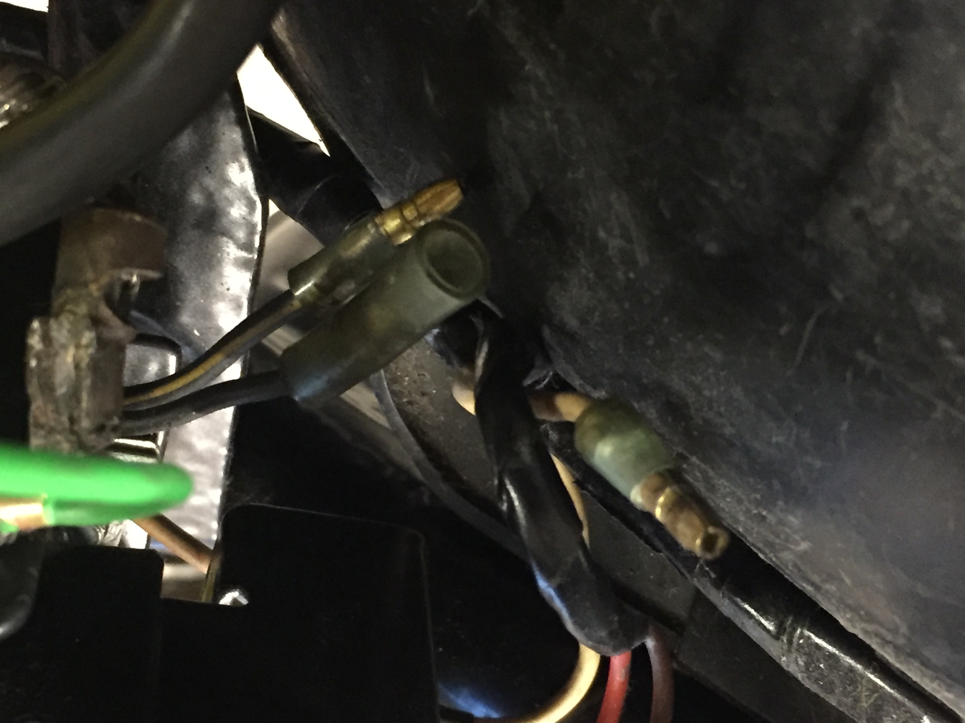

Happy new year every one - I managed to get an hour or so in on the bike today - and while some stuff went reasonably well I’m getting bogged down with other bits and pieces. Have to say electrics are not my strong point. My immediate issue is what are the connections to the three wires - black - black yellow and white that come from the rear of the multiple coloured connection block? The fixed connection panel under the side panel on the lh side of the bike. The wires come from the rear of the fixed side of the panel. I’m guessing blk/ yell is earth but I don’t have anything obvious to hook up to them.
On the same connection block I seem to have a permanent live feed to the top left black wire when I think it should be to the white lead just under it - that will then feed the ignition. The main loom is brand new from a power and there are some slight differences to my old loom such as my old handle bar switch gear cables ended in a multi plug whereas the new loom has individual bullet connecters - that was easily sorted. Just wandered if anyone else had these issues?
The works manual that I’m using only has a z1000a2 Euro model and again there are a few things on the diagram that I don’t have. Any help most welcome.
Hi csx355
the black cable gives power to the starter relay and connects it to the starter button, the black-yellow is earth and the white gets the + pole connected to the contact switch in order to give "juice" to the whole bike.
Many thanks Philipe -
Black to the LT terminal on one side of the starter solenoid - check
Black / Yellow to convenient Frame Earth - check
White to + pole Connected to Contact switch - I'm not too sure about that one - sorry could you elaborate for me.
Hi csx355
there's a white cable coming from the starter solenoid, it's attached to the battery cable, connect this white cable to the white cable that comes from the main loom. It goes to the fuse box where it has a 20 Amp fuse, the main fuse. The current goes over that fuse to the main switch. I thought I saw on one of your pictures that you don't have a genuine fuse box...get one, that's where the white cable comes from.

Hi csx355
I checked on my Z1000A1 this morning... I forgot to say I have an early US import... In that US loom there's an extra white wire connection.
If you have a European loom there's no extra connection. I have no idea which loom Z-Power provides, the US or the European.
So just to make sure: from the starter solenoid there's a wire with a double socket. One white wire which comes from the fuse box has to be plugged in there, another white wire which comes from the rectifier must allso be plugged in there.

Thanks Philippe - all done - I started from scratch today and got it sorted with the advice from yourself and Paul. I have put an update on the project thread.
