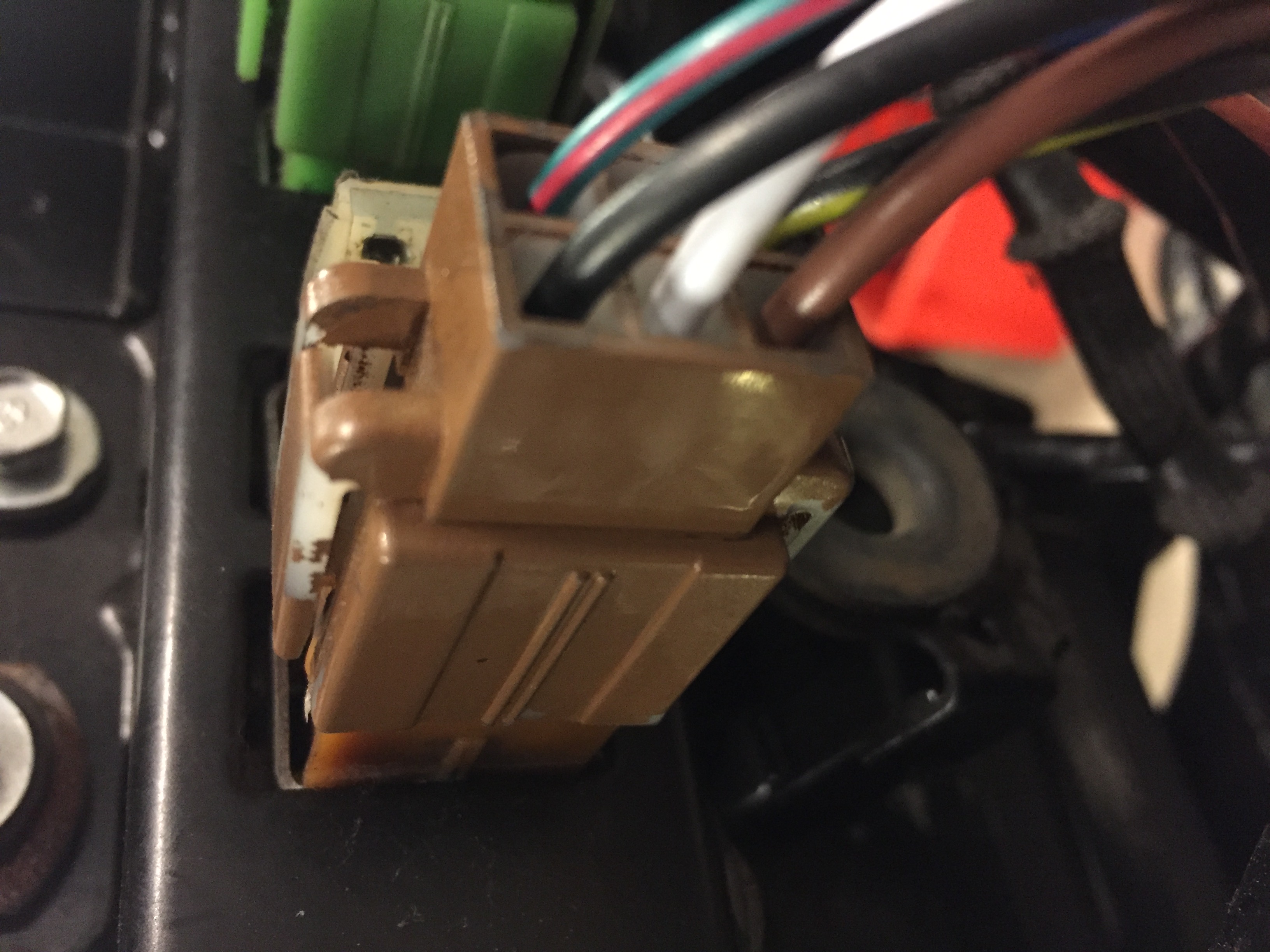

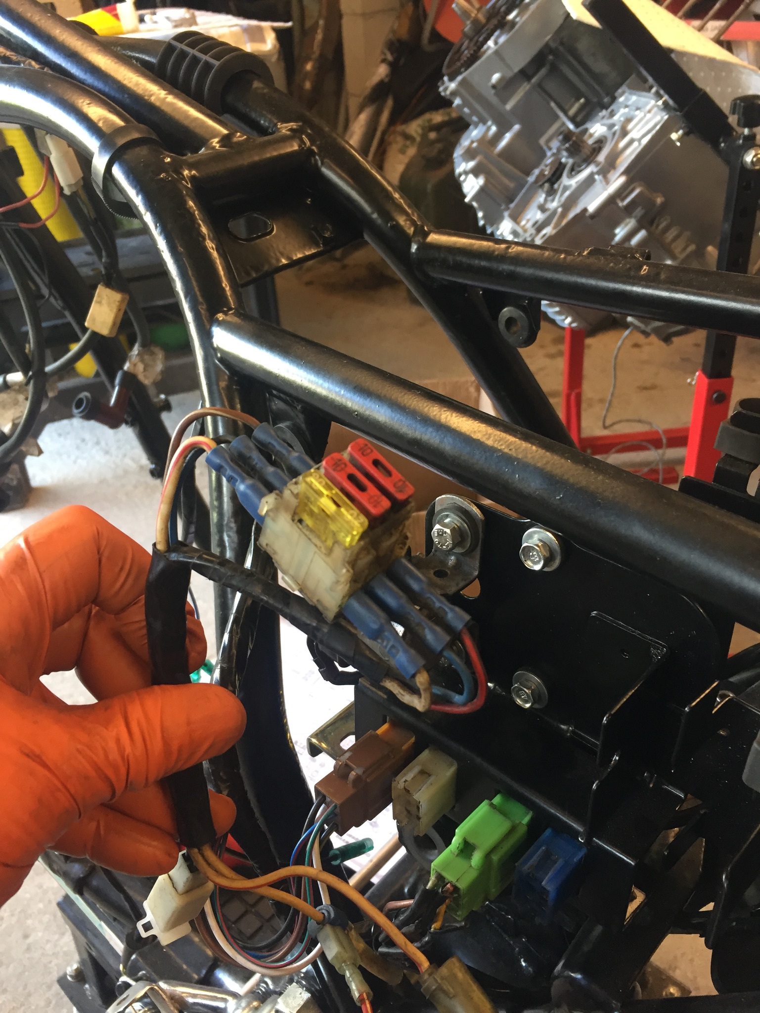

Hi all - little hold up on the engine assembly gave me the time to have a poke around with the wiring. This has raised a couple of issues. Pics attached.
1. What is the white plug on the wiring block - I don't have anything to plug into this and am not sure where it goes or what the loom needed for it is. If anyone has got one spare I would be happy to buy it.
2. It looks like someone previously has swapped out the original fuse box for a bladed arrangement. Again any tips on if this should be kept or put back to original would be gratefully received. Again I dont have a fuse box so if anyone has one surplus to sell that would be ace.

White is the socket for the rectifier,looks like you dont have one on the panel,green should be the voltage regulator and blue is the genny input,brown is the loom,has the bike been converted to combined reg/rect unit? fuse box dont look too clever would go back original meself...Paul J
