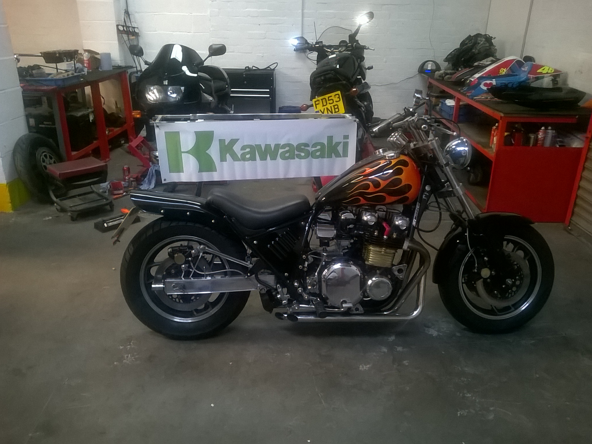

#8 PostAuthor: Swirl » Mon Dec 18, 2017 10:31 pm
This is the bike
Swirl
Posts: 743
Joined: 9th Feb 2017
Re: Carbs or cams
#9 PostAuthor: Swirl » Mon Dec 18, 2017 10:33 pm
This is the bike
