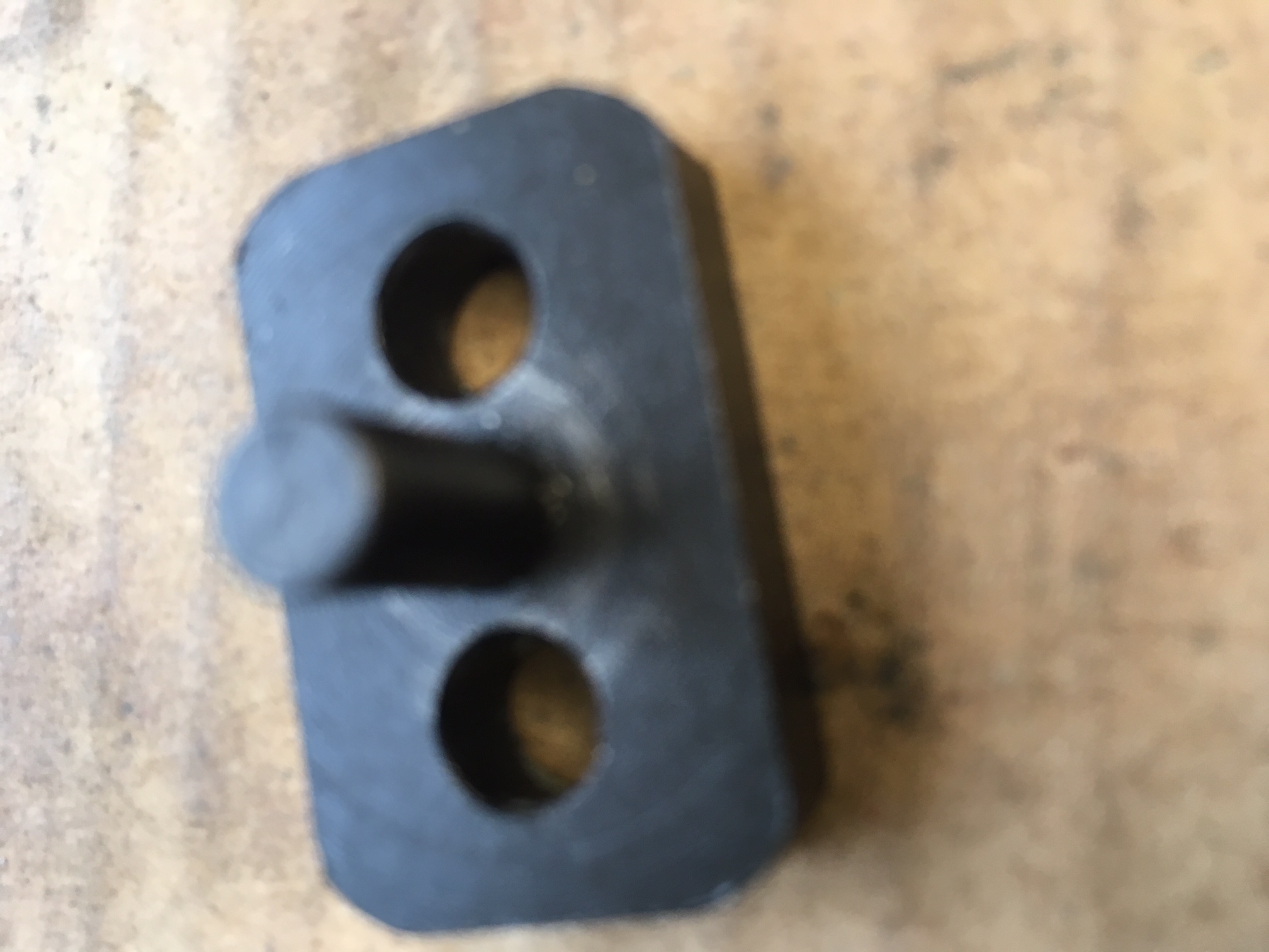

Fitting a new chain to my Z1a, after struggling to push the link sideplate on, I noticed that the tool that I had loaned from a mate was not correct.
The holes in the internal piece were too close together by about 3mm, hence I could not shove the plate on (see attached).
(and I expected the piening bit to be the difficult part) :lol:
Could anyone advise what I should buy / method I should use to join the chain...

I have the same tool and there are a couple of different spaced attachments for different chain pitches.
Think you may have the 530 one there and you need the 630 which is 1/8th inch (3mm approx.) longer between pins.
Just use the press tool without the attachment and work the side plate on alternatively from one pin to the other with the hollow press bolt, making sure not to go too far which will crush the 'O' rings.
