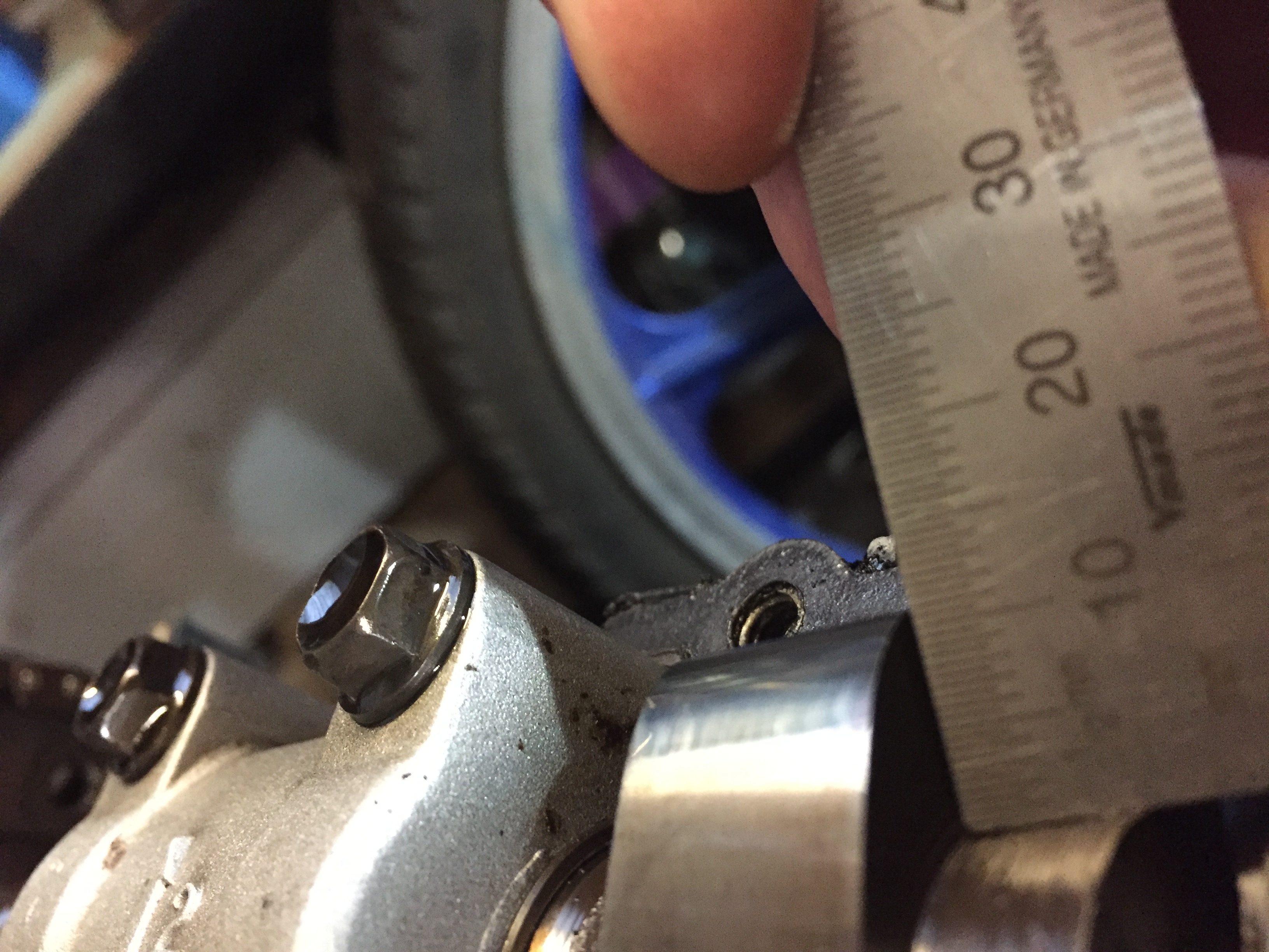

Gavin
Posts: 871
Location: Scunthorpe
Re: GPZ1100B2 cam specs
#9 PostAuthor: Gavin » Wed Jan 31, 2018 12:11 pm
Thanks for the reply Rob.
The cams are still in in the head and I don’t have the gauges you suggest. I did a rough measurement on the upper lobe
with a rule (pic), is this what I need to measure as I get approx 11mm
Z1000 MK2
Z1300 DFI
Posts: 4040
#10 PostAuthor: zed1015 » Wed Jan 31, 2018 12:33 pm
Gavin wrote:Thanks for the reply Rob.
No! The lift will be less than that.
11mm is race cam territory.
More like 8.6 to 9mm ish.
The base circle is a larger dia than the core of the cam that you are measuring from so the lift will be less.
You need to measure across the cam from the peak of the lobe through to the bottom of the cam then measure the base circle and subtract that figure to get the lift..
If you have some Verniers you should be able to take those measurments with the cam in situ.
Gavin
Posts: 871
#11 PostAuthor: Gavin » Wed Jan 31, 2018 12:47 pm
Ah makes sense now, cheers
