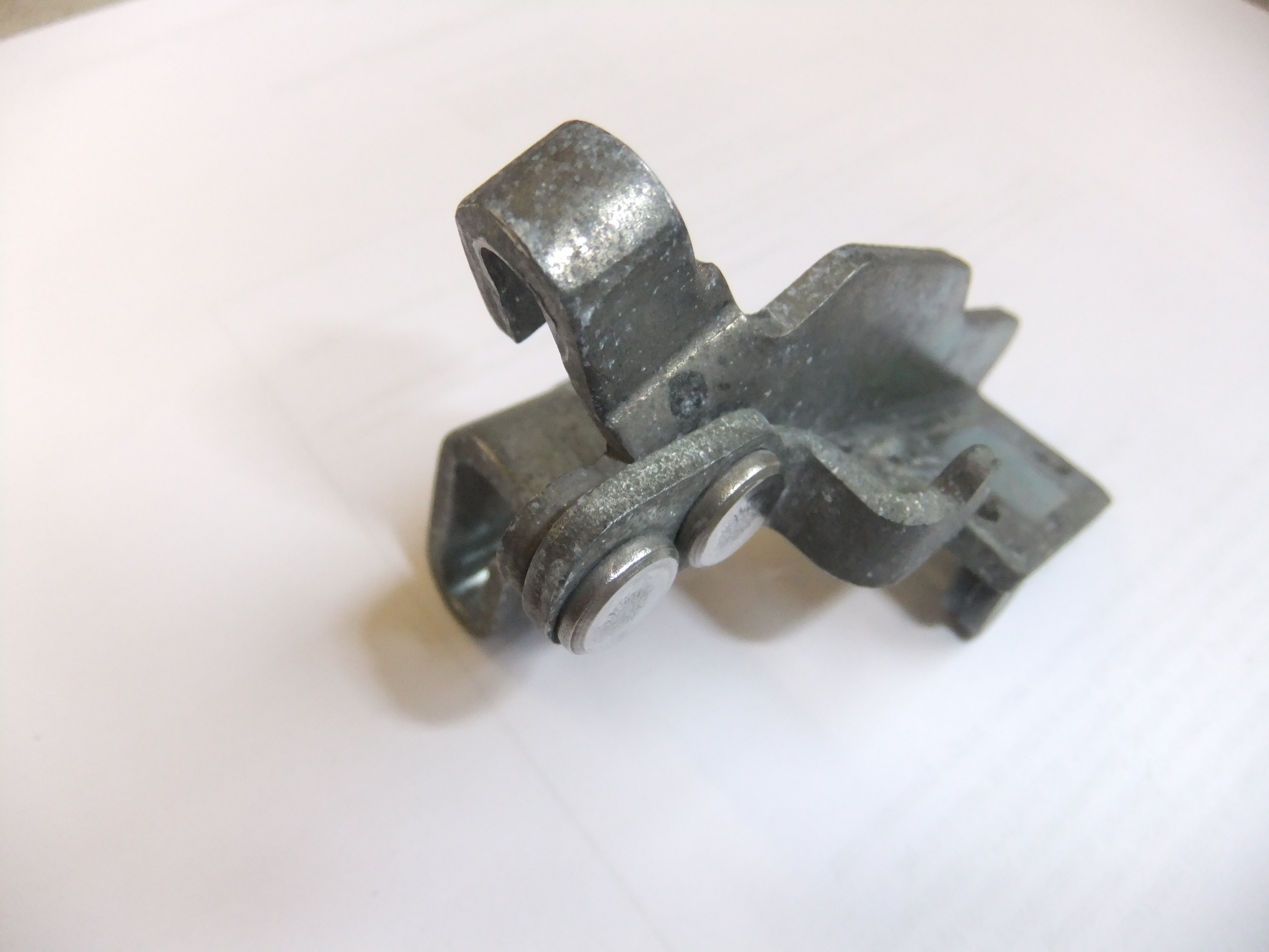

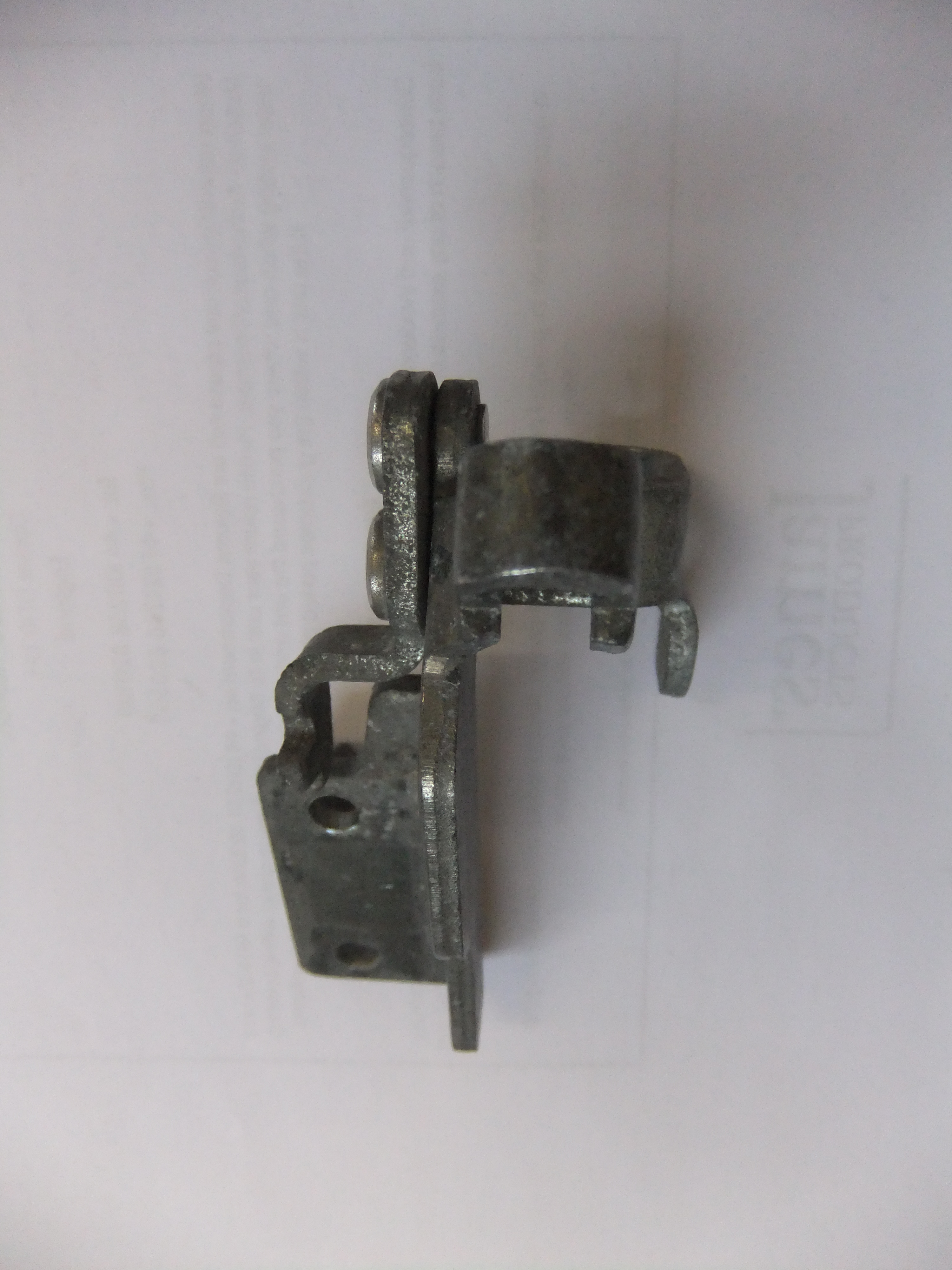

Help needed please.
The two riveted parts of my throttle cable bracket have become a bit loose. Do they respond well to a large hammer and punch or is it best to drill the rivets out and replace with nuts and bolts?

There should be some movement in them to allow the closing cable action to work properly.

The play is normal.
That's why there is a spring between them and the back plate near where they bolt on with the 2 countersunk screws.
It's to provide a bit of cushion for the closing cable.
The holes in the half of the bracket that isn't bolted down are larger than the rivets to allow movement.

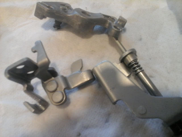

Yes, lubed the braket I cleaned up, and yes there is play in it now.
