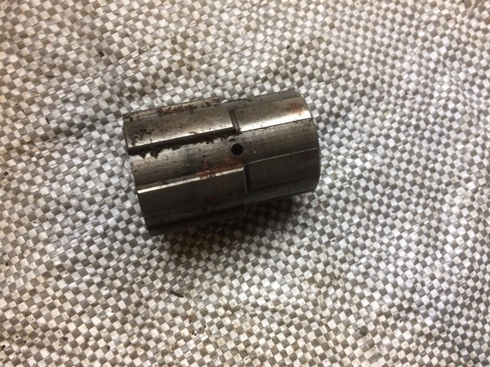

Does anyone have a GPZ1100A Unitrack splined clutch centre sleeve they can measure for me.
I need the overall length, the length of the reduced outer portion and the max outer diameter of the reduced portion.
Thanks.

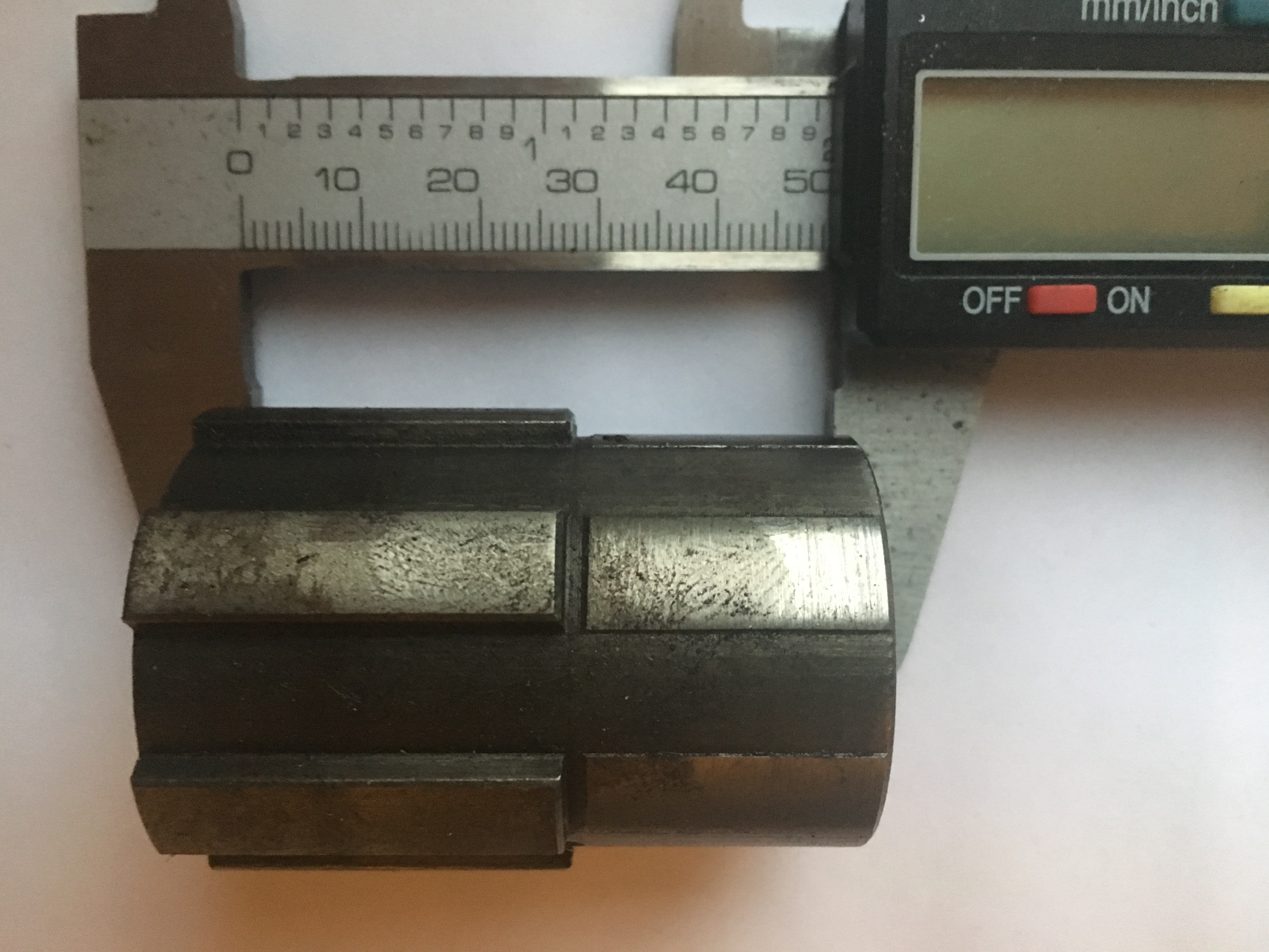

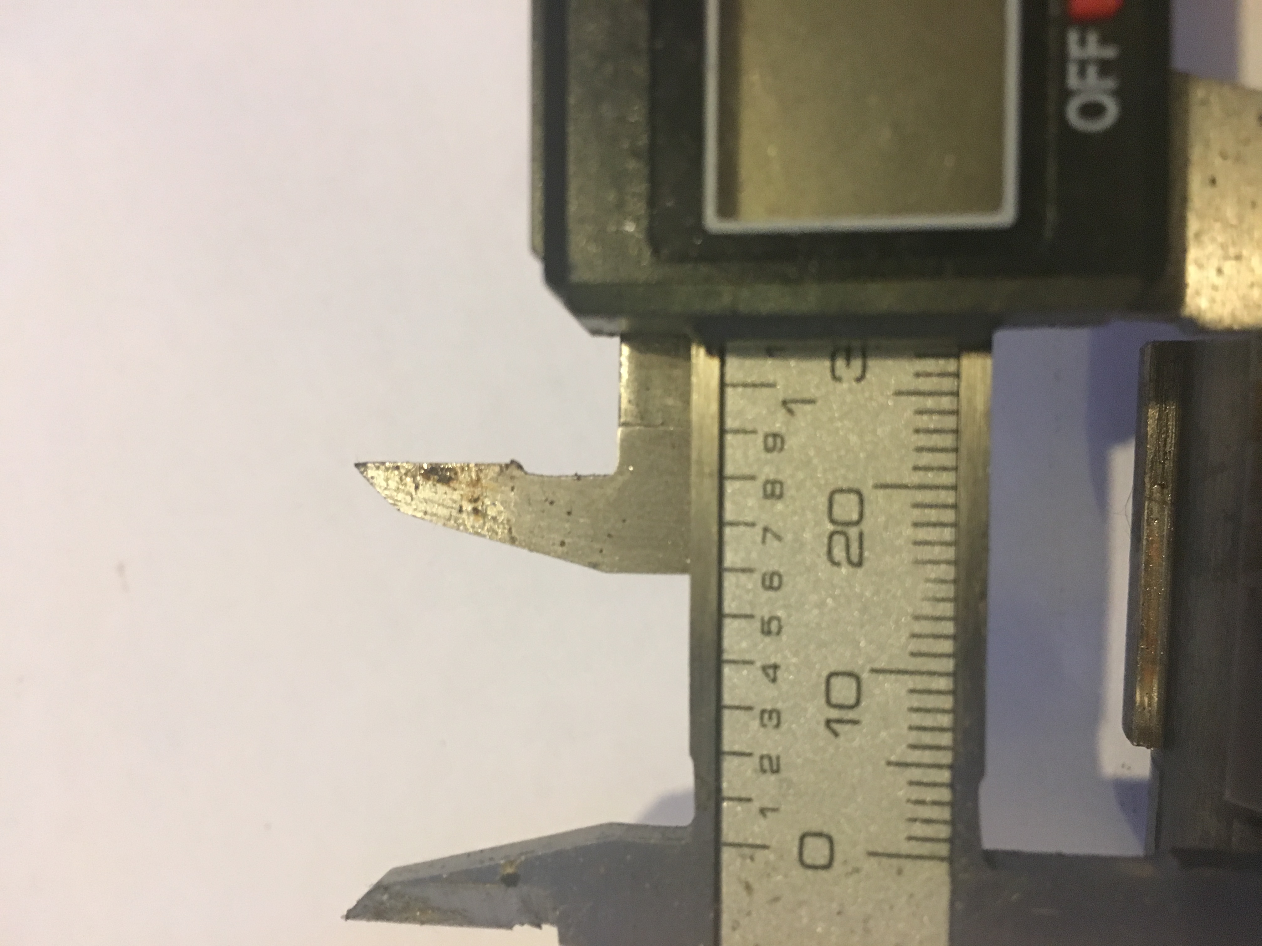

Length is 50mm, 21.93mm length of reduced portion (end of large spline to machined end of sleeve) and 31.95mm max outer portion across two splines.

O/A Length -49.5mm
Length of large dia. - 27mm
Length of reduced dia - 22.5mm
Dia. Of reduced end - 31mm

Thanks for that.
Slight variation in measurements though.
