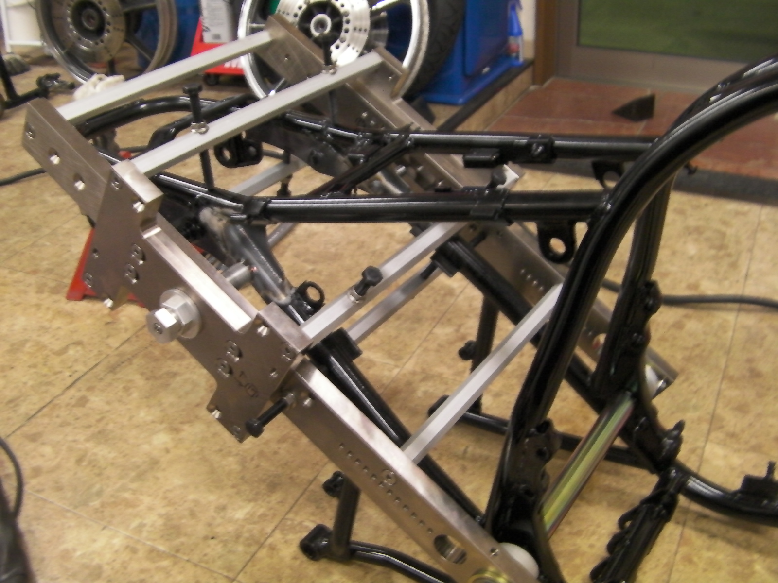

there should be two small metal lugs under the frame tube which they hook on to
Posts: 4690
Re: Rubber tank strap route
#3 PostAuthor: z1bman » Sun Mar 25, 2018 9:37 pm
you can just make out one of the lugs on the frame tube

#4 PostAuthor: ZedHead » Mon Mar 26, 2018 7:08 am
z1bman wrote:you can just make out one of the lugs on the frame tube
Interesting Jig
