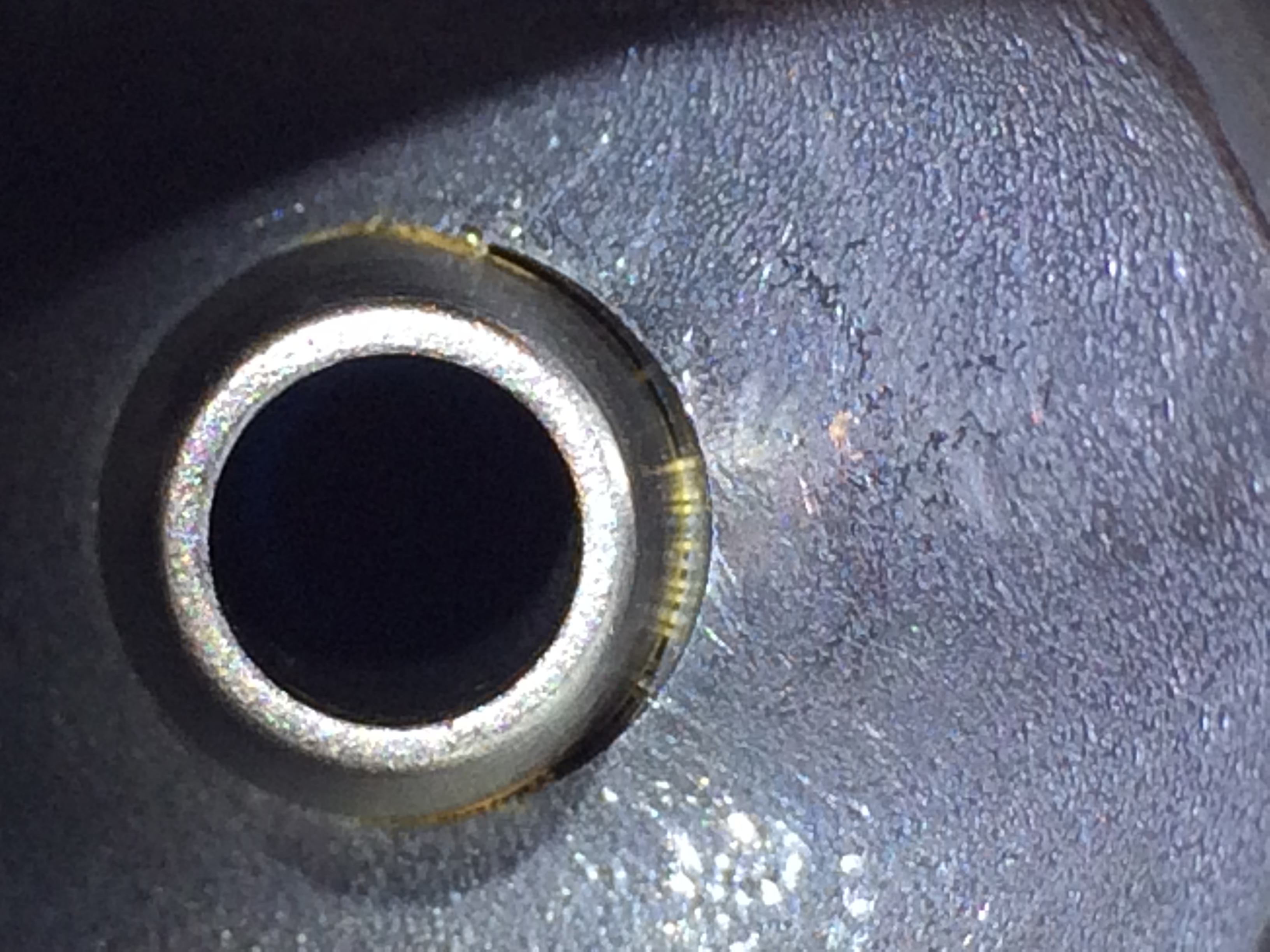

#6 PostAuthor: Blackseven » Mon Apr 23, 2018 7:30 pm
I've got exactly the same issue after a recent engine clean by Steve. See attached photo. I have flattened the end of a needle with a sanding drum on a dremel and spent an hour or more picking them out but the ones shown in the photo just wont shift. I really don't want to start replacing valve guides as I didn't spot this at first and have now had seats cut, valves re-faced and lapped in and the existing guides are still good.
I'm thinking though, that there must have been dozens, if not hundreds of other heads done like this by Steve that didn't subsequently have the valve guides replaced so I'm wondering how much of an issue this is? If it was ceramic debris in an oil feed to a bearing then that would be disastrous but if one or two of these did break loose and get sucked into the combustion chamber, would they just get blown out of the exhaust? ...........or would they wreak havoc with my fresh bores and new piston rings? Opinions welcomed!

#7 PostAuthor: zed1015 » Tue Apr 24, 2018 7:40 am
Blackseven wrote:
I'm thinking though, if one or two of these did break loose and get sucked into the combustion chamber, would they just get blown out of the exhaust? ...........or would they wreak havoc with my fresh bores and new piston rings? Opinions welcomed!
If they are ceramic it's pot luck whether they do any damage or not and with them being so tiny and in small numbers they will probably get destroyed on the way through and any bore damage would be microscopic and un-noticeable performance wise.
It wouldn't be such an issue on the exhaust side as they should just get blown out the pipe but it's the ones on the inlet that may going through the cylinders it they come adrift.
Personally I wouldn't be keen leaving them in and my view is that if they got in there they will come out.
The surrounding material is only soft ally and it should be possible to scrape away at the area with a small pick/sharpened scribe to release the beads.
The small amount of head material removed from around the guide won't affect anything.

#12 PostAuthor: zed1015 » Tue Apr 24, 2018 11:43 am
ZedHead wrote:I am probably "teaching grannie to suck eggs here" but if you replace the guides, would you also need to recut the seats? Could you not remove and reuse the offending guides, carefully marking the rotational angle first so they go back at the right angle?
Warming the guide, tapping it up a few mm then back down should be enough to shift the beads and hopefully not disturb the valve /seat orientation but removing the guide and trying to get it back in the same spot never works...been there done that..
Even just tapping it up and down could be enough to misalign it if you were unlucky and then you will have to re-cut the seats anyway and may as well go for fresh guides while you're at it if they are worn.
Maybe a bit of heat will loosen the beads but i would just dig them out with a pick.

#15 PostAuthor: Blackseven » Tue Apr 24, 2018 7:02 pm
Thanks for all the replies. I've used an extremely fine engraving bit in a Dremel down the gap between the head and the guide and removed a tiny amount of material but also seem to have succeeded in shifting the ceramic balls. I'm going to do the same with the other three inlet valves and as suggested will leave the exhaust guides as anything that did come loose from here would already be on its way out of the head.
Am quite relieved as was worried I'd have to shift the guides.
