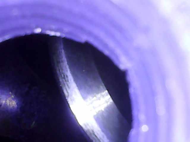

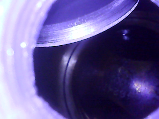

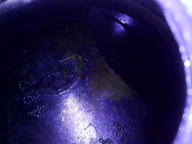

Some crap pictures off the endoscope showing nothing particularly useful. Also did some video, but cant get them off my phone for some reason.
When you look at the camera live you can clearly see that there are no witness marks on the top of the pistons where valves may have contacted pistons. So that's good news at least :wink:
Inlet valve:
Exhaust valve:
Exhaust valve pocket on top of piston:
