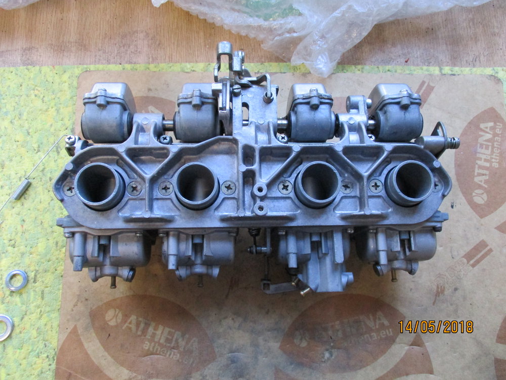

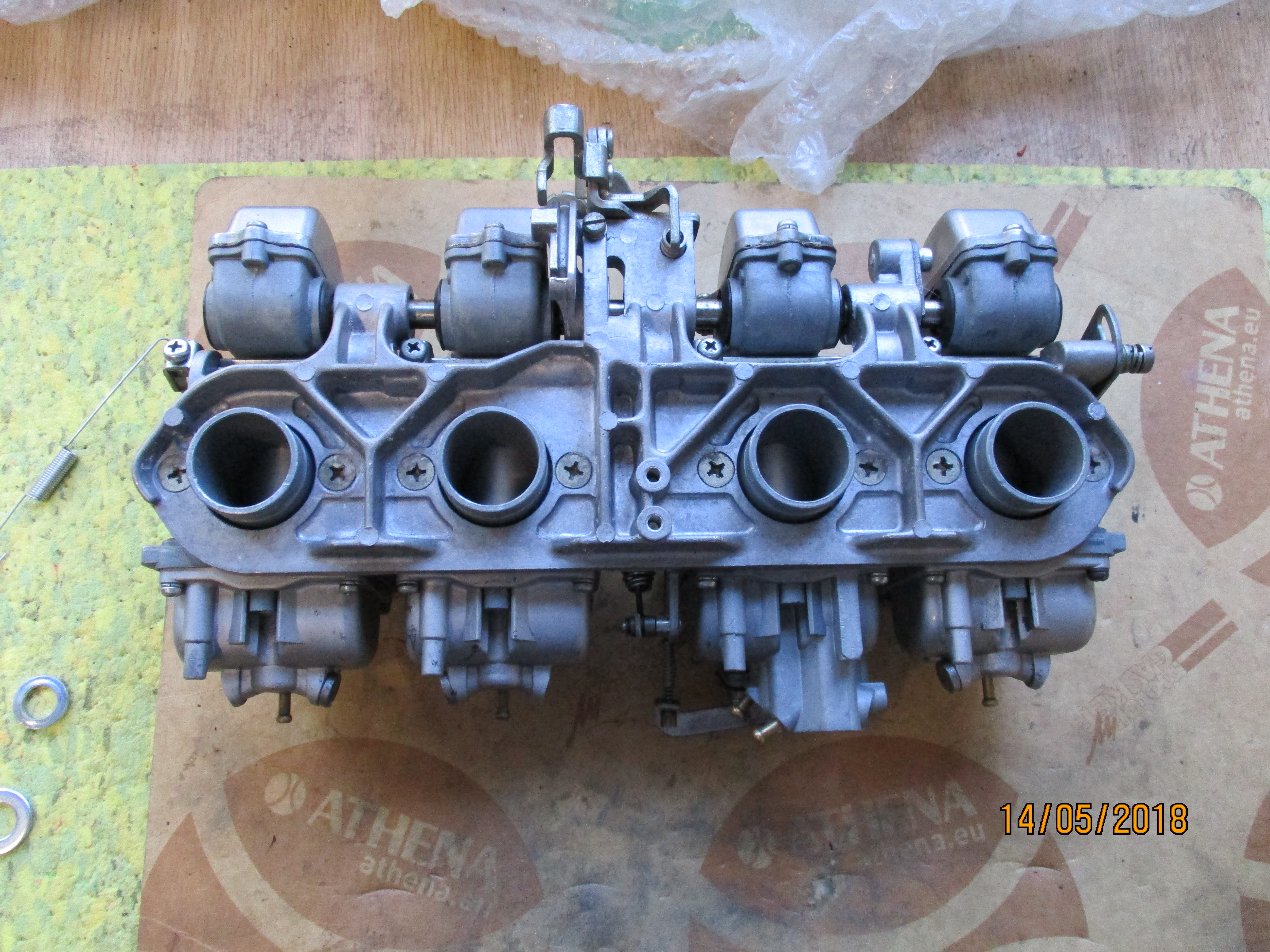

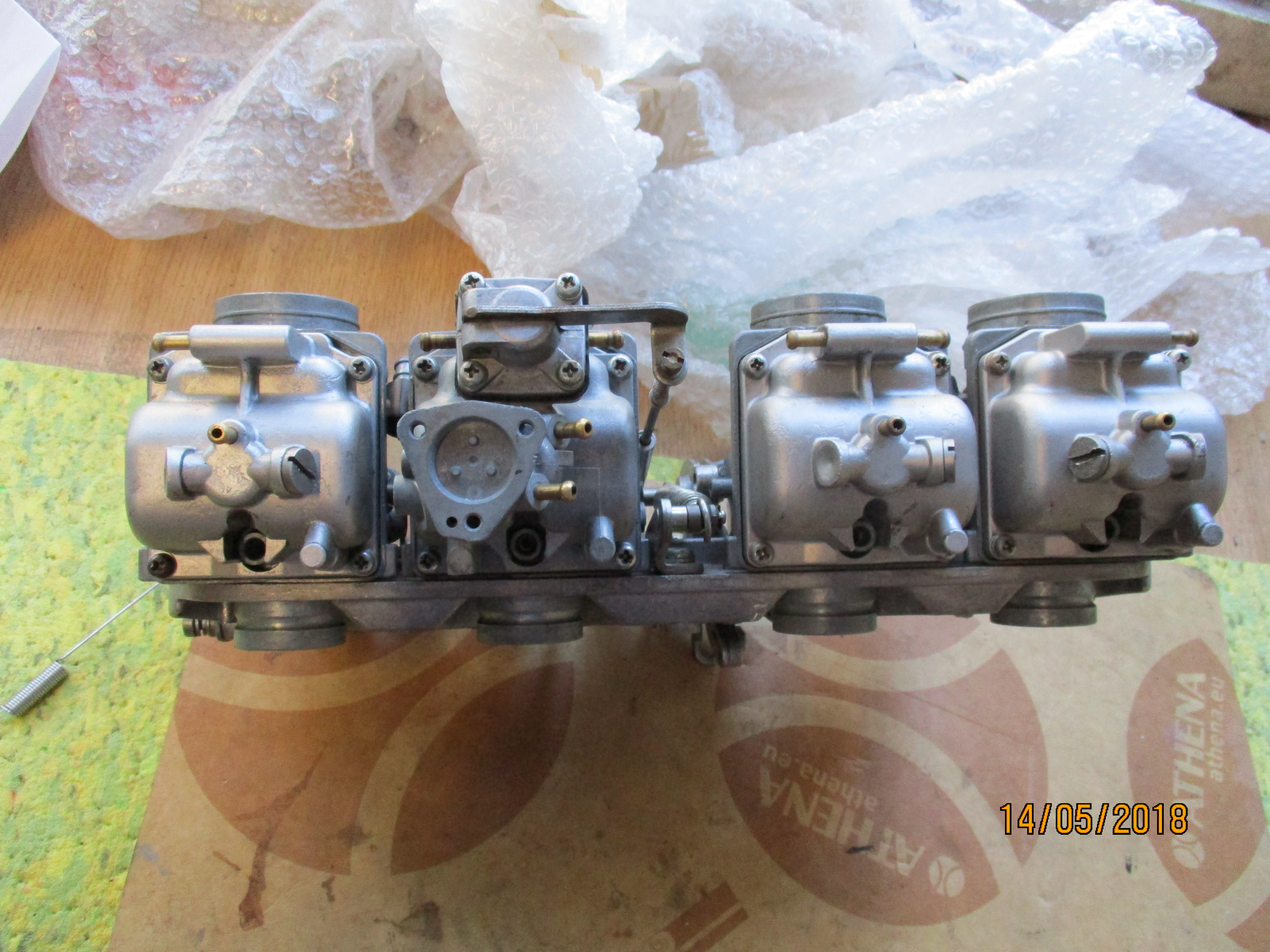

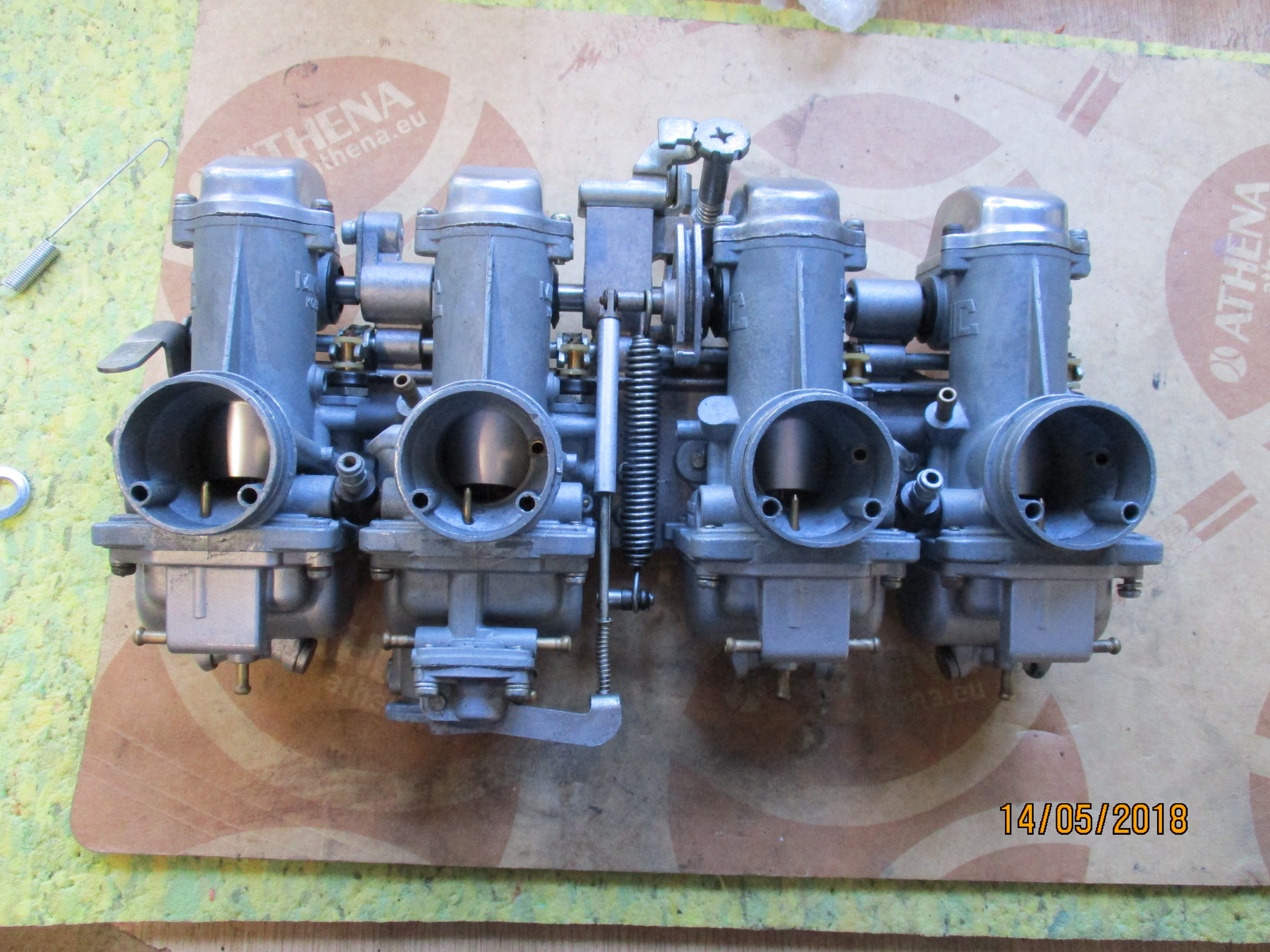

#9 PostAuthor: kev edwards » Mon May 14, 2018 6:37 am
If you post pics of the back front and sides, we will be able to identify them quicker.

#10 PostAuthor: Dunlop4 » Mon May 14, 2018 3:58 pm
Dunlop4
Posts: 224
Joined: 17th Sep 2015
Location: Cardiff
Re: z1000st carbs
#11 PostAuthor: Dunlop4 » Mon May 14, 2018 4:01 pm
These are the US carbs, i was told they are off a kz 1000st
Posts: 4040
Re: z1000st carbs
#12 PostAuthor: zed1015 » Mon May 14, 2018 4:06 pm
Yes! they are 28mm pumpers with no vac port.
Also used on some US Z1R and MK2.
Just hook the vac tap up to one of the inlet rubbers and when balancing with gauges either use a 'T' piece for the tap or run the engine on prime.
