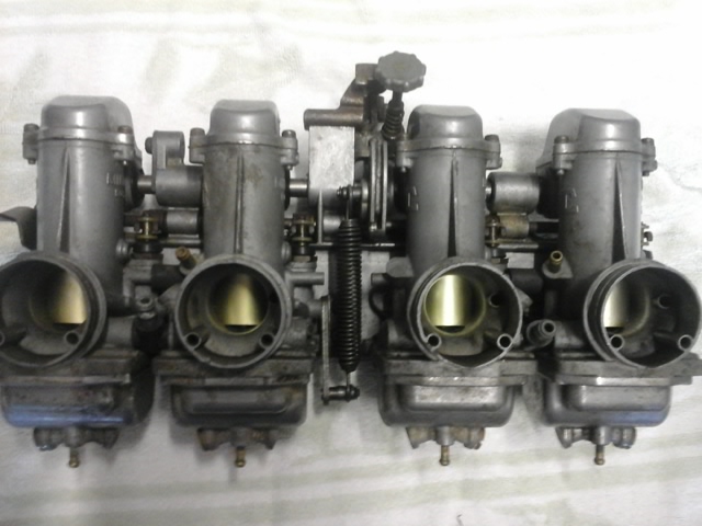

Do you have a pic of the full bank of carbs.
Mainly from the front showing the brass overflow stubs and the blank air screw castings.
Are these carbs from a vac tap equipped bike.

#6 PostAuthor: DavidZ1R » Sun May 20, 2018 6:36 pm
No, they are the correct cars for the bike.
