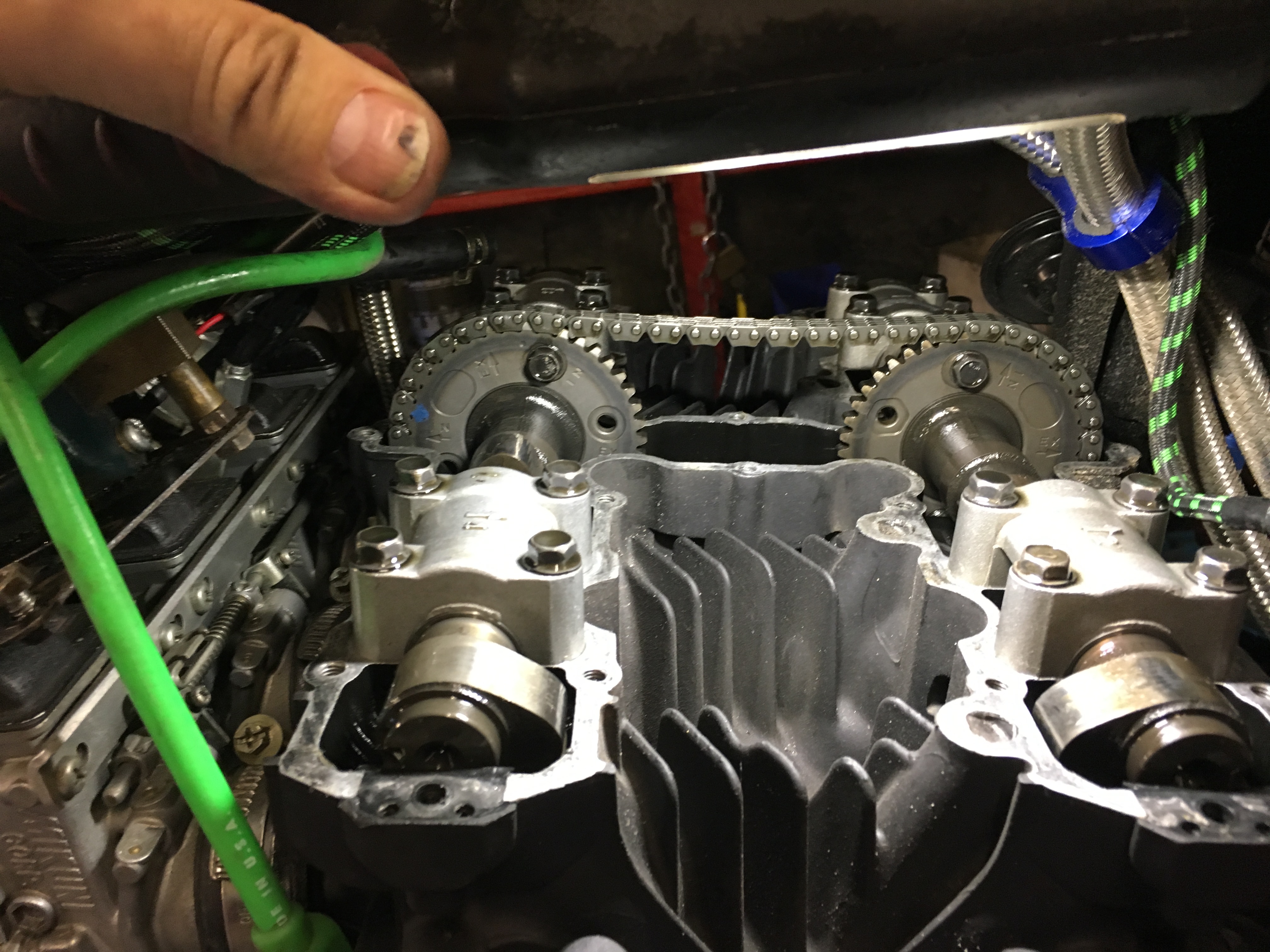

Got my cover off to check last night.
As I haven't a manual for these, can anyone advise on how many pins i need to count & from where, I've heard 41, but not sure.
Im here with my fingers crossed

That looks about right, and your cam chain looks a lot less worn than mine, if I remember I'll check the manual tonight

Correct tooth count is 44 from first pin above the exhaust cam arrow to the inlet cam arrow.
Re: APE manual camchain tensioner adjustment.
As above that looks to be fine at 44t between arrows. Is the slot on the RH end of the exhaust cam level with the cam cover gasket face, and is the inlet cam either level or slightly behind?

Yeah 44 teeth is what I have.
The slot on the ends of both camshafts are parallel with the gasket face.
So my next step is to do a compression test, to see if any valve issues, if that works out okay.I need to investigate further & it will need to be stripped.
It doesn't look good at all at this stage.

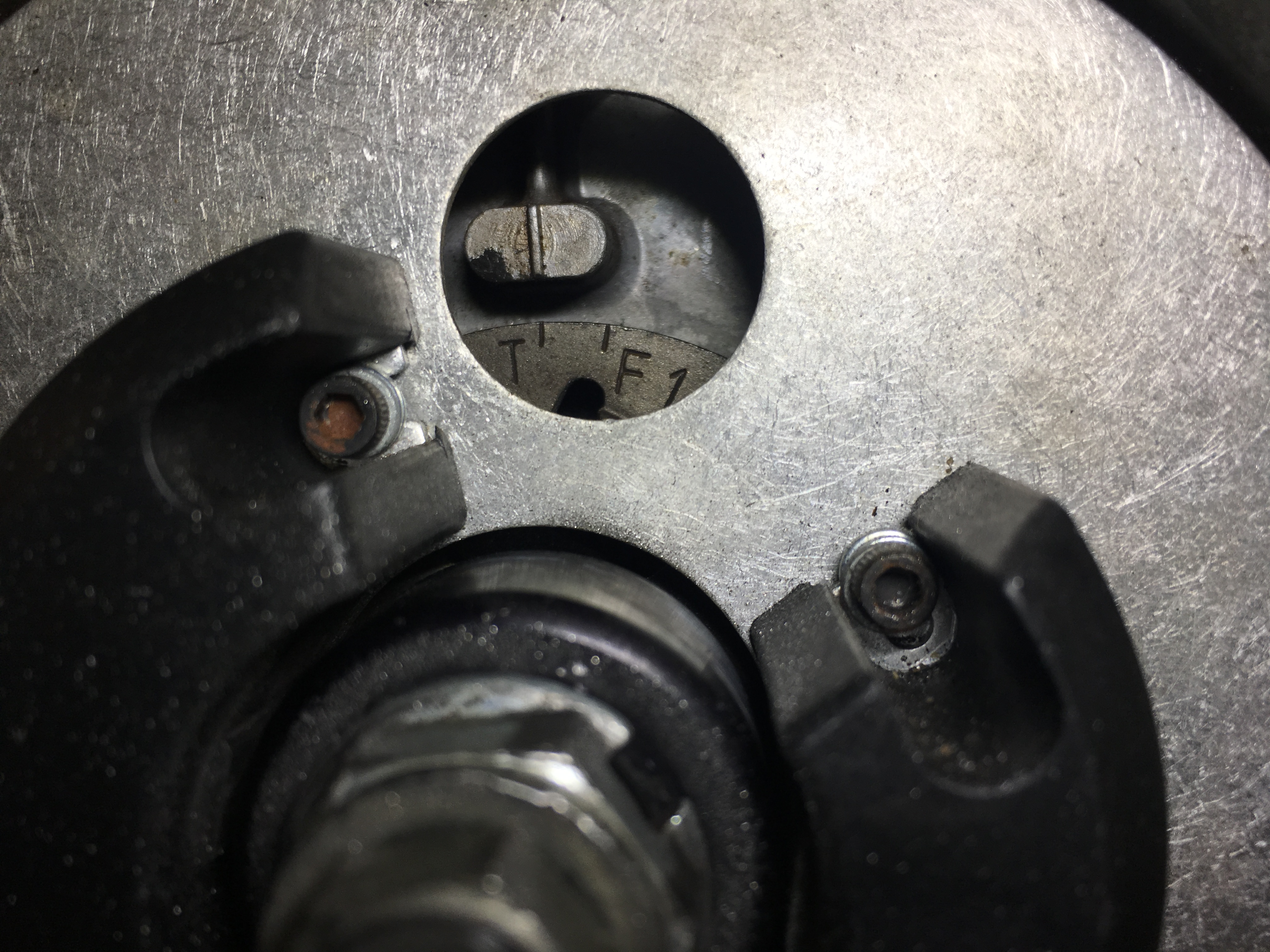

I am running a dyna s,with mechanical advance & Dyna coils
All was running perfectly prior this issue.
I have just done a compression check & all 4 pots were 190psi with engine cold & wide open throttle.
So it doesn’t look to be valve issue or piston rings?
I’m stumped.
What else would cause precognition?
I’m stumped.
Zed til Dead
Have you checked the ignition timing and that the advance is working and free? There's nothing else if the cam timing seems to be correct...

Getting the ignition timing checked out today, but I can’t even get it started , just doesn’t seem to be petrol getting into the Bores??
Confused
