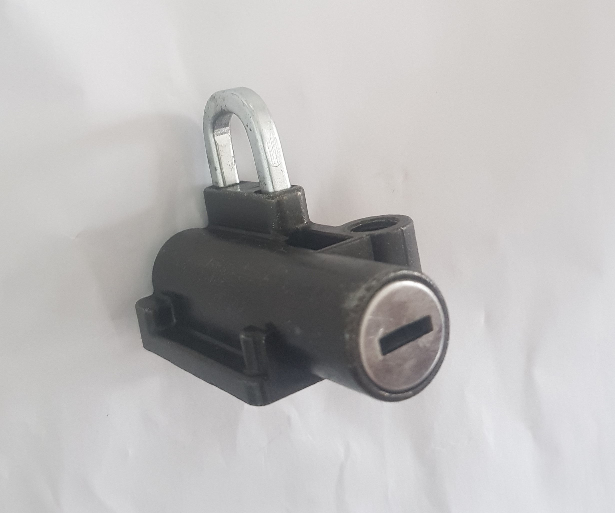

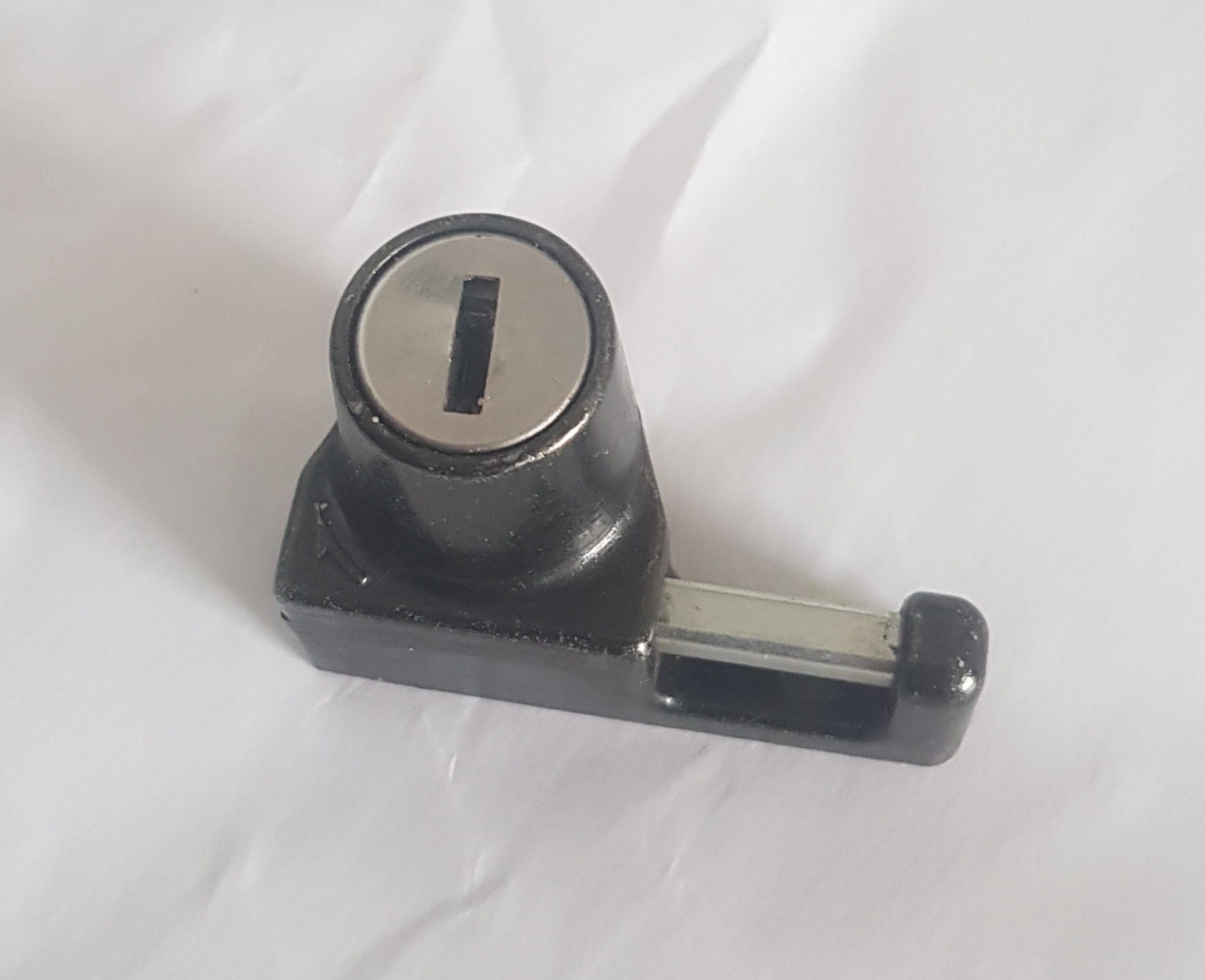

Re: Z1000R Helmet & Seat Lock

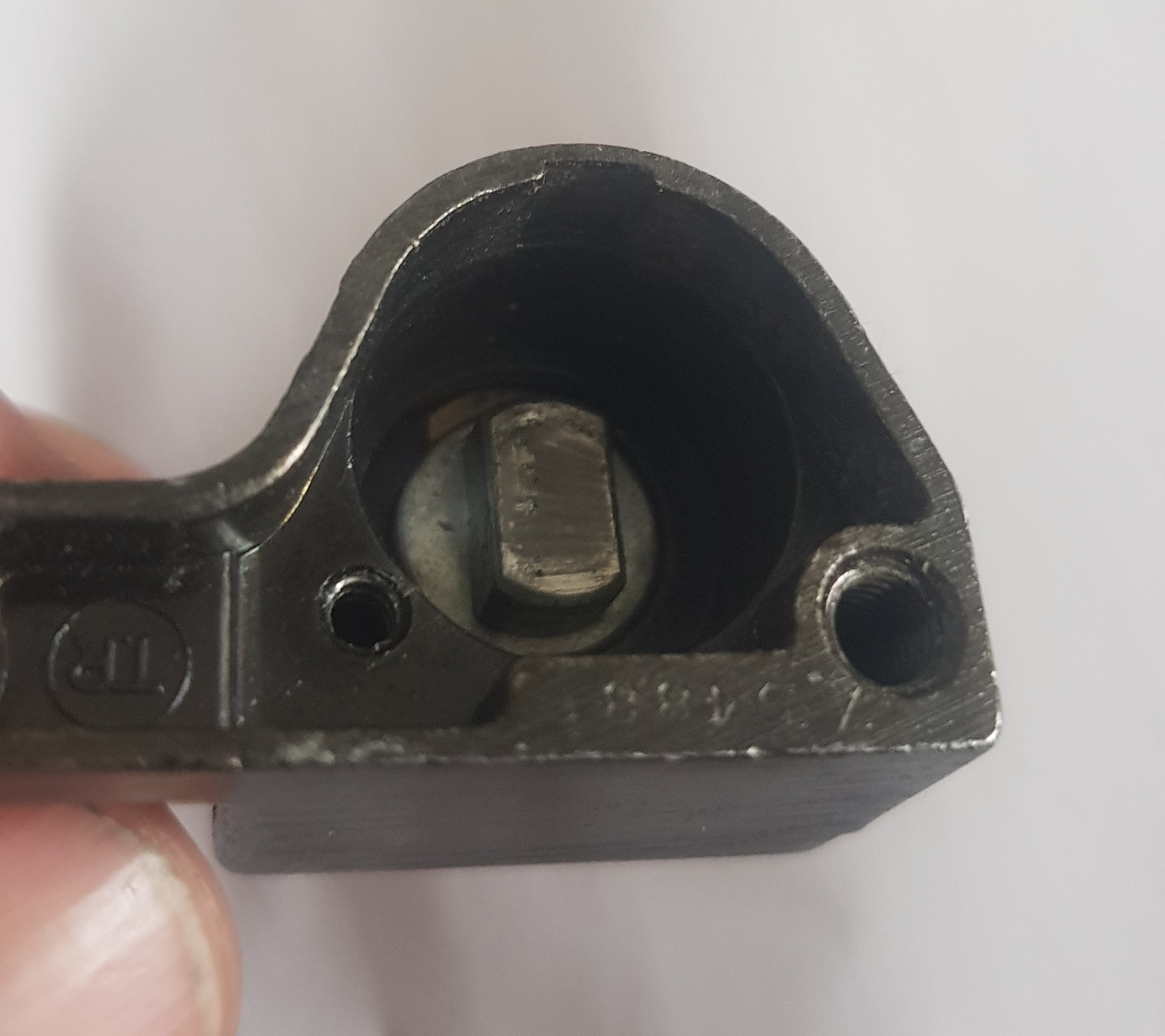

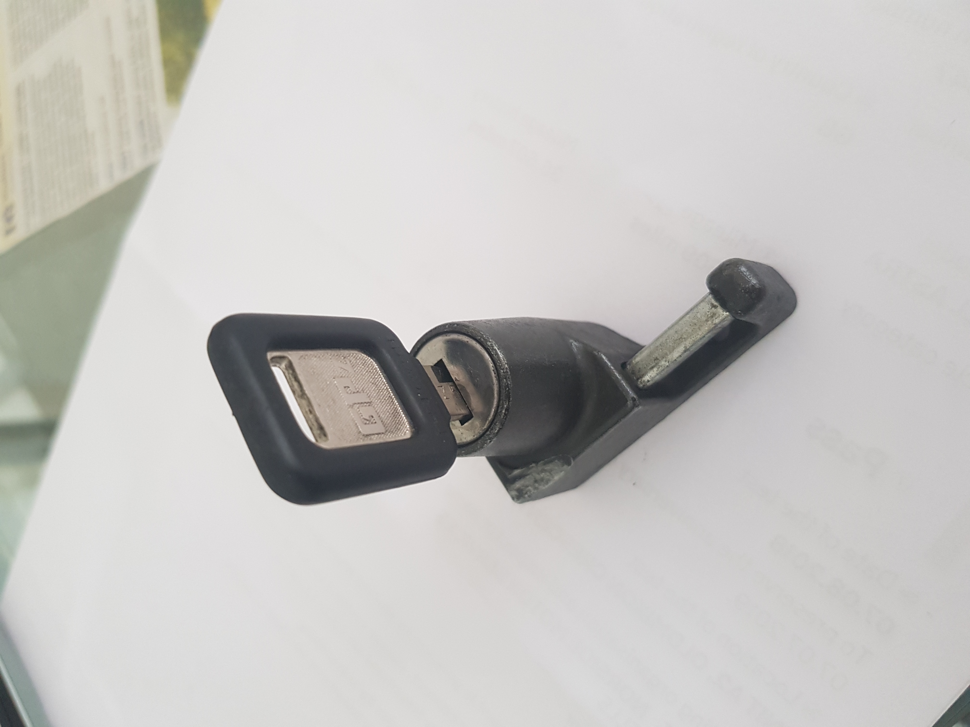

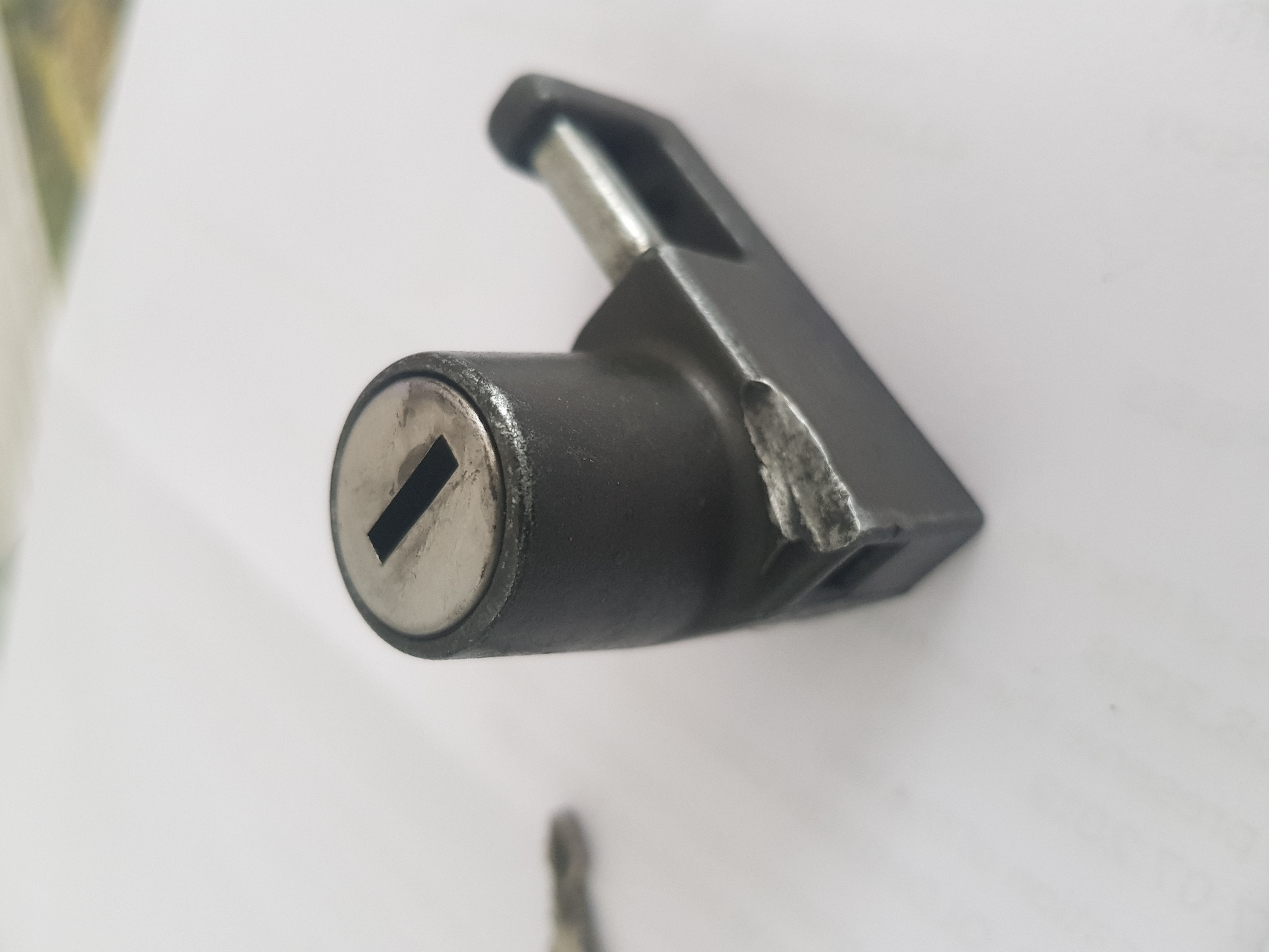

Good morning Philippe,
here's a few shots of the two locks:
Thanks, Mike
Thanks, Mike

Thanks for the help and the link but these barrels seem to be slightly harder to remove from the lock body. As can be seen from the addition foto the barrel is stopped from sliding forward by, what looks like, a wafer lock (slightly obscured brass coloured in the foto) and this also controls the quarter turn of the key but there is no way to remove the offending wafer.
As there's no evident pin on the outer holder to retain the barrel I'm thinking I have to remove the chrome key plate, which might hide the securing method. Unfortunately if not I'll then be wrecking the lock appearance

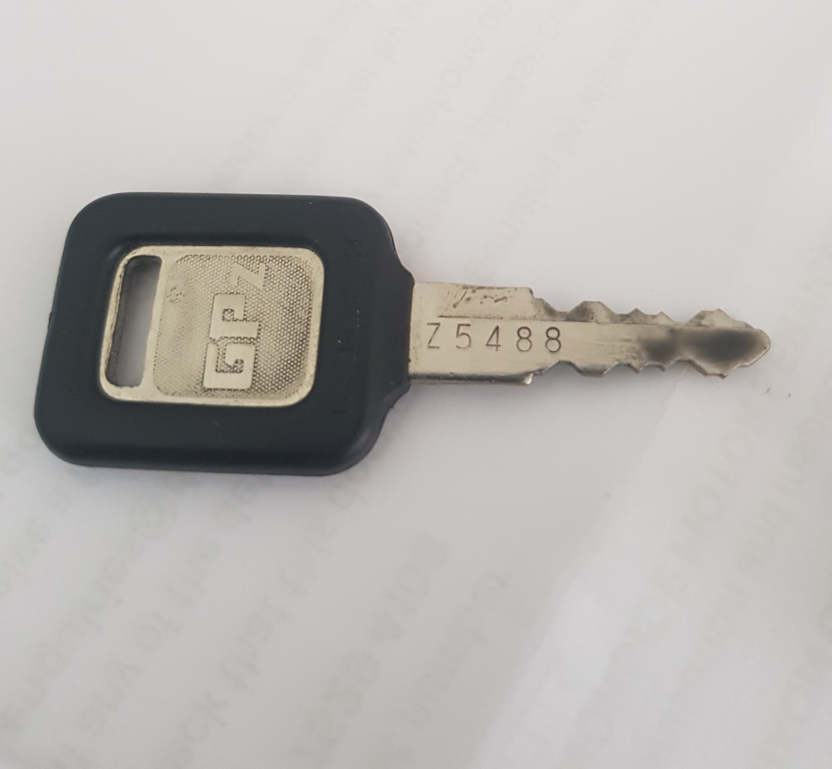

Yes thanks Mark, all sorted on 2 keys. It was the rear view that sorted it (ooow eeeer missus) with the red grease showing the same brass locking wafer. Just needed a blade to compress the little blighter and out popped the barrel.
I had some spare wafers from an old ignition switch that could be filed. I've got an old helmet lock that, now I know how to release the barrel, I can make to suit the Z5488 key I have leftover.
Hi Mike
just noticed that you allready got help from Mark! That's why there's a forum. We help eachother!
The other lock might be more difficult but the basics are the same. The hardest part is to get the barrel out.
Unscrew the back plate and find the retaining part to get the barrel out. Afterwards it's the same as the other lock.
I have no experience with the lock on the picture . Maybe someone else has...

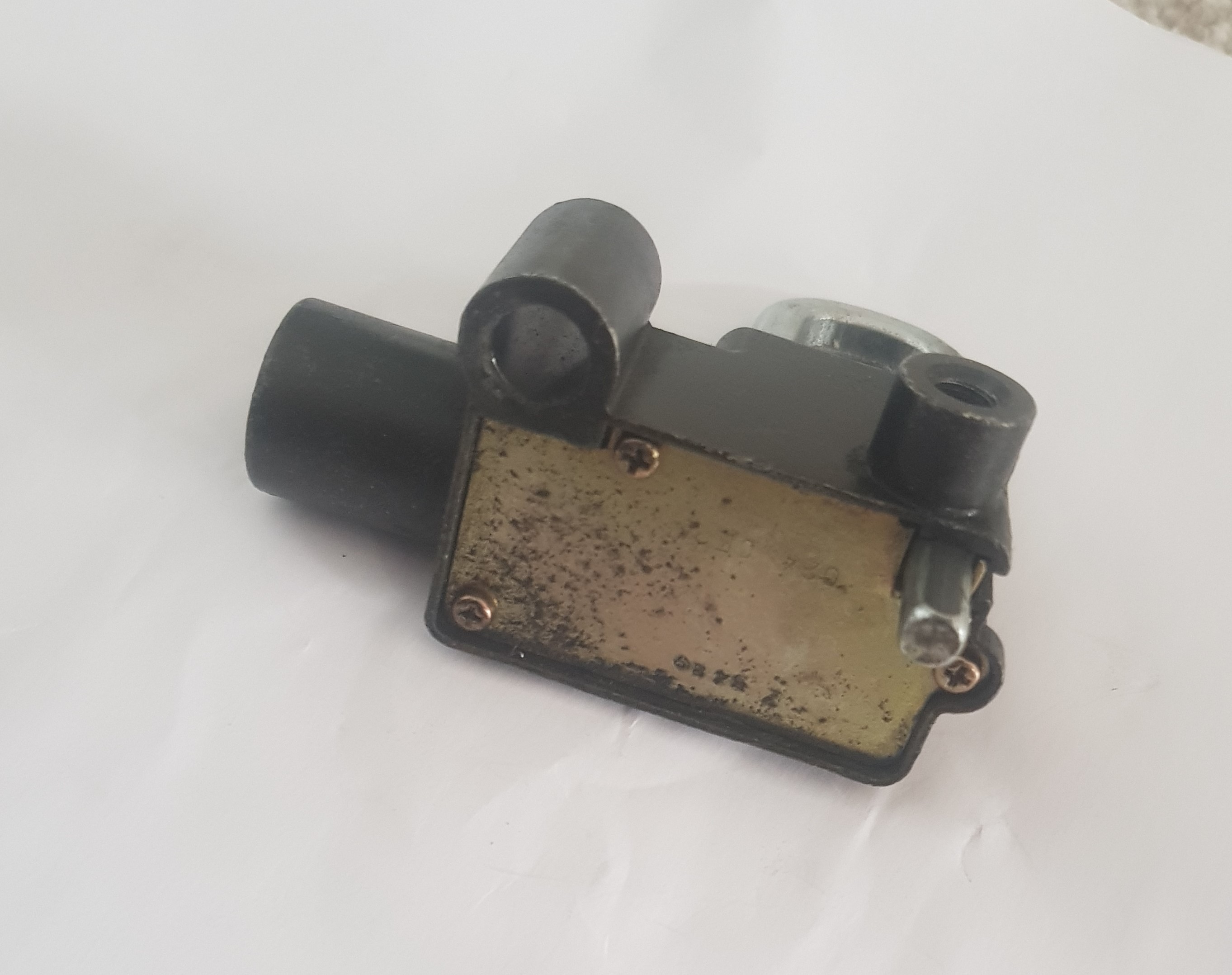

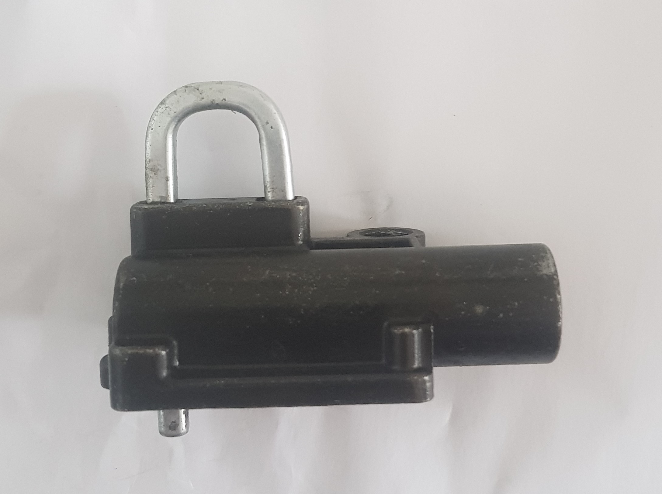

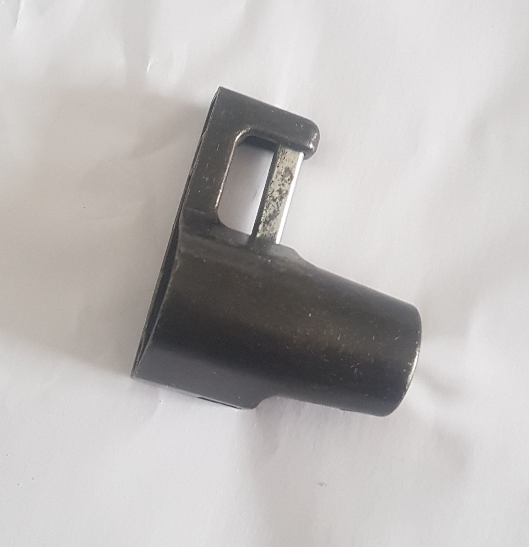

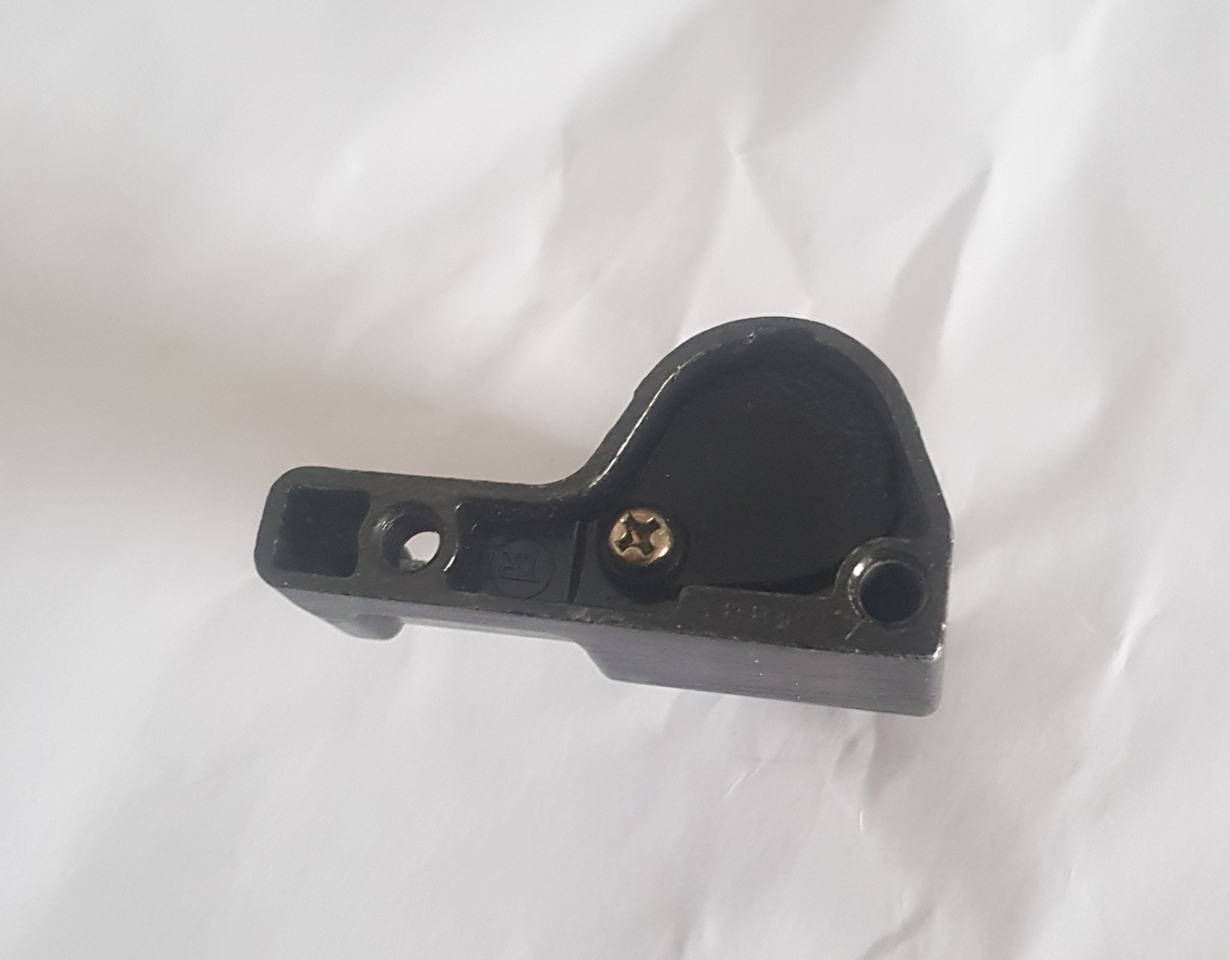

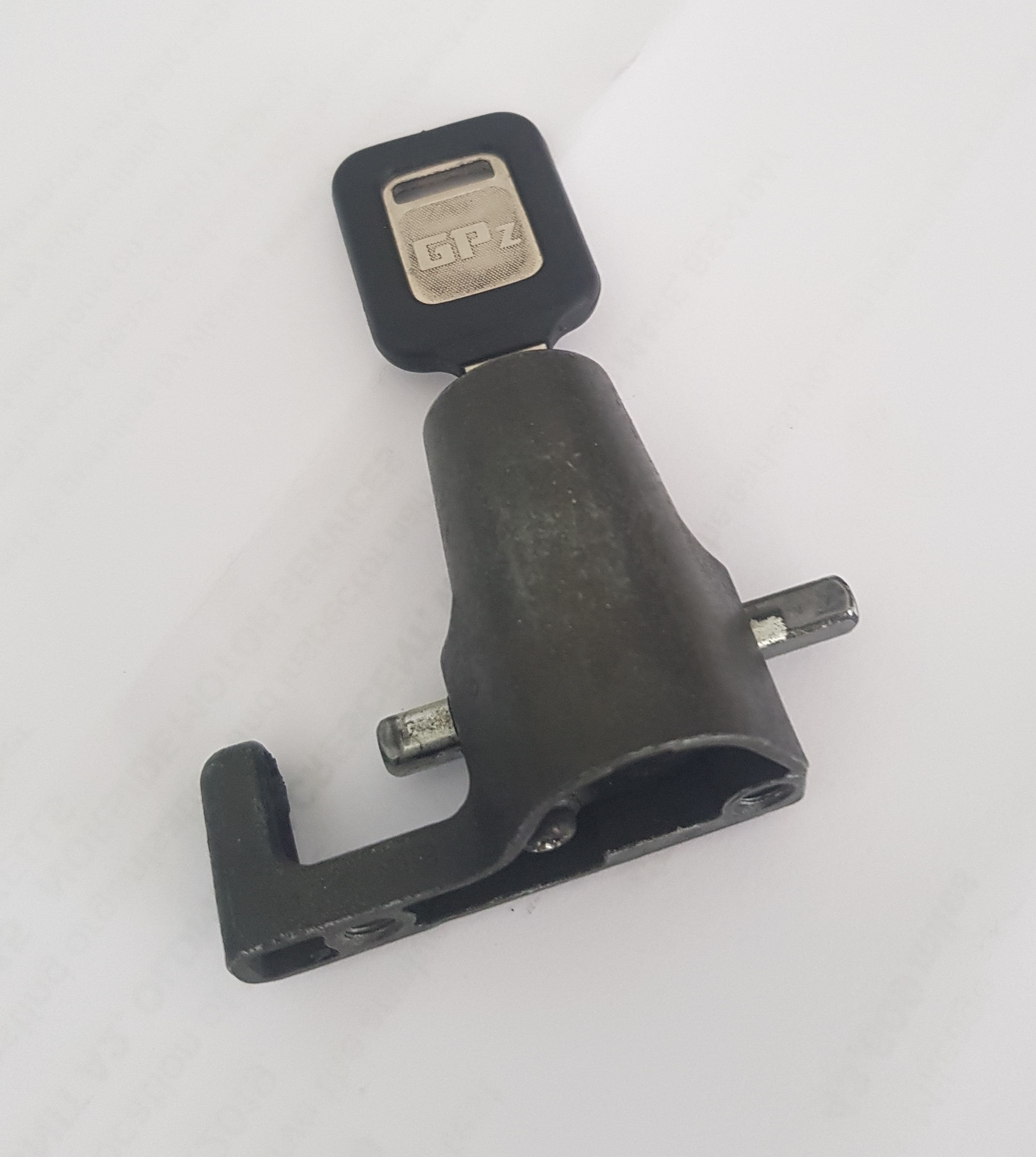

Anyone got one of those 1000R helmet locks surplus to requirements and they’d care to part with
chrisNI wrote:Anyone got one of those 1000R helmet locks surplus to requirements and they’d care to part with
I might have a spare, with a kwaki key, that I'd part with. I bought the new one photographed as I didn't know how to change the wafers.
I'll put a few fotos up if you're interested?
Here's a few extra piccies of the spare helmet lock
