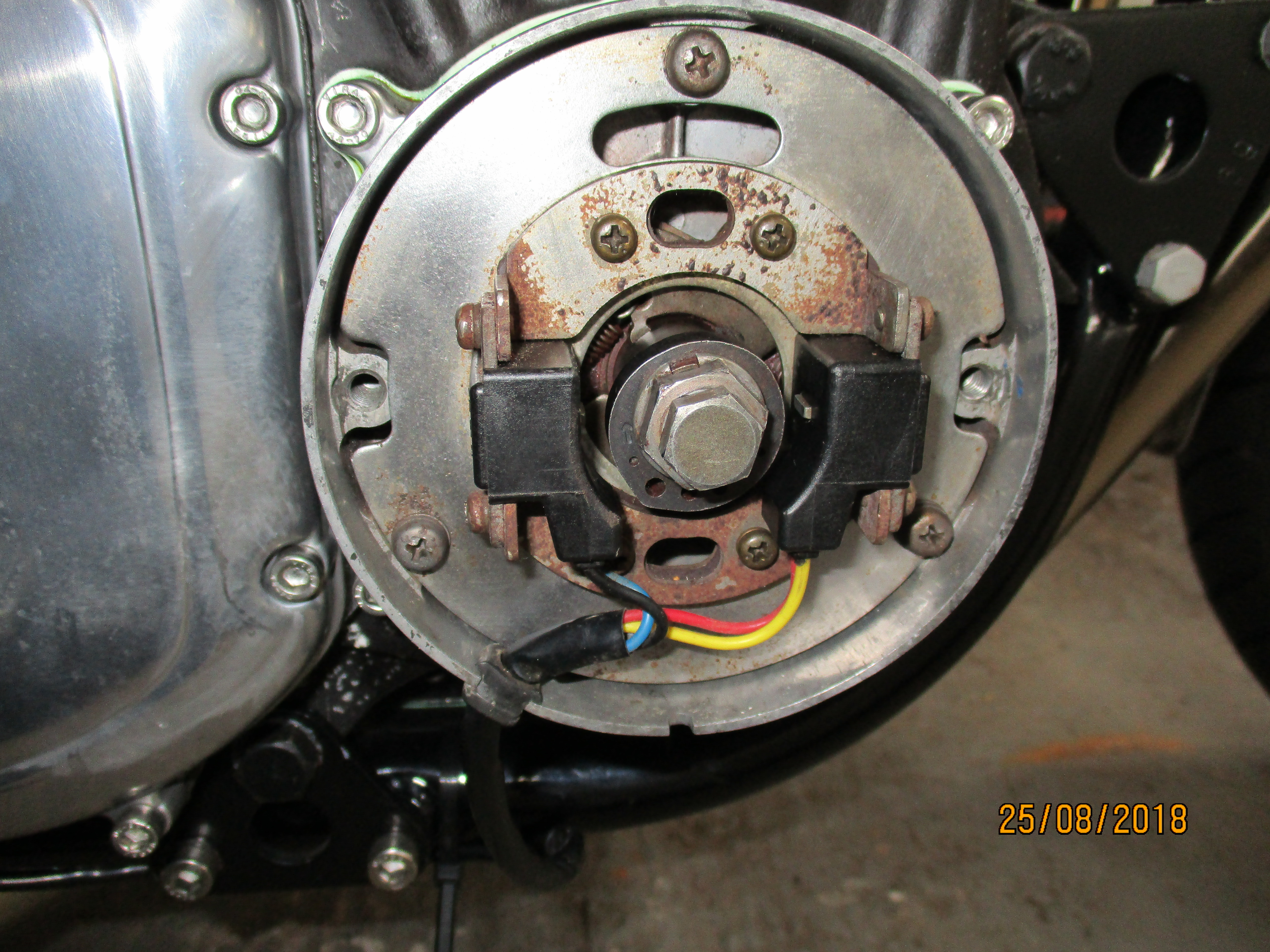

Also worth checking that the ignition cam/rotor is free to rotate, not sticking.

I have put new throttle cables on and resealed the in let rubbers. I checked the ignition cam rotor and the bolt was loose. The bike is going for an mot re test tomorrow, i am hoping this is the problem.

I still have the problem of the revs holding at 3000 RPM, decelerating whilst riding. The ignition rotor was loose, i have tightened this. there is an noticeable improvement in that the revs hold at 3000rpm and not 5000rpm.

remove the timing advancer, disassemble it, clean out the old grease, clean it again, put new heat resistant grease inside and reassemble. Tighten the mounting bolt to 2,5 kg-m (18,0 ft-lbs) of torcque. Things might be better...if not, you can be sure that the timing advancer is not the cause.
