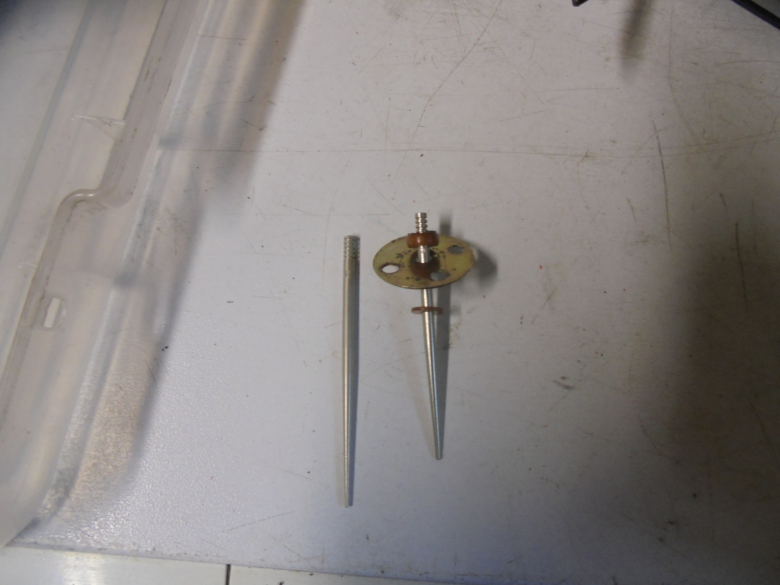

Replacing the needles ,My plan is to put z1000a1 needles in my a2 as a2 is leaned out stock . photo shows , new A1 stock on left , Question as seems to be a great difference see needle on left ,lot shorter with them bits on as well , and there is a spring in the throttle valve .
Can i just leave of all the gumf , or do i need to change the throttle valves and needle jets ??

Ps , if you bought a carb repair kit , they seem to be all the same 77-81 , just worried about the throttle valve and the difference with spring in etc , alternately , ive jetted up main and pilot jet , shall i just leave be the stock a2a needles and valves ? my reason for changing , was the a1 needles are not so lean

A1 used 5CN8 & A2 used 5DL31. Both should be 57.4 mm according to my Mikuni data

Hi ZEDHEAD , Thanks for answering , Mine is an A2A needle measures 52mm , was the above setup , where the needle goes through a spring in a recessed hole in the throttle valve from the top , better or worse

ZedHead wrote:A1 used 5CN8 & A2 used 5DL31. Both should be 57.4 mm according to my Mikuni data
any reference to 5CN7-4 dave? the a2a factory manual lists this part number (usa lean carburetion system for emission control) m.

#6 PostAuthor: ZedHead » Sat Apr 06, 2019 4:52 pm
Yes, it is only 51mm long. Which suggests they were completely different carbs. I am not familiar with the variations. Pumpers maybe?

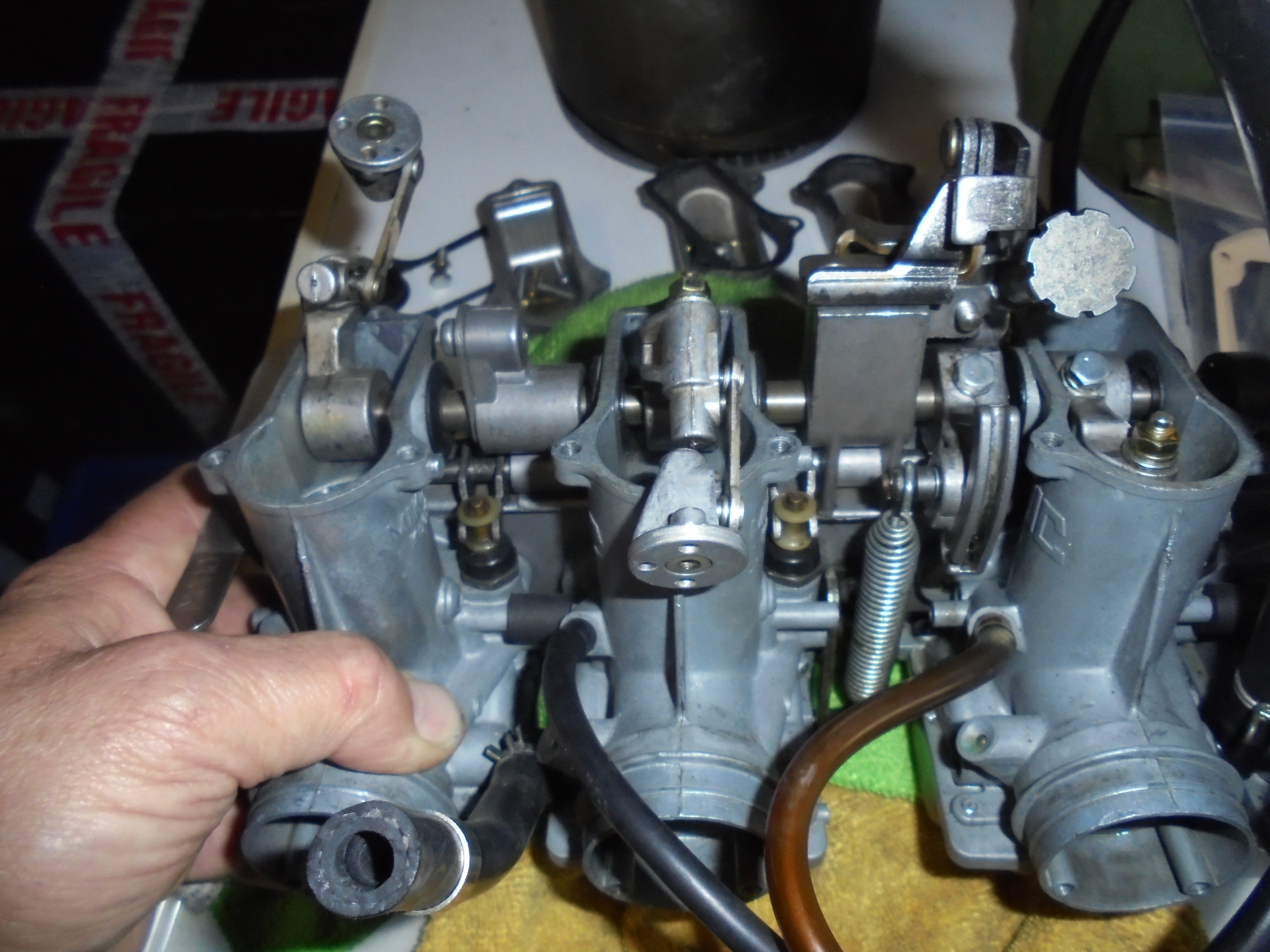

#7 PostAuthor: snowyz9 » Sat Apr 06, 2019 5:25 pm
except jets carbs seem the same

#8 PostAuthor: snowyz9 » Sat Apr 06, 2019 5:32 pm
a photo of

#9 PostAuthor: 8 Valve Mark » Sat Apr 06, 2019 5:47 pm
your right ian, they're the same apart from the needles n jetting. it seems like you might have to track the usa part down..
dave, the 28mm pumpers have 5CN17-3 listed..

Getting closer then, I think the only challenge will be finding a matching emulsion tube.

On further looking , dont the lifters look different , top left photo

#12 PostAuthor: ZedHead » Sat Apr 06, 2019 6:20 pm
Yes, Do you need to change the needle?
