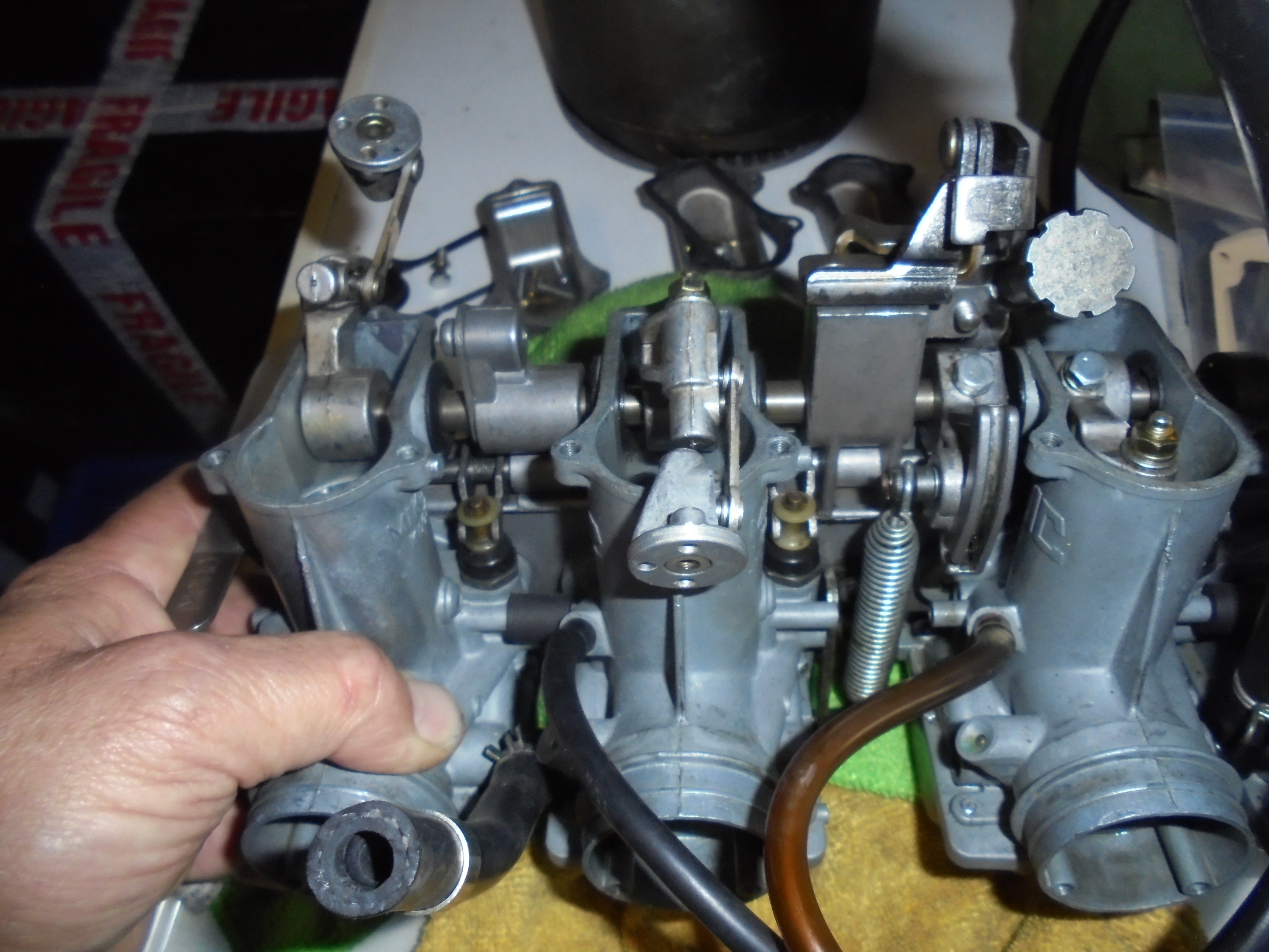

Replacing the needles ,My plan is to put z1000a1 needles in my a2 as a2 is leaned out stock . photo shows , new A1 stock on left , Question as seems to be a great difference see needle on left ,lot shorter with them bits on as well , and there is a spring in the throttle valve .
Can i just leave of all the gumf , or do i need to change the throttle valves and needle jets ??

Ps , if you bought a carb repair kit , they seem to be all the same 77-81 , just worried about the throttle valve and the difference with spring in etc , alternately , ive jetted up main and pilot jet , shall i just leave be the stock a2a needles and valves ? my reason for changing , was the a1 needles are not so lean

Hi ZEDHEAD , Thanks for answering , Mine is an A2A needle measures 52mm , was the above setup , where the needle goes through a spring in a recessed hole in the throttle valve from the top , better or worse

#7 PostAuthor: snowyz9 » Sat Apr 06, 2019 5:25 pm
except jets carbs seem the same

#8 PostAuthor: snowyz9 » Sat Apr 06, 2019 5:32 pm
a photo of

#9 PostAuthor: 8 Valve Mark » Sat Apr 06, 2019 5:47 pm
your right ian, they're the same apart from the needles n jetting. it seems like you might have to track the usa part down..
dave, the 28mm pumpers have 5CN17-3 listed..

Getting closer then, I think the only challenge will be finding a matching emulsion tube.

#11 PostAuthor: snowyz9 » Sat Apr 06, 2019 6:03 pm
On further looking , dont the lifters look different , top left photo

#12 PostAuthor: ZedHead » Sat Apr 06, 2019 6:20 pm
Yes, Do you need to change the needle?

#13 PostAuthor: snowyz9 » Sat Apr 06, 2019 6:26 pm
Not really , just had the idea of putting a1 needles in , the throttle valves are 2.0 , A1 and maybe A2 are 1.5 , are these carbs power sucking with them needles ? if so , would i be better off buying different carbs

#14 PostAuthor: ZedHead » Sat Apr 06, 2019 6:40 pm
snowyz9 wrote:Not really , just had the idea of putting a1 needles in , the throttle valves are 2.0 , A1 and maybe A2 are 1.5 , are these carbs power sucking with them needles ? if so , would i be better off buying different carbs
Haha definitely buy new carbs. I know a man that can :lol:

#15 PostAuthor: ZedHead » Sun Apr 07, 2019 10:00 am
There is little difference in taper between 5CN7 and 5CN8, just the length.
Without teaching granny to suck eggs, Power loss could have many causes. It would be useful to know more about your bike. How much is stock. bore, valves, exhaust, air filter etc ....
Have you taken some spark plug readings at different rev ranges?
