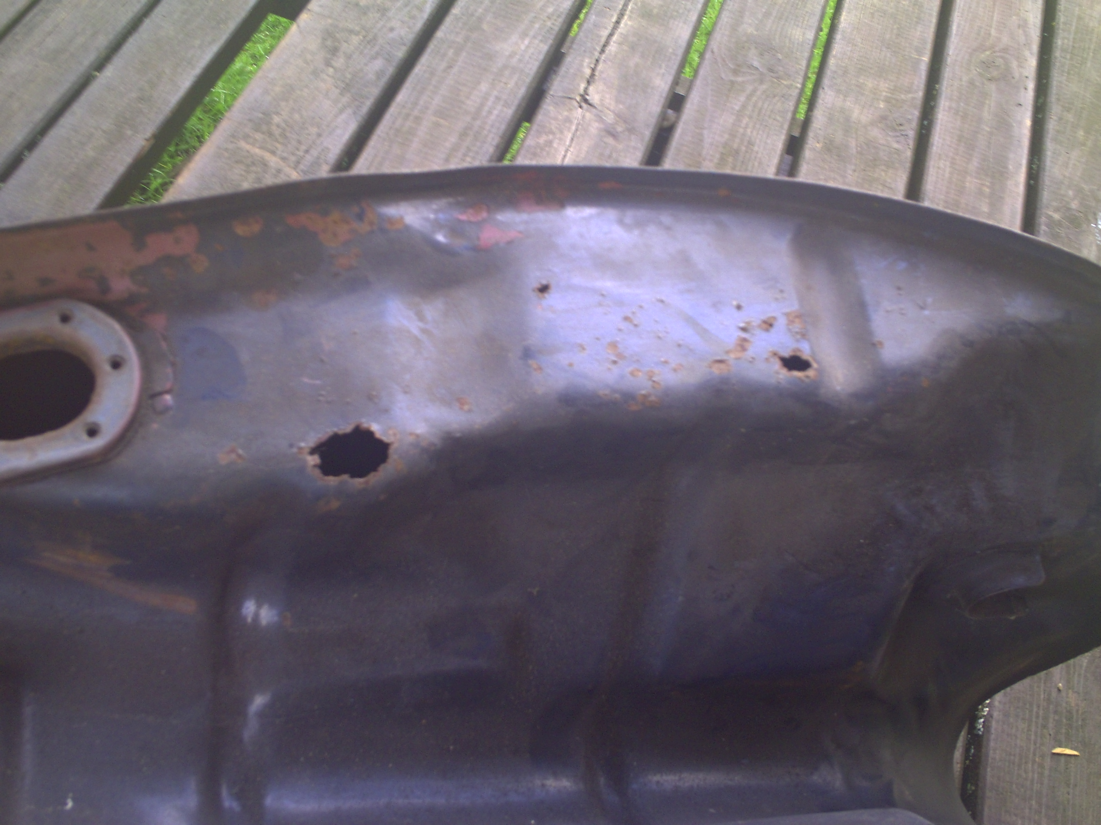

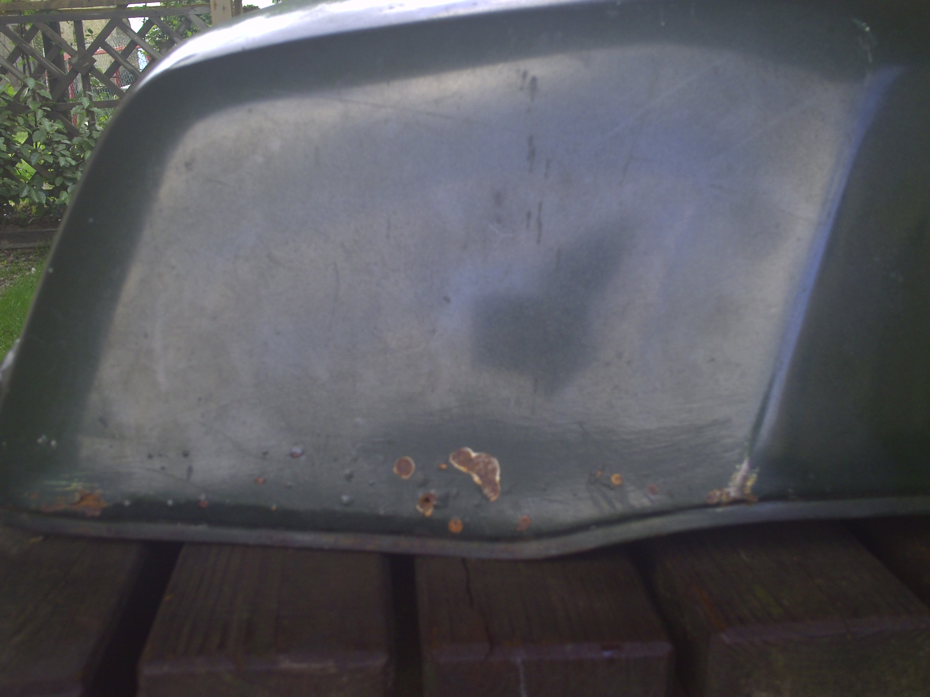

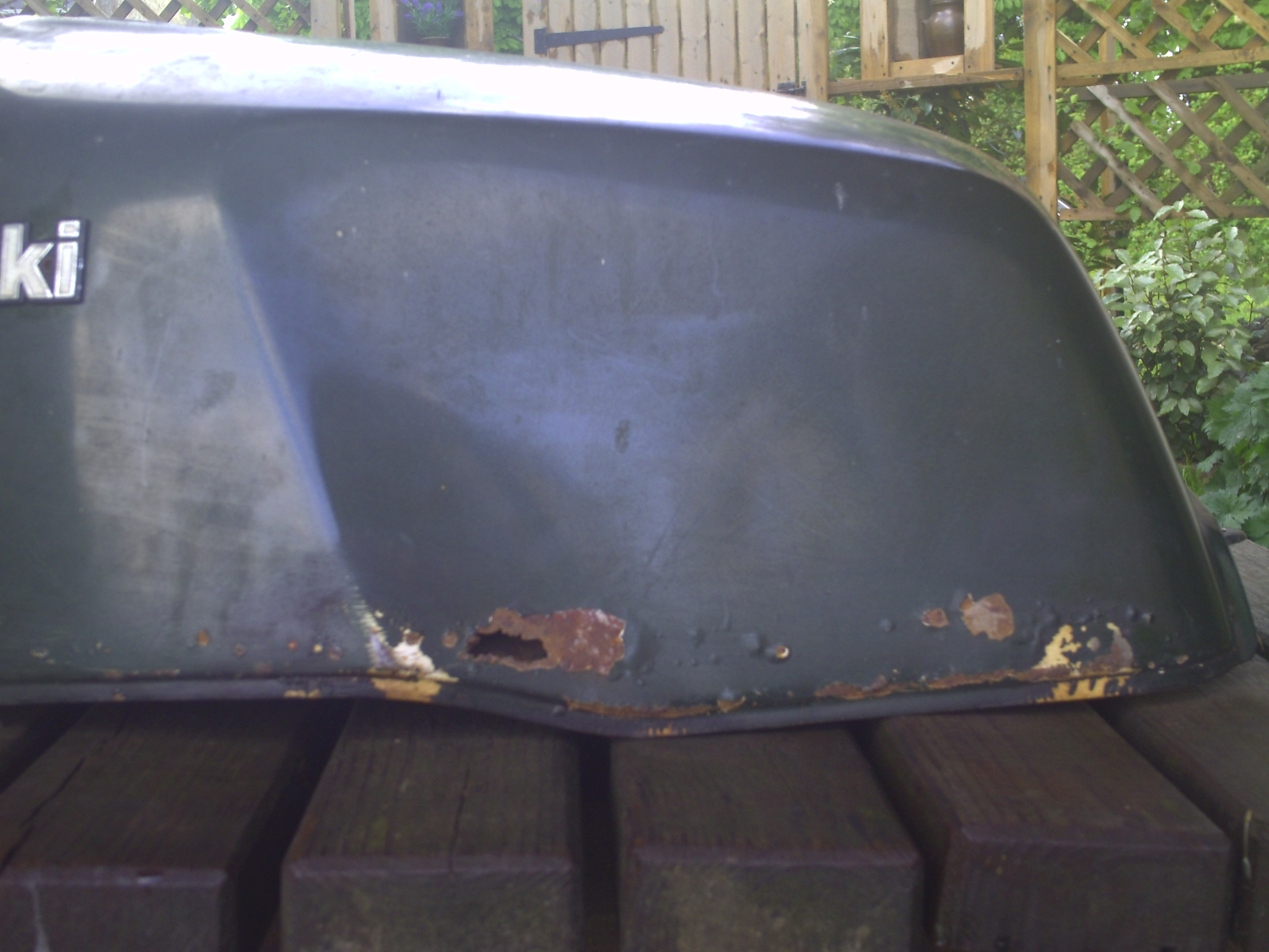

I've got a couple of rust holes in the tank.
I've been told that 'Quiksteel' can repair these if the metal around them is prepared correctly.
Is this true or is there a better method or is it past it?
My plan was to repair the holes then put a resin in the tank. Which resins are best?
I need to clean the inside of the tank due to loose rust etc. prior to repair and resin and was thinking of using diluted Hydrochloric / Muriatic Acid followed be baking soda to neutralise it.
Are my plans feasible or am I relieving myself facing an oncoming gale?
Thanks very much in advance for any suggestions / corrections.

Any sort of chemical metal is a bodge and WILL fail sooner or later.
Probably sooner.
The only fix is by a skilled welder.
Oxy/acet or Tig is the only way to go.
If repaired correctly any sort of tank liner will not be needed and I personally avoid it like the plague.

I would find a better tank,as zed1015 says anything short of a proper repair is asking for trouble

moizeau wrote:I've got a couple of rust holes in the tank.
The biggest concern is that where the rust has come through and formed a hole is the tip of the iceberg and the surrounding metal is at the "very nearly a hole" stage, This makes a repair very difficult as you need to attach your repair, whatever that is, be it chemical metal, or welded sections, to good metal. Even if you do that around the holes you do not know if there is another part of the tank that will very soon go the same way. A good liner should cure that, and they do work, BUT it is a process that needs the instructions followed absolutely religiously to the exact letter, which, when it comes to how clean, dry etc the inside of the tank is, is very difficult, nigh on impossible to be certain of.

id look for a better one for deffo

Mark, Neil, thanks. I am concerned also with the iceberg theory. I think it needs a new one but in the meantime if it's buggered then no harm giving it a fine sand blast, that'll show me how far it's gone. Then if it is knackered I can bodge it to do the tests on the bike whilst searching for another.
