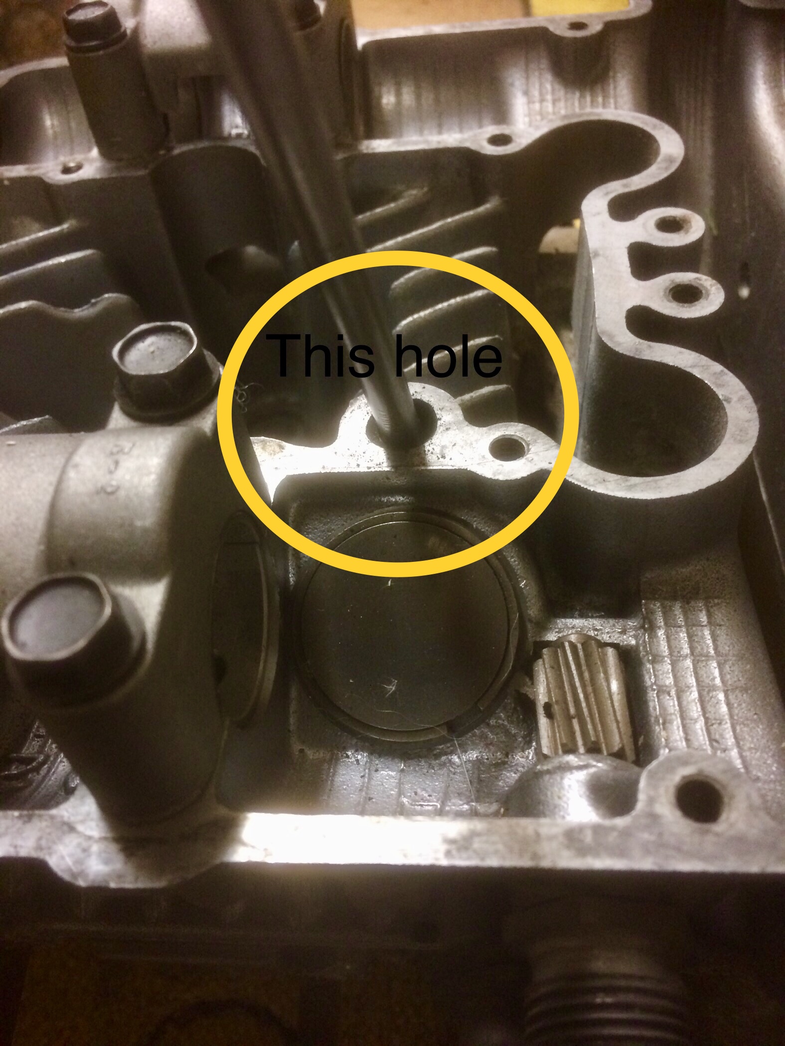

Hello all, can anyone tell me, do I need to blank these drillings off they are on a 1980 Ltd engine I am going to fit an older round cam cover without the breather pipes and do away with the emissions crap. Thanks. Sean.

Tap them M10 and plug them with grub screws.

Be careful not to let any swarf get near the valves!
