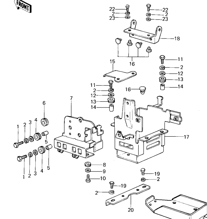

Hi all
See graphic - I'm missing parts 15 and 20. Anyone got a photo of how they fit together on the bike? Or can someone take a photo if they have a standard Z1000A1? The parts manual doesn't really help and I got the bike already dismantled, with a few bits missing. Haven't been able to find a really good pic of this online (I've seen some Z1 ones but they're a bit different).

No. 20 fits at the bottom and to the rear of the battery box, it bolts to the frame

Recently had the battery box powder coated and don’t recall 15 being part of it.. the tool holder is pictured in this schematic and is not part of it either, could the part be elsewhere?
Think 20 bolted to the frame as a bracket to mount the box to...

Using bolt 11, 15 sits on top of the rubber grommets that secure 17 to 20. 20 blots to the frame.

popsA1 wrote:Using bolt 11, 15 sits on top of the rubber grommets that secure 17 to 20. 20 blots to the frame.
So 15 is a clamp ? I have 18 as a clamp

Doesn't 15 support the air box?

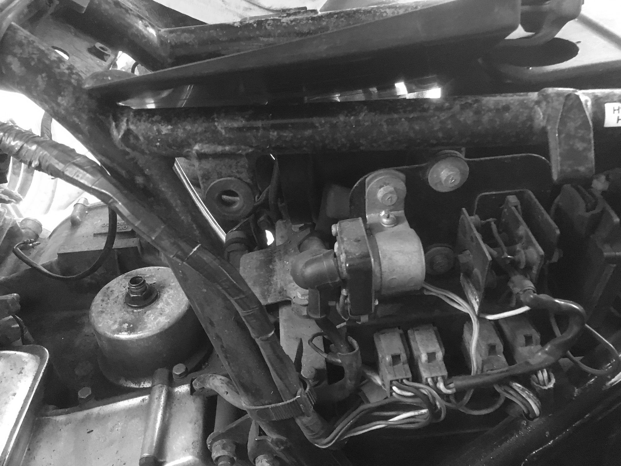

I can’t see 15 at all 20 I think is a mounting bracket to which you bolt the front of the battery tray
You can just see the 20 securing bolt in the second photo between the air intake and the negative battery lead

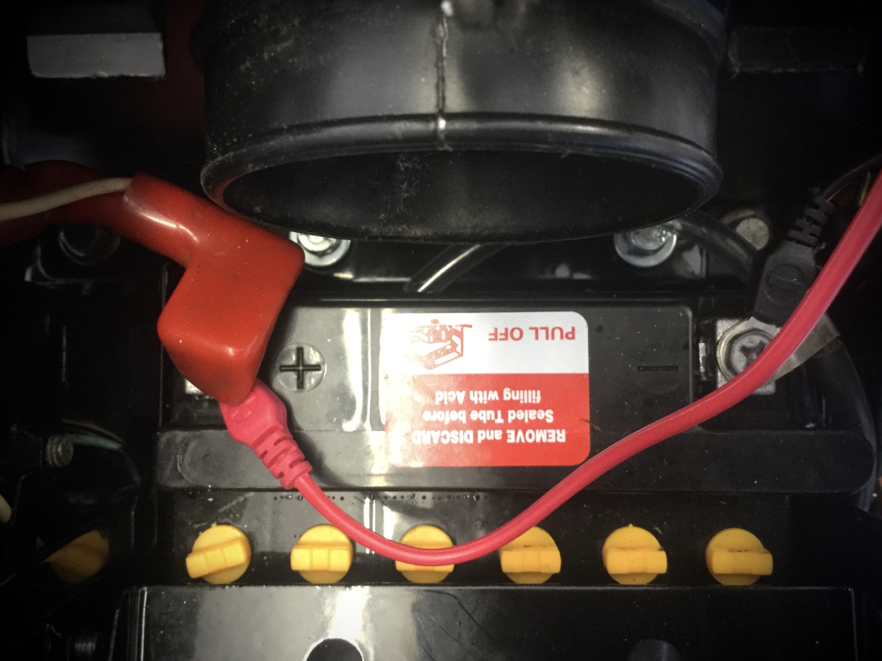

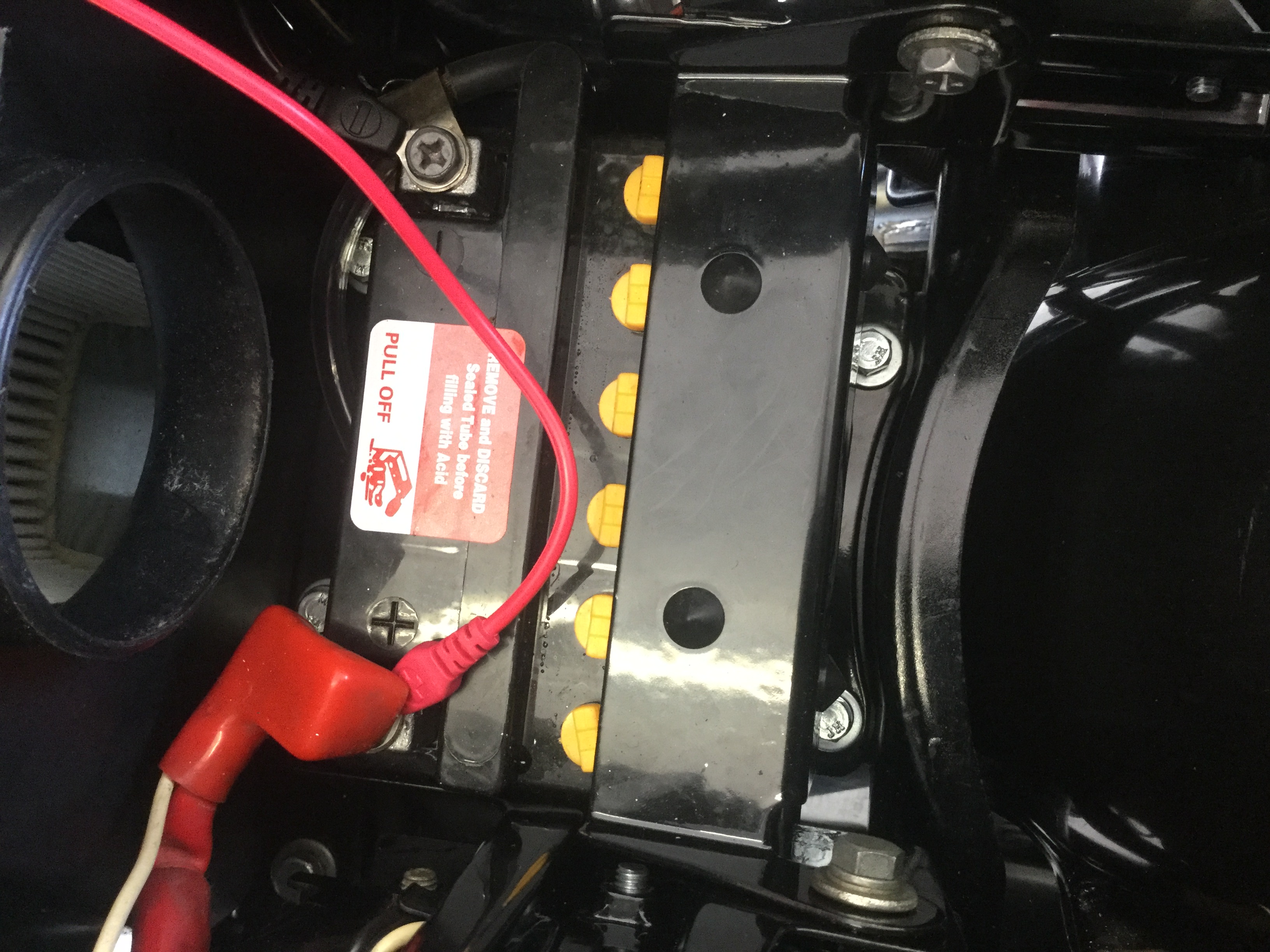

Just checked mine, I don’t have a 15, but there is room for it under the air box, not sure what it does though.. 20 and 15 seem sorted , 18 can be seen in my first picture securing the battery down... Not sure what you mean about securing 20 down, you can see the top of one of the two bolts securing it down in my second pic.. two bright battery tray bolt downs and between the air box inlet and battery earth cable on of the fixing bolts
