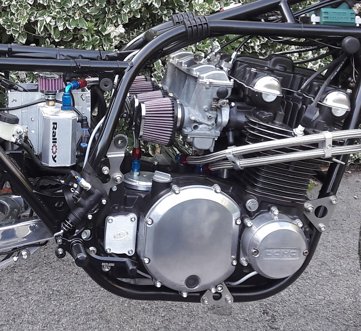

I used an oil catch tank with small filter as per the photo. Filter came via Zpower and used APE crankcase breather.

Wow, that's a beautifully engineered solution - nice. Probably a bit OTT for me though. :oops:
