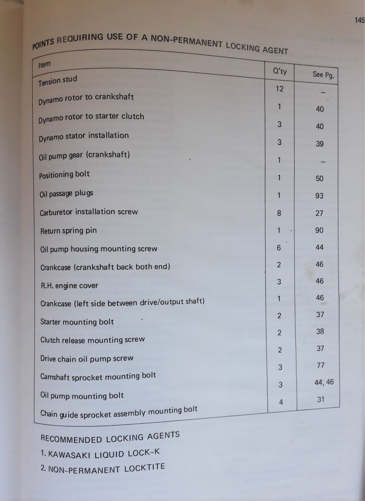

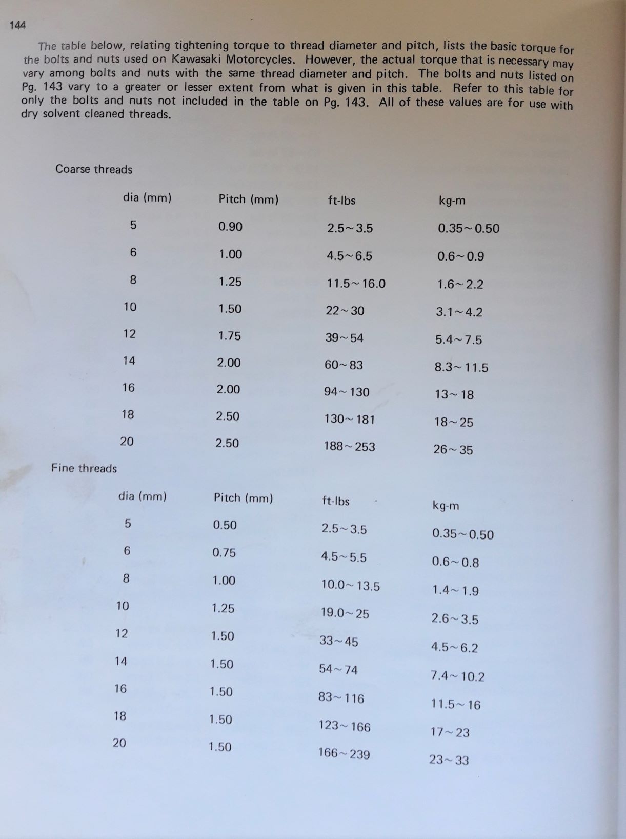

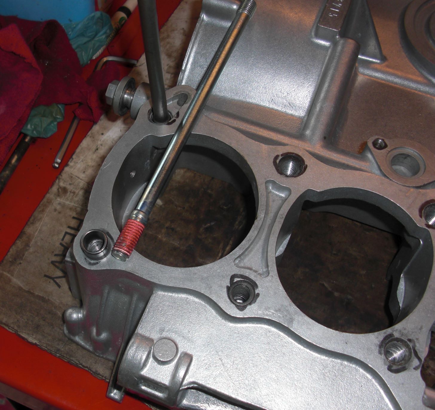

I fitted some new studs a few years ago and they came pre-coated with locking red sealant as per the photo. With regards to the torque, I'm not sure what I used and can't see any given in the Kawasaki manual. However it does give general torque figures based on thread diameter and pitch, see attached photos.

Hi thanks for the info. I've just checked my studs and they are pre coated similar to yours. The torque setting is handy too. Thanks again.

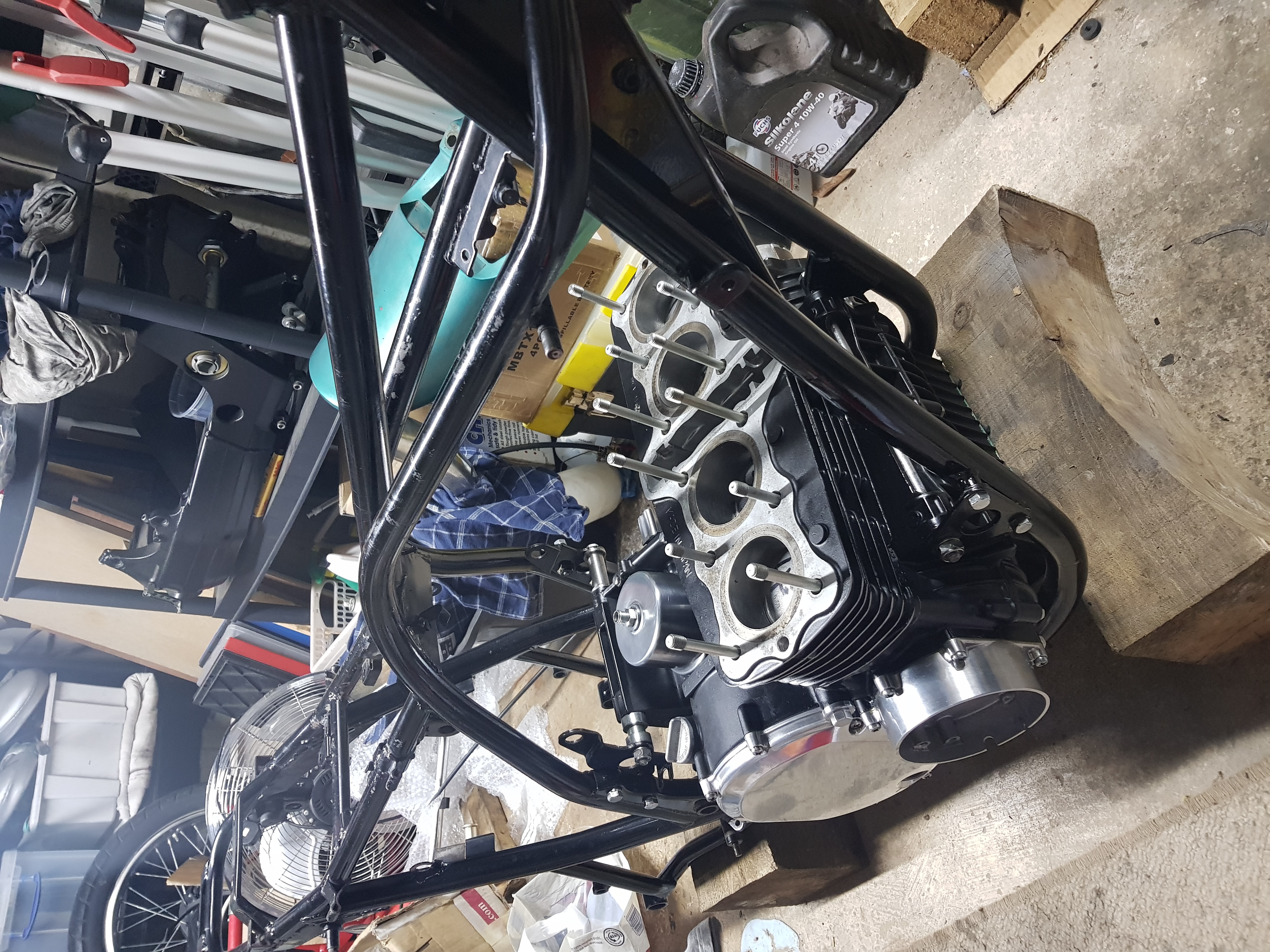

#11 PostAuthor: davidcouzens » Sun Apr 26, 2020 9:34 pm
Hi All
thanks for the help, in the end i bottomed out the studs and measured them referencing another engine i have in the shed. i shall know how it went when i pop the head on and measure the thread length poking out. should be ok i think. Also i used an old head nut with a ball bearing inserted to wind them in and worked well this tip I found in here so thanks again.
