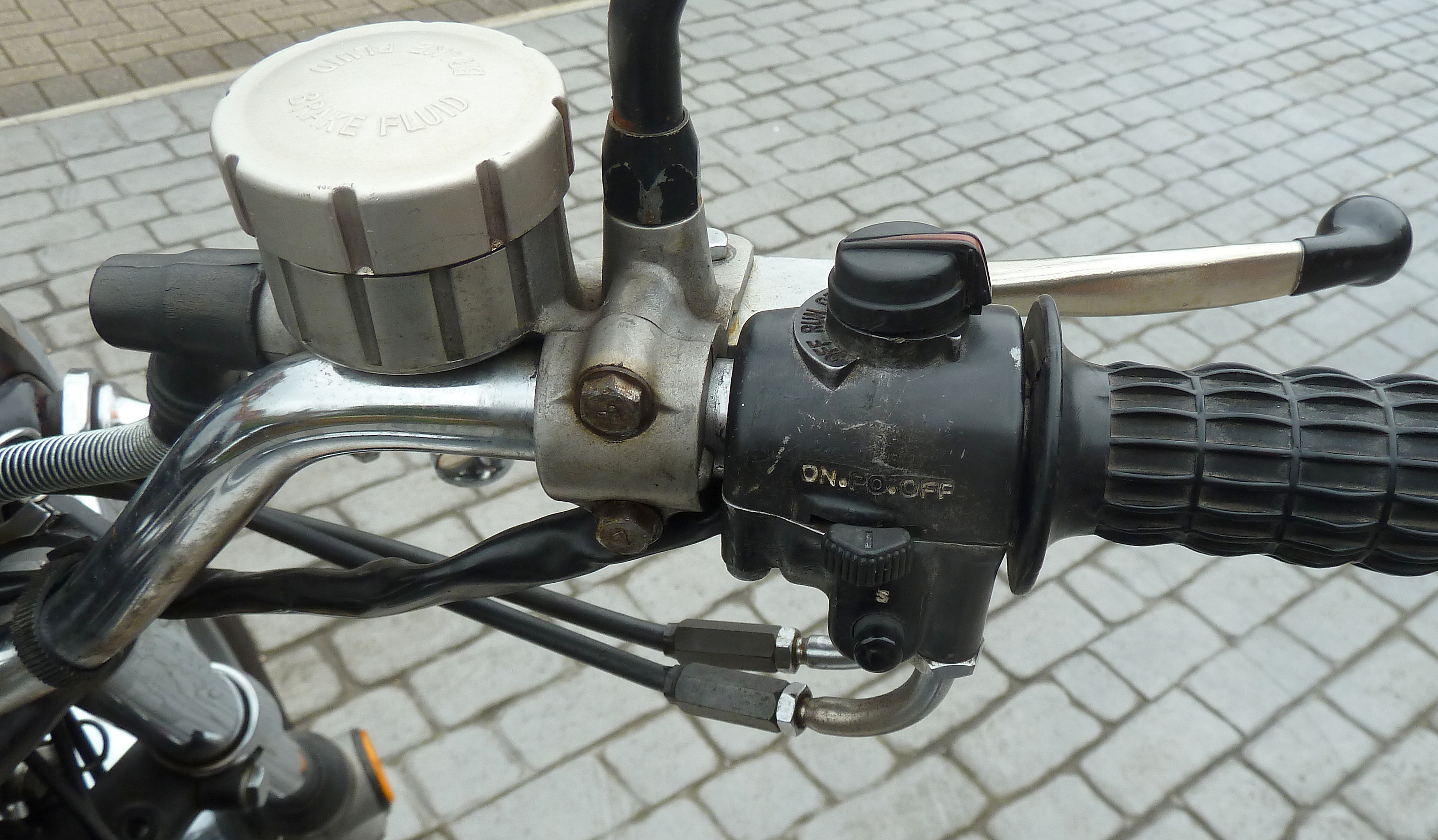

the bar mounted brake master cylinder on my 1973 Z1 is grey, is this correct or is the satin black worn off?

Pretty sure it should be satin black.

the original satin black can turn into a deep purple shade due to the sunlight. I'm not sure about the grey...

Phillippe is correct, original is satin black, then they fade to shade of purple then eventually grey when the sun exposure has been excessive as seen here..

Yep, thats the colour of mine, suppose I better paint it.

Don't paint it, get it re-anodised
Mark Hutton did offer the service.He will also rebuild the internals if it's any good and worth saving

I'm pretty sure the master cylinder has to be stripped of internal/external parts prior to the anodising process as it involves heat.He will apply the same process to the 3 way brake splitter too.

Word of warning..... I had one re-anodised a few years back but the finish came out too glossy.
Once it has been de-anodised there are 2 options. Polish or leave alone. If you polish the final finish will be glossy or if you leave it the final finish will be too matte. The only way to get a satin finish is to find NOS or re-paint :(

I've ordered some aluminium primer paint then I will try normal satin spray...could that work?

Stipulate satin black and as close to OEM finish.
