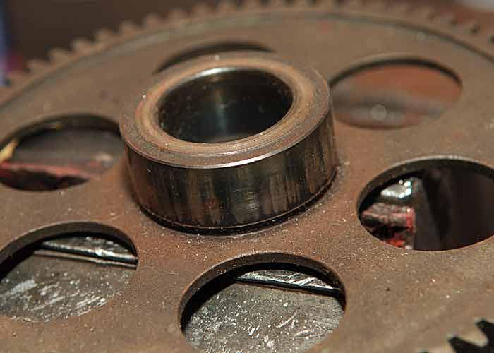

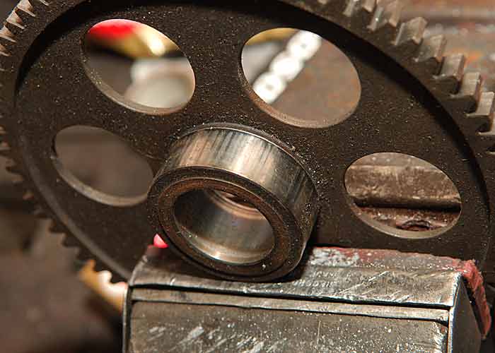

When my Z1000 was doing it it was a worn starter clutch boss, I got a good second hand one and it hasn't done it since. The wear on the boss was visible.

ChrisB wrote:Also thanks ChrisNI. How would the worn flywheel affect things? Is there a recommended measurement for the diameter on this? Doesn't seem to have much 'wobble' but it does have some. I could also whip off the flywheel from my good bike to measure any difference.
When the gear boss is worn it seems to jam when the barrel things spin out to grip it when starting and that puts more the stress on the taper.
