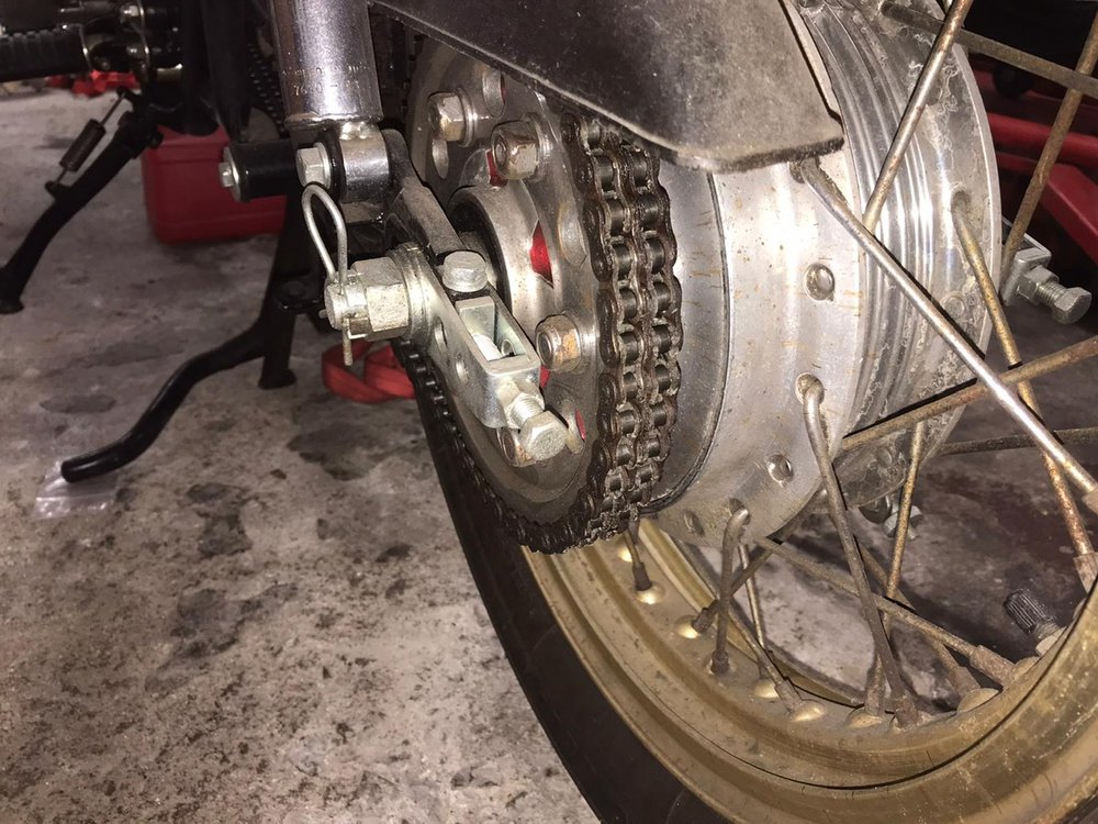

I only ever saw a series of photos of one bike, a Z900 which had a duplex chain fitted as its final drive. The write up said he had never had to adjust it. Never seen one since.

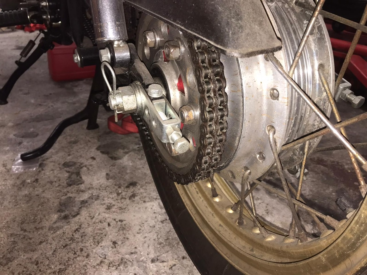

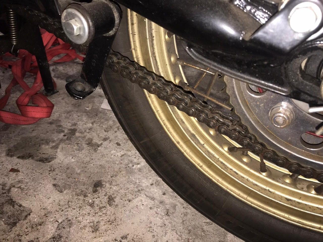

John0622 wrote:I only ever saw a series of photos of one bike, a Z900 which had a duplex chain fitted as its final drive. The write up said he had never had to adjust it. Never seen one since.
My brothers’s Z1B has a duplex chain it was on it when we got it and he never took it off - I’ll get him to take a pic.

Yes got a duplex chain on the well used Z1b on the new members mag. Not really adjusted it but maybe I’m being slack! Never seen another one

When Z1s first came out they were supposed to be too powerful for the chains that's also why early models had oil tanks. I guess this was a period solution :shock: Don't know who made them.

Be interesting to see what size/pitch chain links are - the std 630 is heavy enuff :??

You can still buy duplex and triplex roller chain for primary drives etc but those kits for bike final drives were a 70's gimic and no one makes them now.
