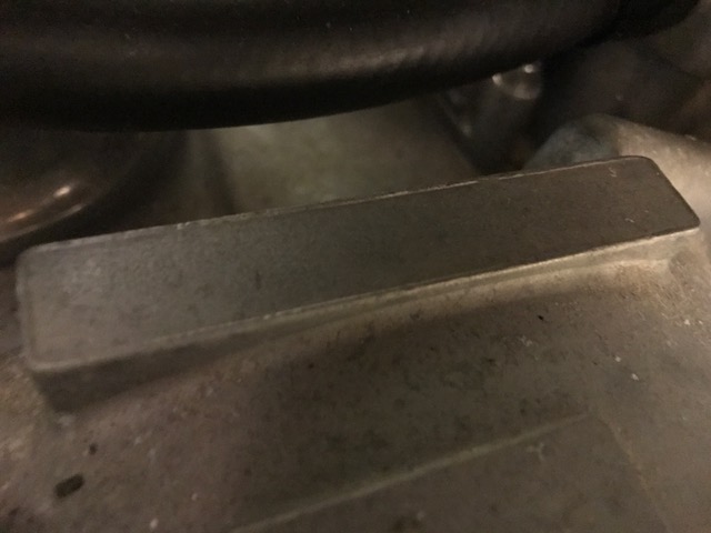

I found this on ebay just now - this is exactly how it looks .....

#9 PostAuthor: zed1015 » Wed May 20, 2020 8:40 pm
sharpeyie wrote:I found this on ebay just now - this is exactly how it looks .....
Numbers have been removed.
Only the early short number blocks were plain flat.
The later, longer ones have a raised ridge (fence) around the edge of the block which has gone and it's also plain to see that the height of the block on the ebay cases is a few mm lower and the top surface closer to the case than normal..
sharpeyie
Posts: 82
Joined: 20th May 2020
Location: Ireland
Re: Missing engine numbers
#10 PostAuthor: sharpeyie » Wed May 20, 2020 8:47 pm
The seller said he felt that had been done but wasn’t sure why. He felt it might have been to disguise the size of the engine in some racing scenarios.
Hardly gonna enhance the value by making it totally anonymous...??

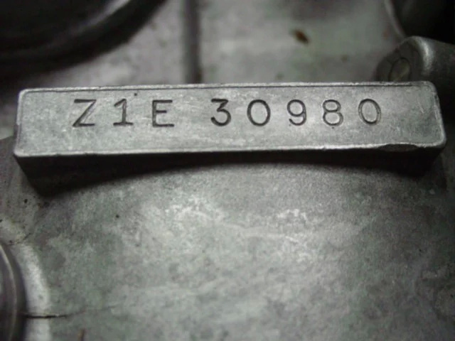

#11 PostAuthor: warren3200gt » Wed May 20, 2020 10:07 pm
Zed1015 is correct and what I was trying to describe in my earlier post. As per pic below. Being the suspicous type without that ridge I would be thinking the numbers have removed from a nicked and parted out bike.

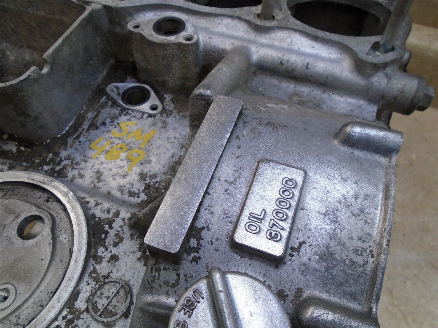

#14 PostAuthor: rpeters » Thu May 21, 2020 5:41 am
Yep, thats been removed, I had a replacement engine which was un-stamped, see pic below
