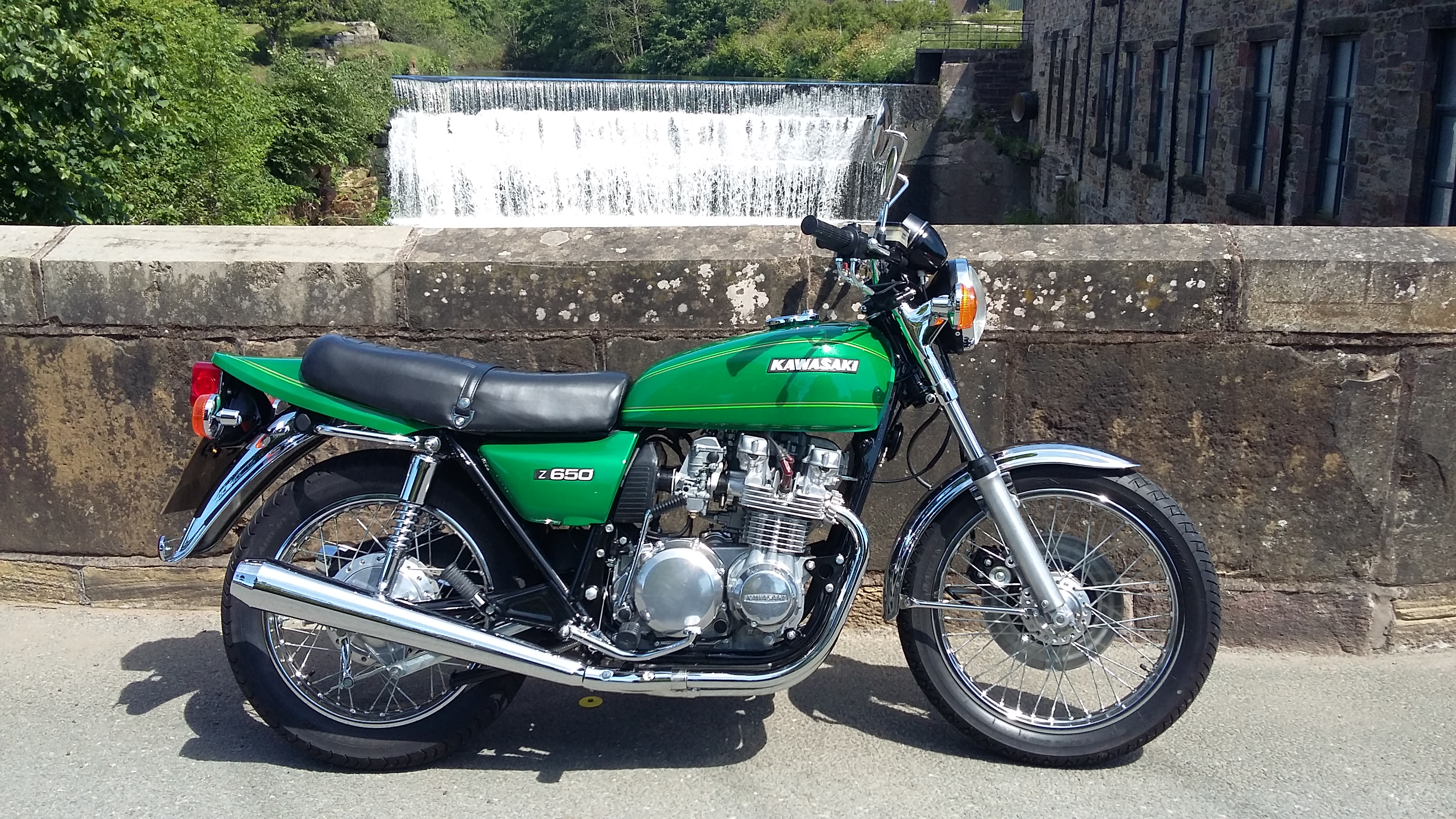

#5 PostAuthor: DavidZ1R » Mon May 25, 2020 3:10 pm
Today, I tried a small adjustment on the air screws, I backed them all off 1/4 turn, then did 50 miles, ran a lot better , no St St stutter, next issue, realised lights dim, not charging, thankfully just the red regulator wire come apart, all good now, also bumped into Keith Z1R, on his classic beauty. A pic of my 650 for those not on face blog.

#7 PostAuthor: z1bman » Mon May 25, 2020 9:12 pm
you have done a great job on that david bet you are well chuffed

#8 PostAuthor: DavidZ1R » Mon May 25, 2020 10:02 pm
I'm very happy with it Paul.
