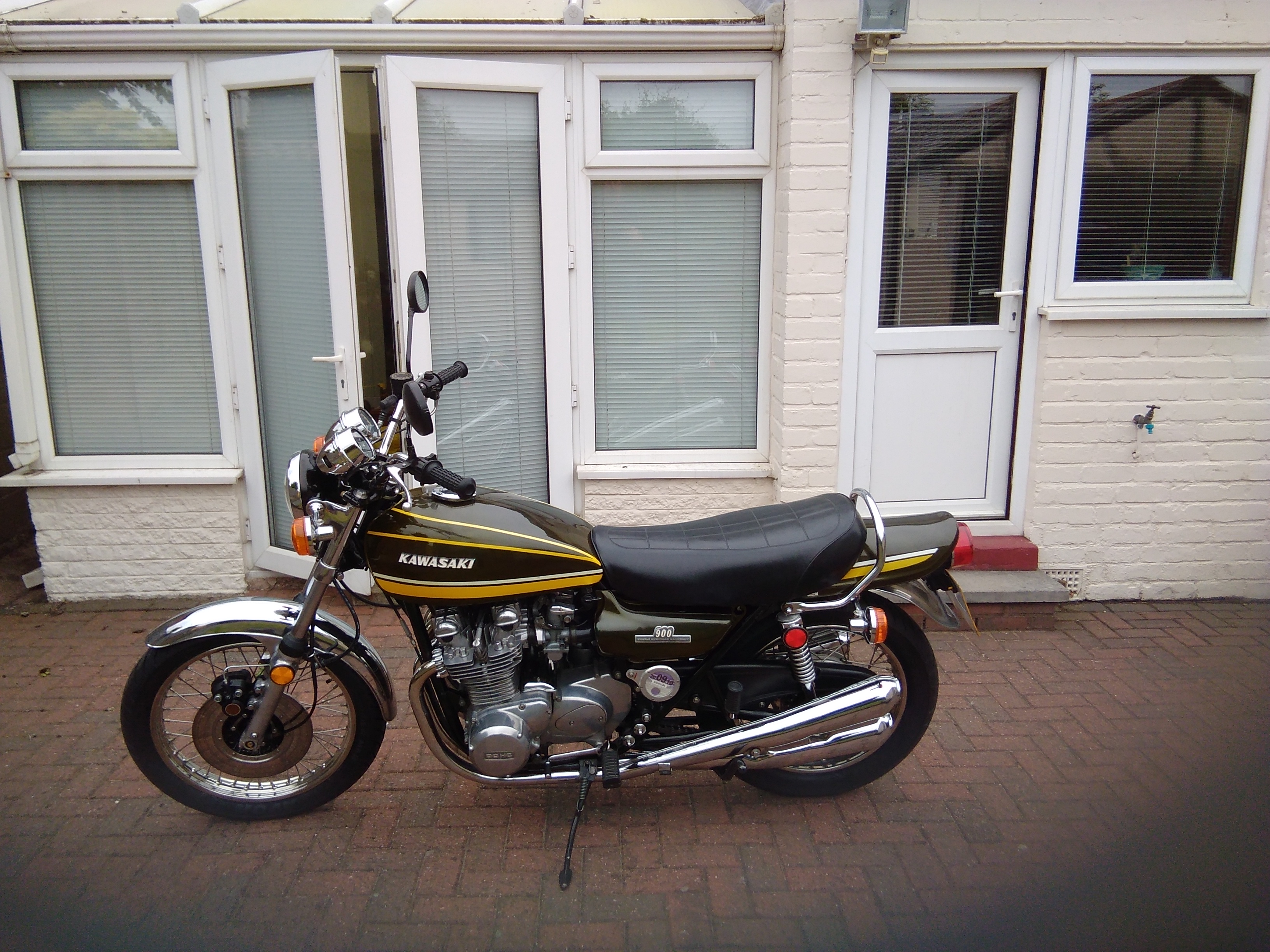

Laymans question time gain! Firstly - a big thank you to all the help and advice recently, I put a new dyna s ignition in and bike the bike seems to be running great, best it has ever ran to be honest well enough to try a ride out and get her MOT'd. But one thing concerned me, the clutch cover seemed almost hot enough to fry an egg on a journey less than 10 miles, which I've no recollection it ever getting that hot before, and noticed the oil in the sight glass didn't look quite right either-like a film building up on the inside and slight foam, The engine has had fresh oil and filter, but prior to that had not even turned over for ten years. The guy in the Mot place said looks like it could be moisture mixing in with the oil from years of being static. Probably or something more sinister? I plan to flush the engine with liqui moly, put fresh oil and filter in again, but also considering using that Zx1 extra lube friction reducer with the fresh oil afterwards! What are the opinions on liqui moly and ZX1 (which isn't cheap), good or not worthwhile using? Lastly, just the simple pleasure of being able to add a photo of the bike breathing fresh air for the first time after 10 years under a cover, which felt fantastic and one of the very few good thing that came out of being furloughed, cheers Mike
