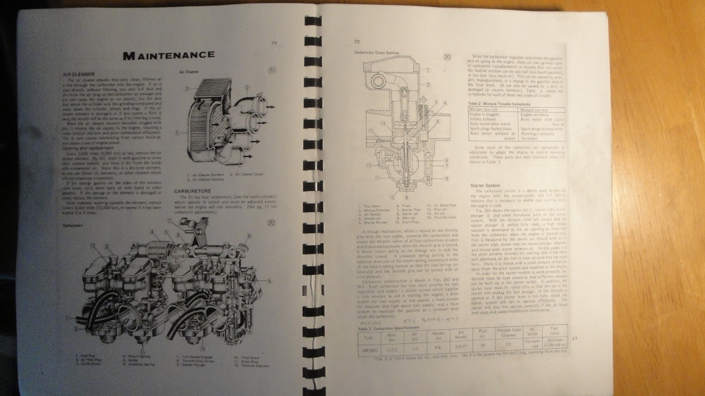

Here's the maint. manual page with the standard Z1b jets and needle nomenclature.
- Attachments
- 3b. Jetting chart.JPG (152.66 KiB) Viewed 3627 times
- 3a. Carb maint..JPG (183.72 KiB) Viewed 3627 times
- 3. shop manual.JPG (149.04 KiB) Viewed 3627 times
Re: Z1-B rebuild - carb renovation
rick-chuck wrote:Here's the maint. manual page with the standard Z1b jets and needle nomenclature.
That isn’t the spec for a Z1B. The Z1B has 1.5 cutaway, a 17.5 pilot and the needle should be on slot/ groove 2.
