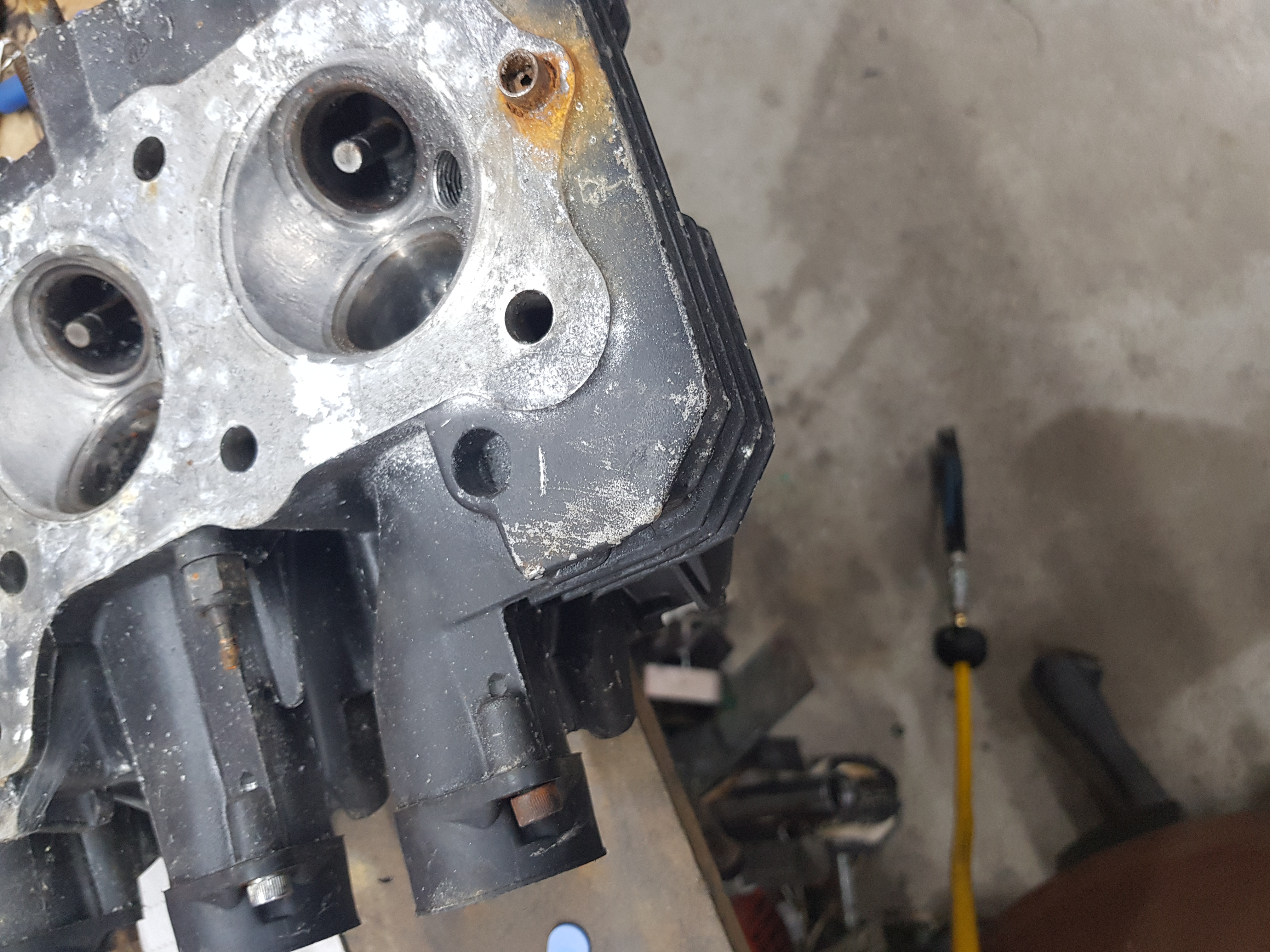

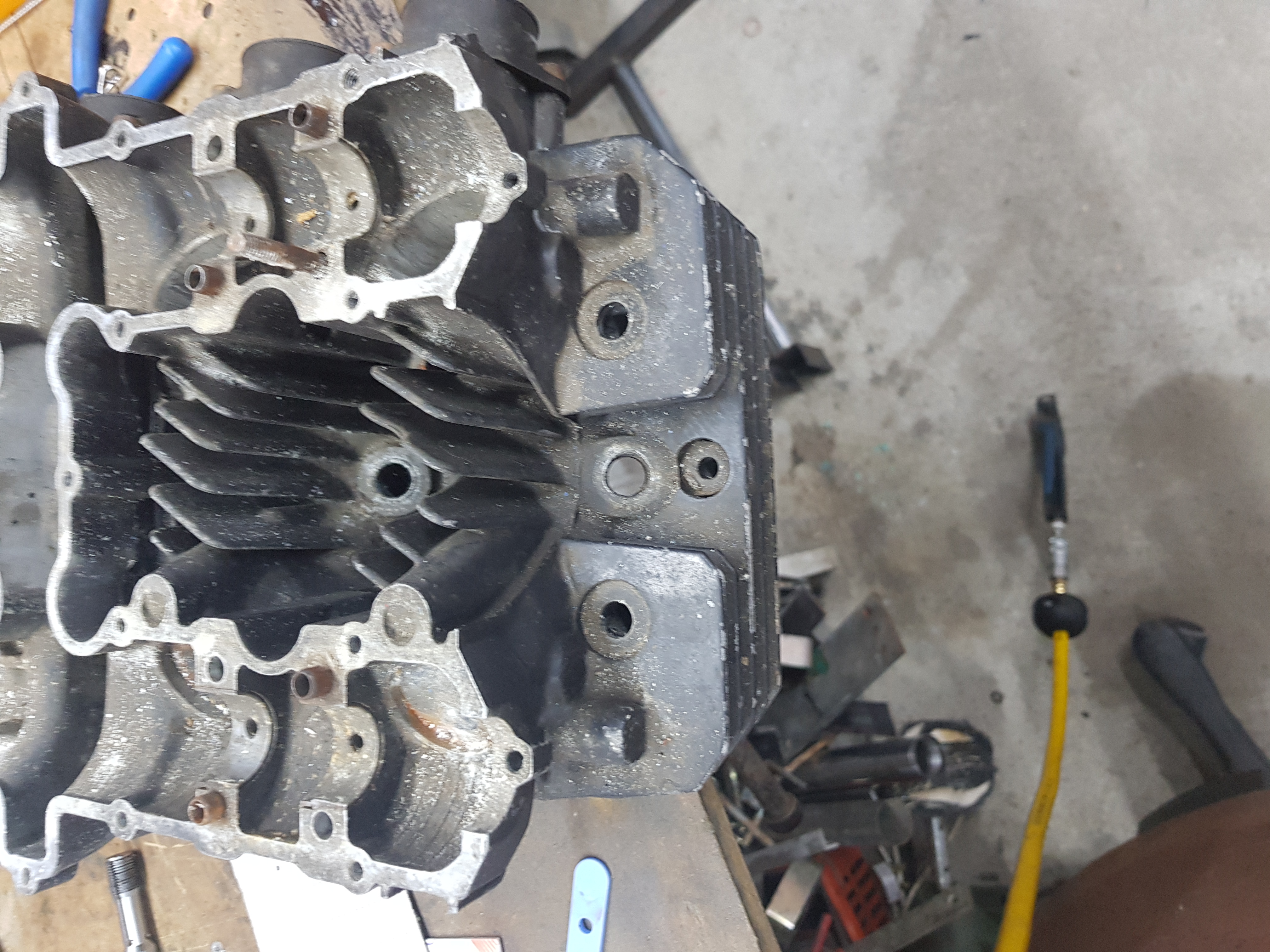

Hi,
How do I tell the difference, can you tell from the bore size?
I have one only so can't compare and not sure which it is.
It will be for sale.
Cheers,
Mark.

Z1000H will have rounded fins as per its predecessors and the GPZ will have angled fins.

Thanks Gus, this is GPZ then.

I would say so but a higher pay grade maybe able to confirm. :D

Yes! That's a GPZ1100 B1 head.

Deffo GPZ. extra cam cap screw position where the cam rubber goes. and the angled off fins on both front and back ends of the head.
