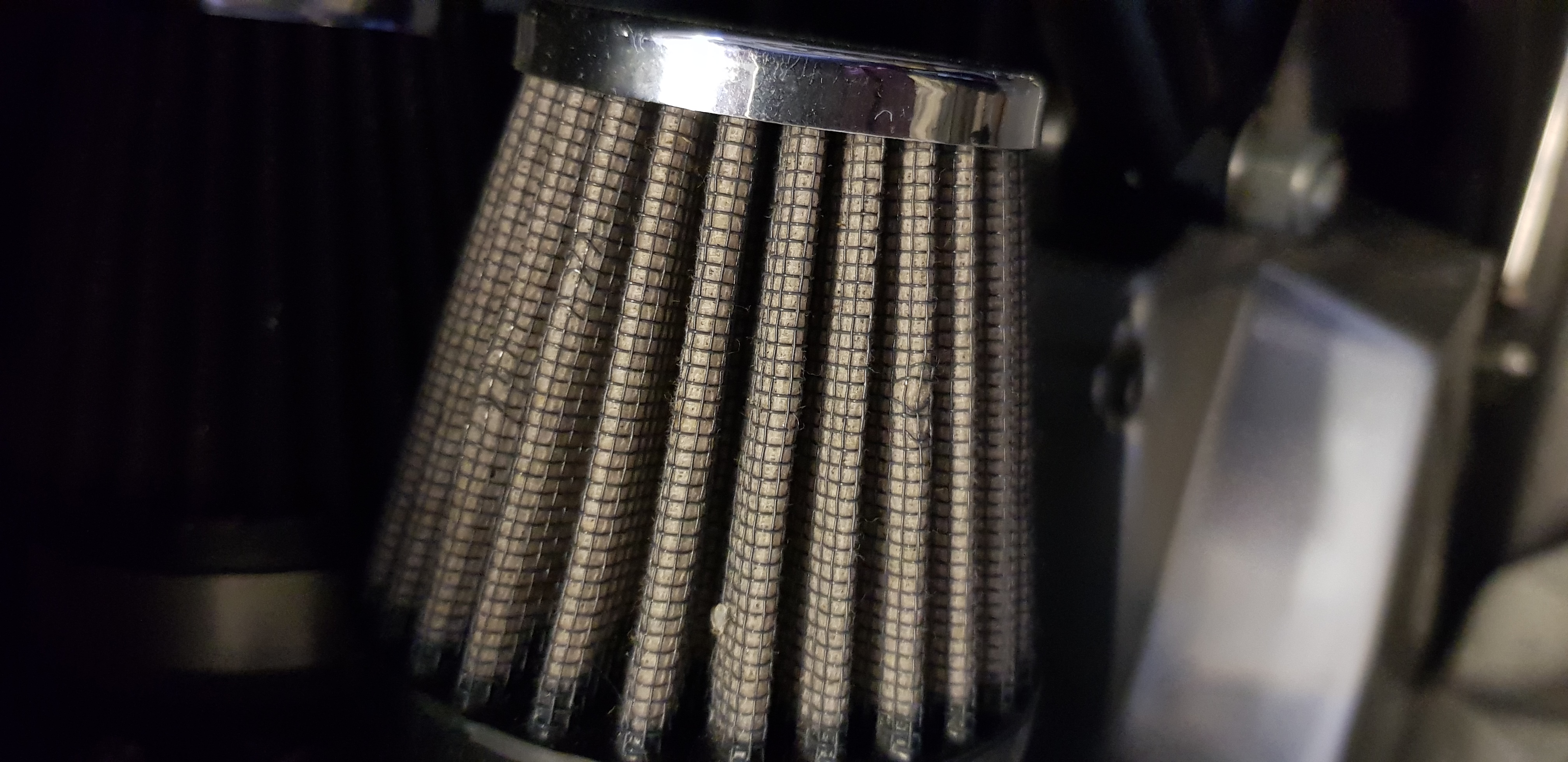

Is there any cleaning/servicing to be done to these filters? Sat on some BS34s atm.

Wash them out with hot soapy water.
Rinse with cold , leave to dry or blow out with low pressure compressed air and you are good to go.

Brill, nice and simples. No special oil required or owt?

If they are Genuine K&N then you are supposed to use their oil to catch the smaller particles.

K&N stamped on chrome cover at rear of each pod.
