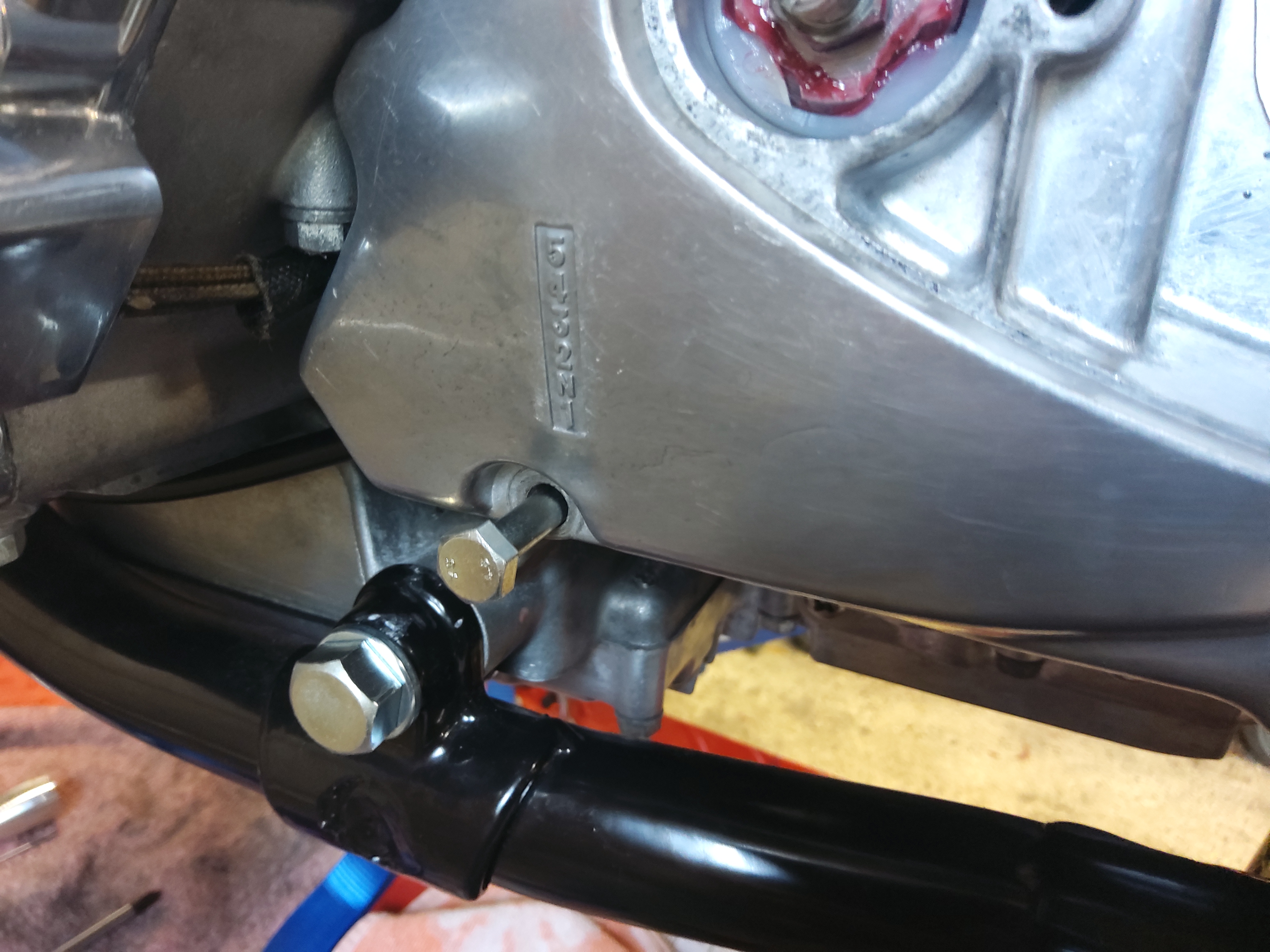

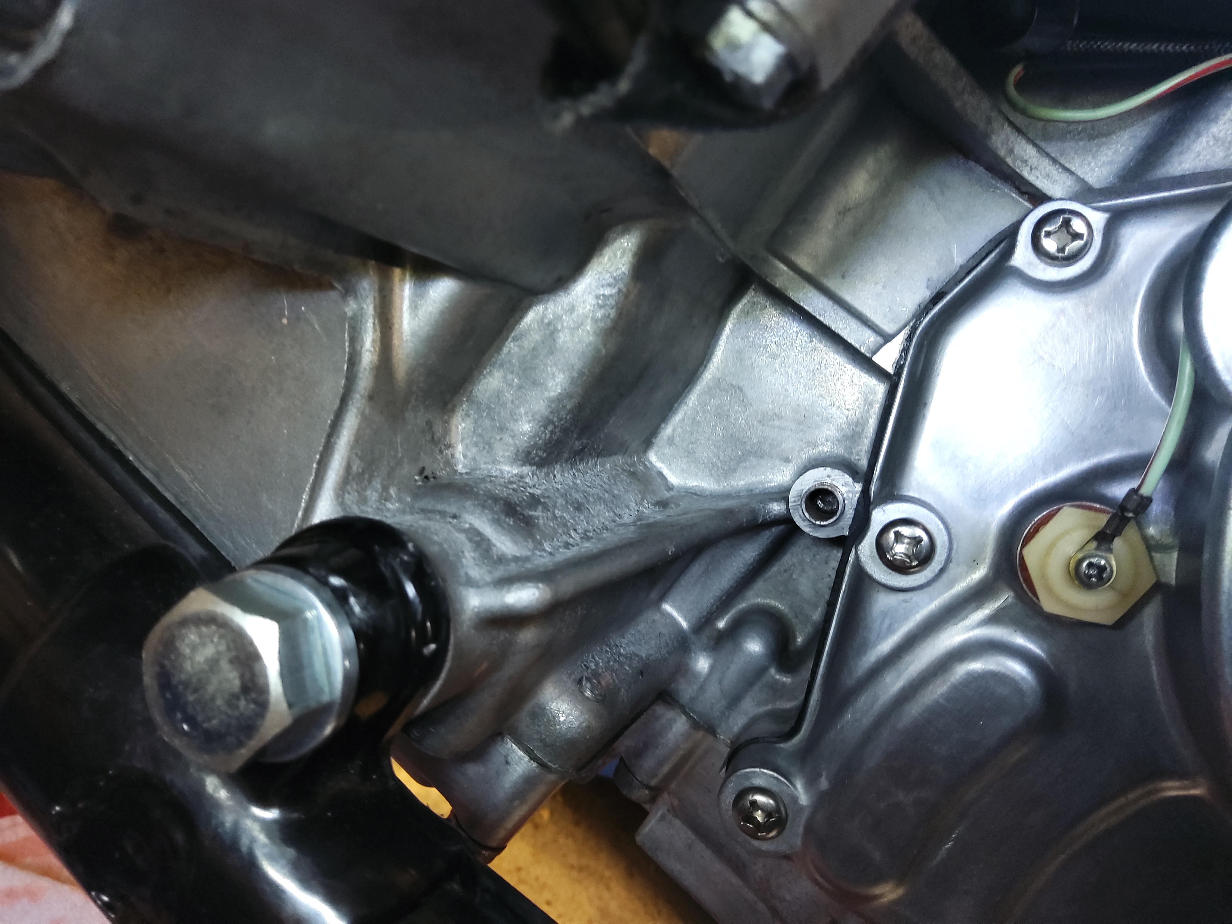

I'm hoping I haven't managed to create the mother of all f**kups whilst rebuilding my Z1-B engine. Last engine cover to go on over clutch release pushrod et al, and I found I couldn't engage the thread on the lower left 125mm bolt which was about 12mm proud of the cover (see pic). On shining a light inside the aperture I found what appeared to be a blind about 13mm inside but no thread (couple of poor pics attached)! Have I somehow managed to screw a bolt from the inside of the crankcase, although if this were true then it means there would be an oil path though to the outer cover. It's got me totally flummoxed. Has anyone got any suggestions before I rip the whole bloody thing apart again?

Looks to me like a previous bolt has sheared off inside the thread.

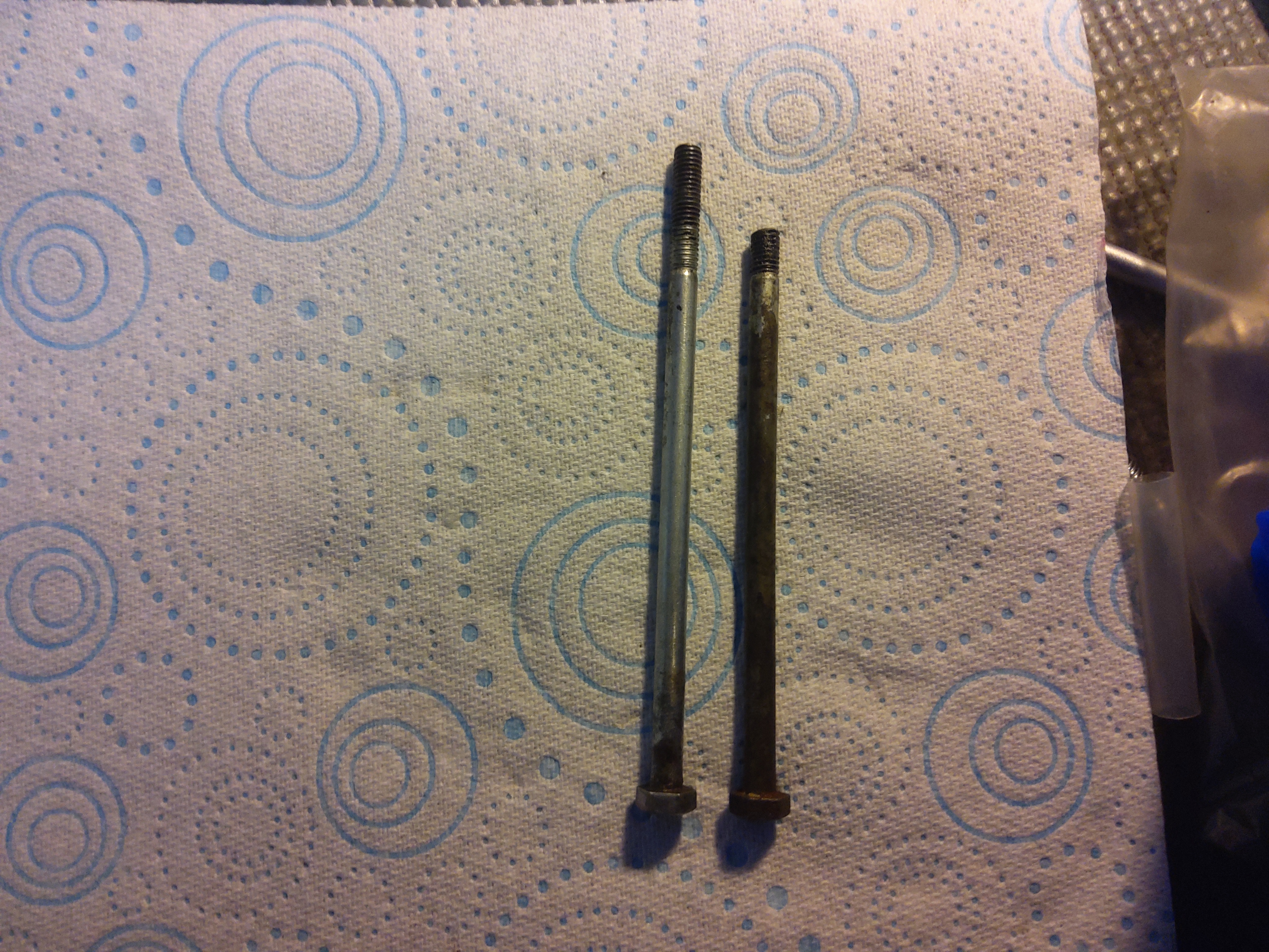

I think I've just twigged! Having just searched my box of old bolts I found this (pictured alongside an original intact 125mm bolt). So would the "blind" I found be the remains of the original 125mm bolt that snapped on the way out? If this is the most likely explanation, any suggestions as to the least damaging way of getting it out, remembering that it has been in there since the bike was built?

Thanks Gus, you're probably correct. I didn't see your reply before I posted my update. But would still appreciate any advice on getting the 12mm of old crap out.

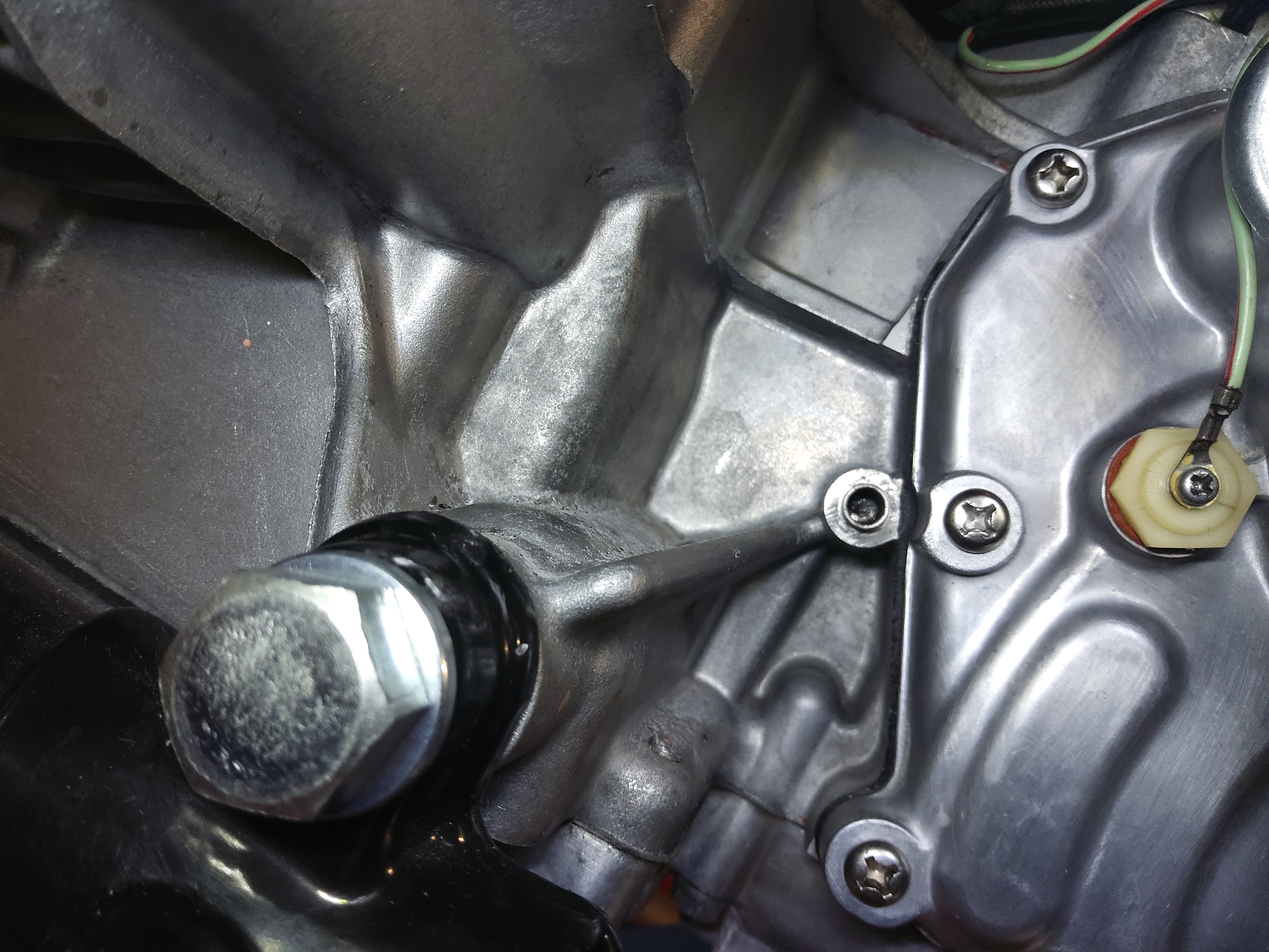

Thanks for all the help guys. Had a bit of a result with this as you can see from the pic. Followed Rob's advice and used a 6mm bit to create a pilot then a DeWalt 2.75mm HSS bit (although they call it a "No. 8" for reasons known only to them). As the bit was almost breaking through the orphaned bolt I had to run it slowly counter-clockwise to pull out and the pic shows the result! Brilliant. Just had to retap the thread and the new bolt went in by hand. This was the last major rebuild issue before re-fitting the carbs and pipes and so I'm pretty happy.
