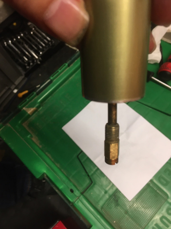

I took the set of carbs off as one, then liberated the left hand pair as per the workshop manual. I then stripped #1 carb - the sticking still happened with the lifter mechanism removed, so the slide or needle then. Here the jet holder tube and the main jet defy gravity by sticking to the needle.
It turns out that the tube is slightly bent. You can't really see it in this photo but it is sightly deformed near the top and is ever so slightly 'S' shaped. I think its just enough to foul the needle and cause the drag.
Because of the taper I can't properly check the needle for straightness. I think its OK but for the sake of a few quid I'm changing it for peace of mind. CMS have one genuine tube and one needle in stock, so I've ordered them. Other carb parts seem to be OEM, I don't want to start mixing n parts from pattern 'rebuild kits' if I can help it. I used these with my CL450, in the end I only got that bike running right by binning all the aftermarket bits and using genuine OEM stuff, new or my old parts cleaned up.

That tube looks like it has taken a hell of a bashing, you can always try the needle in the other carb
