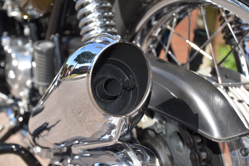

72-73 Z1s had a 'peashooter' coming of the baffle (the one in the photo is not an original but made to look right) - I don't think the later Z1A or B had them?

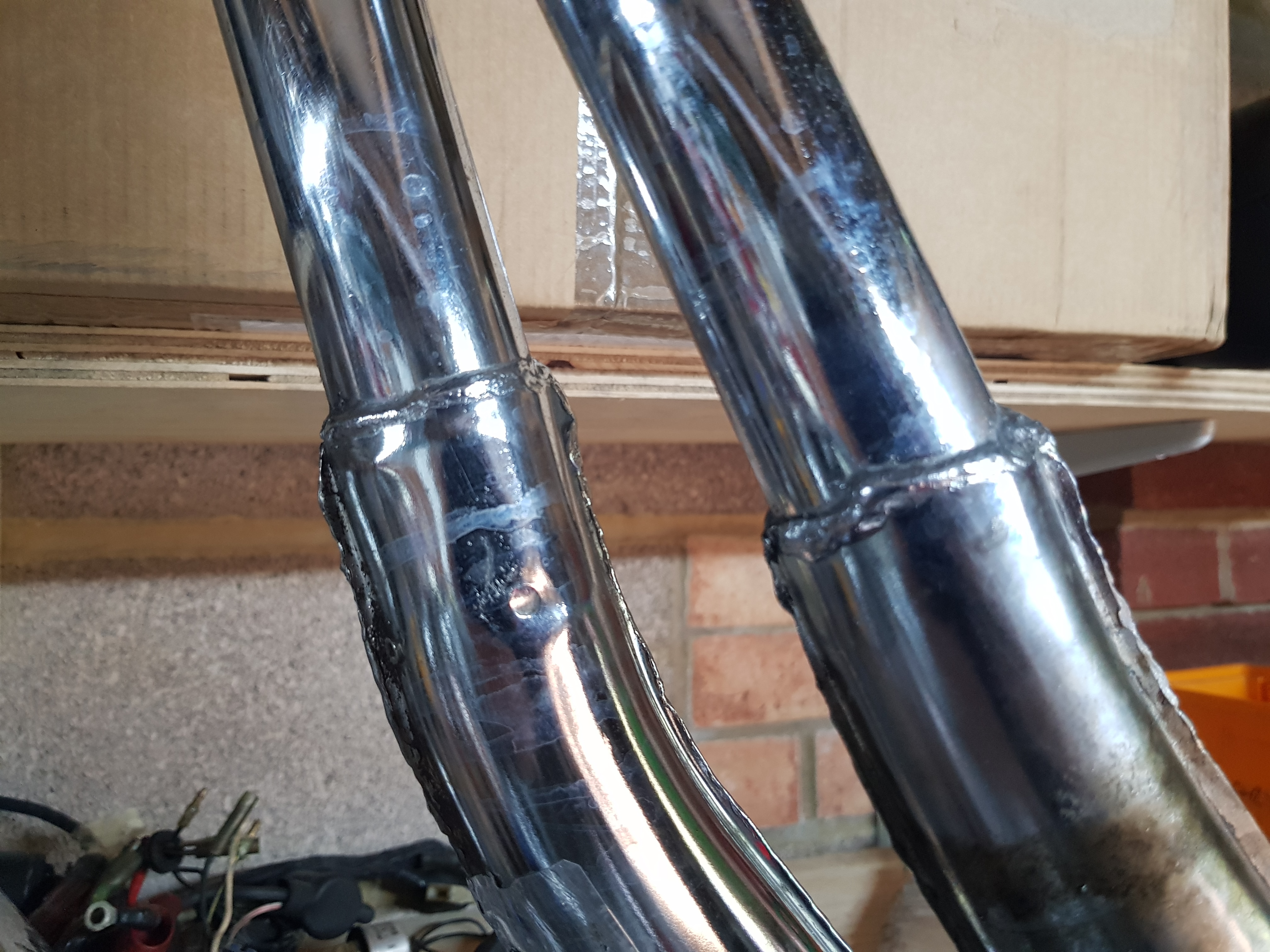

Does the joint where downpipe meets muffler have a 'band' to hide the weld? If not, is the weld chrome plated or painted with silver?
Re: Z1 4-4
#4 PostAuthor: Ultim8pc » Sun Nov 01, 2020 5:06 pm
I'd say the main clue is the quality of the external welded seam. It's pretty scabby on the OEM ones and nice and neat on the repros. I was also thinking about the peat shooter baffles, but not sure if theses featured on the Z1a/b..
Band is chrome plated.

Judging by the one picture, I'd say they are original. What is the date of manufacture for this Z1?

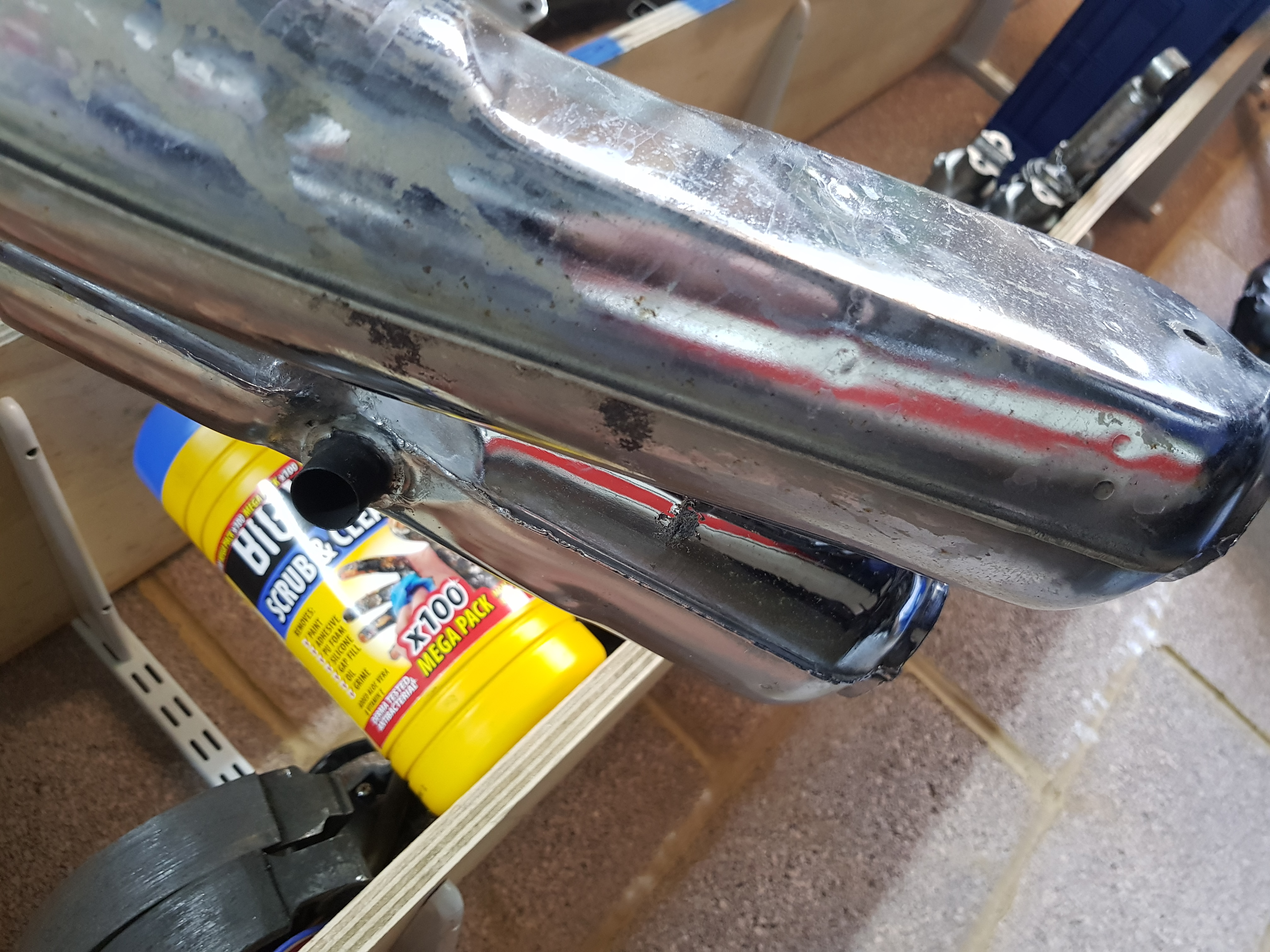

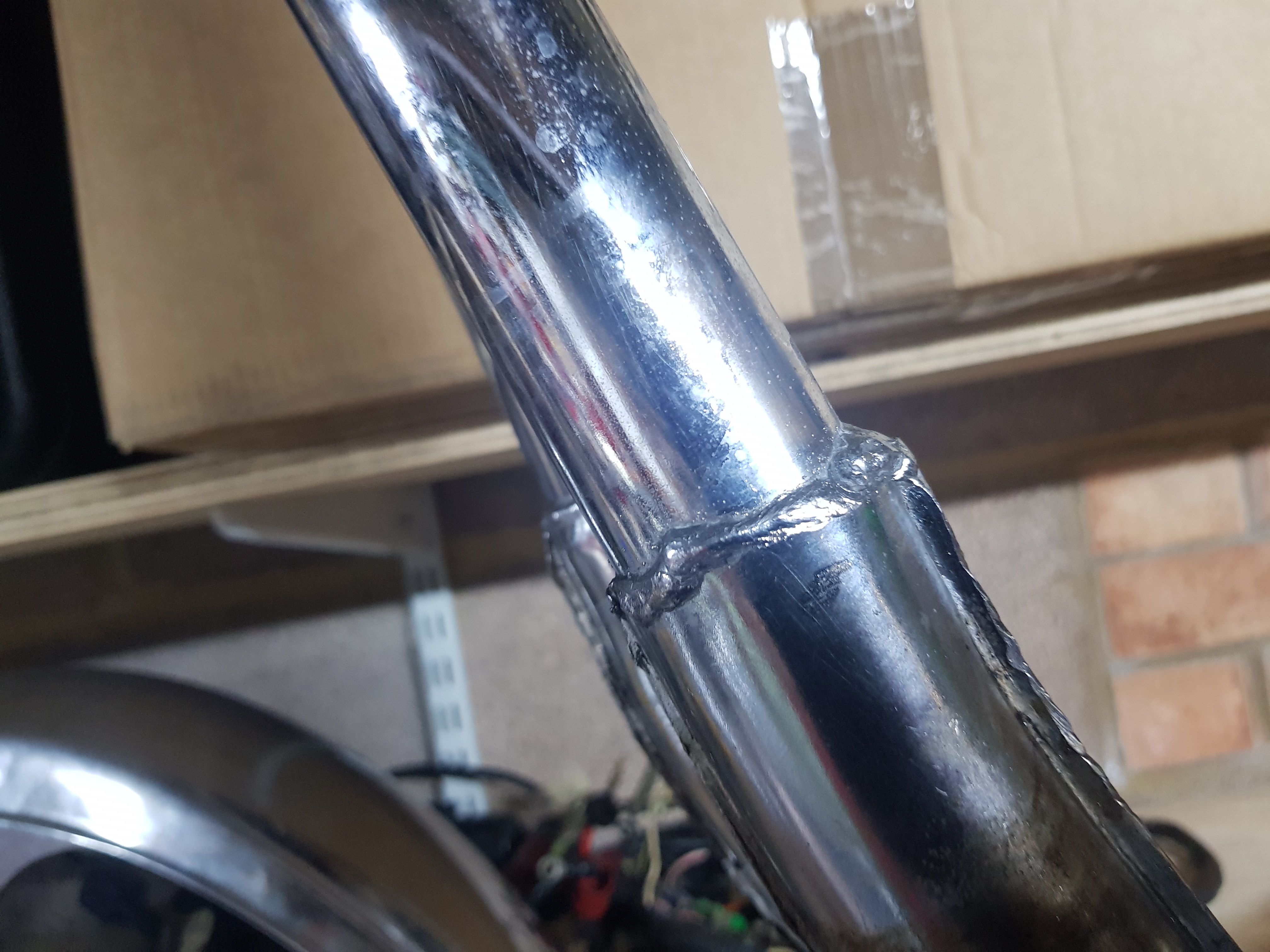

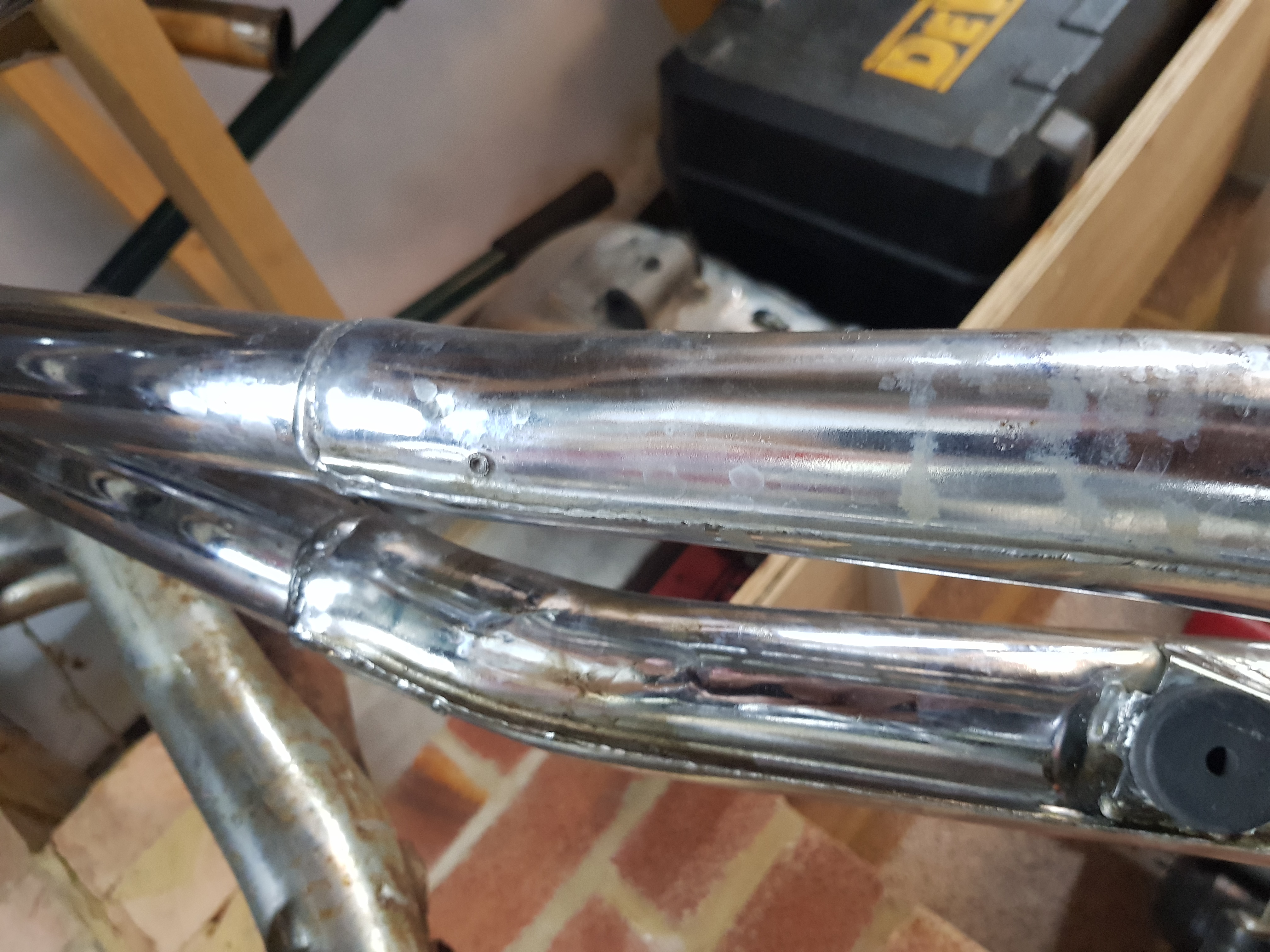

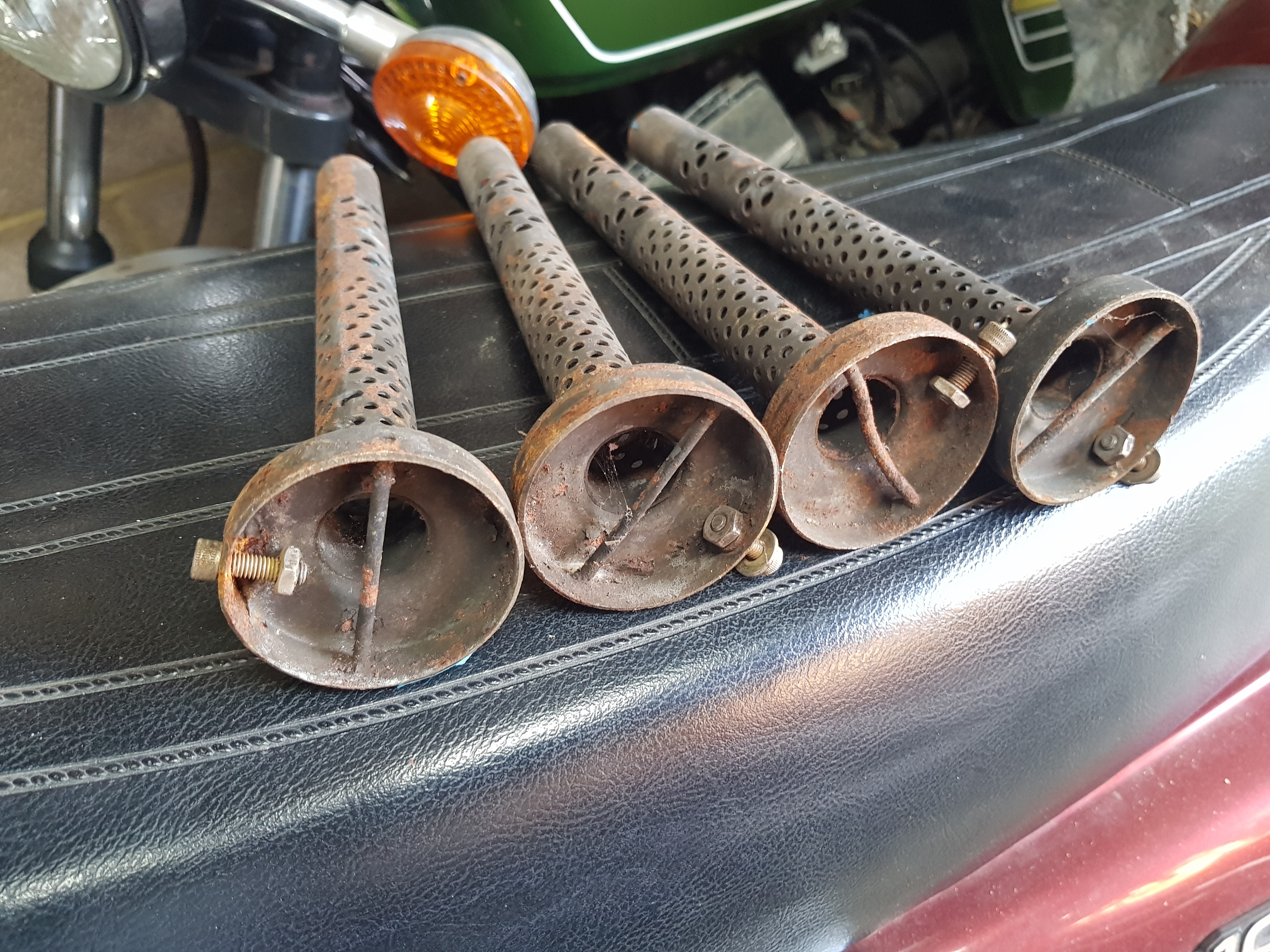

#10 PostAuthor: needaz1100r » Mon Nov 02, 2020 3:28 pm
A few more pics. Trying to decide whether it's worth repairing them, just cleaning them or selling as is.
Thanks for everyone's input
Cheers,
Mark.
Re: Z1 4-4
#11 PostAuthor: Ultim8pc » Tue Nov 03, 2020 9:56 am
Worth repairing as they would be worth around £3k in an as new condition. (repaired and rechromed).
