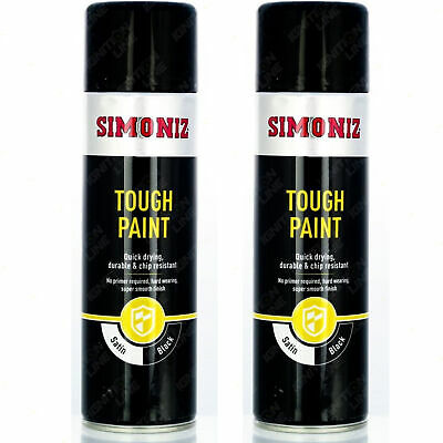

#3 PostAuthor: warren3200gt » Tue Dec 01, 2020 6:44 pm
Simonez tough paint satin black. Straight onto bare metal from a rattle can. Fuel resistant after a heat cycle. Touch dry in 10 minutes. Easy to use and readily available.
I have a engine painted in it and 5 years no lifting or peeling.

#4 PostAuthor: zed1015 » Tue Dec 01, 2020 7:22 pm
As above, SIMONIZ/SPEREX Tough black satin .
The closest you are going to get to original and will last years.

Just blast it to bare ally.
Then heat to sweat out any moisture and spray.
No primer needed.
Let it dry overnight then either cure naturally with the engine heat or bake in an oven or under the grill.

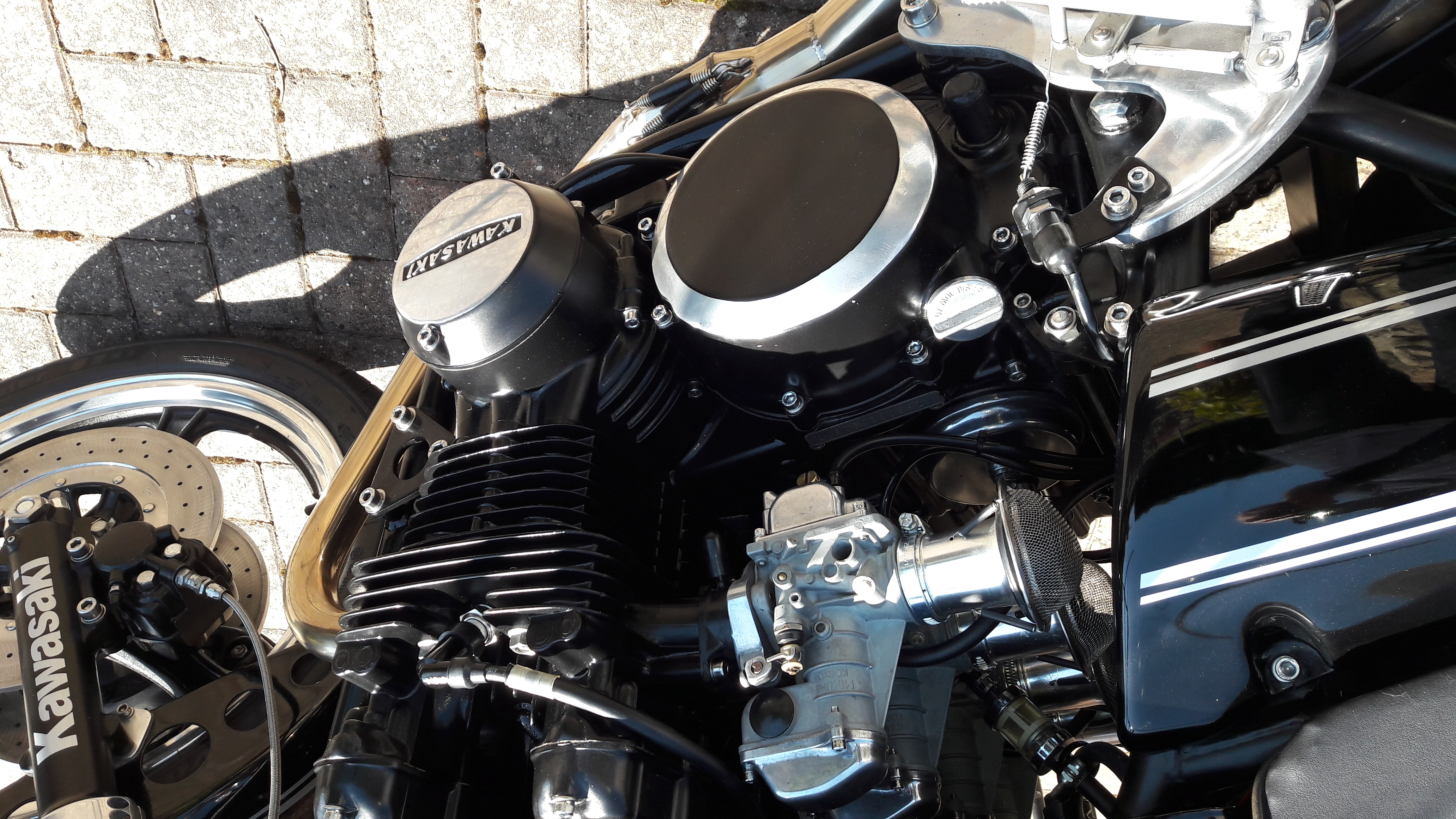

#7 PostAuthor: Grimreaper » Sun Mar 21, 2021 9:41 pm
I will find out what the guy who did my engine used. I ts looks like factory. I'm sure he told me it was Porsche black.

PJ1 ..
They changed the formula and now it is useless.
Sperex Competition black case paint was the equivalent and very good stuff.
It is now called Sperex or Simoniz Tough black and performs the same.
It is fuel resistant once cures.
