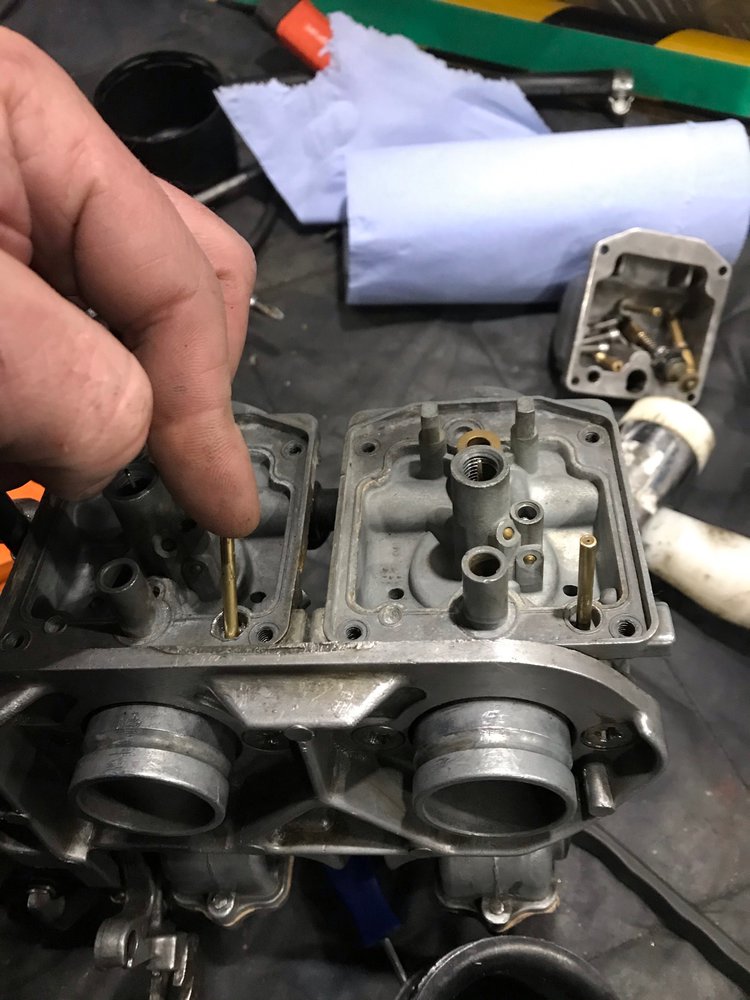

Hello Chaps
I wonder if any of you can help, I have managed to break one the brass tube that I Assume feeds fuel to the choke mechanism, see photo! The Clymer Manual diagram and parts list doesn’t list it, does any one know the correct name for it so I can search for one or if any one knows where I can get one. Thanks in advance.

The choke pick up tube isn't and wasn't a separate item so isn't available as a new or replacement part.
You will have to either obtain one from another carb or make one from brass tube.
They are a press fit so not hard to remove.
Put a post in the Wanted ads section and there will probably be a member who has a spare.

Kind of what I thought, I will do as you suggested to se if any one has one, There is a nice set of fully restored carbs on e- Bay But At £950 it’s a bit much :lol: Thanks
