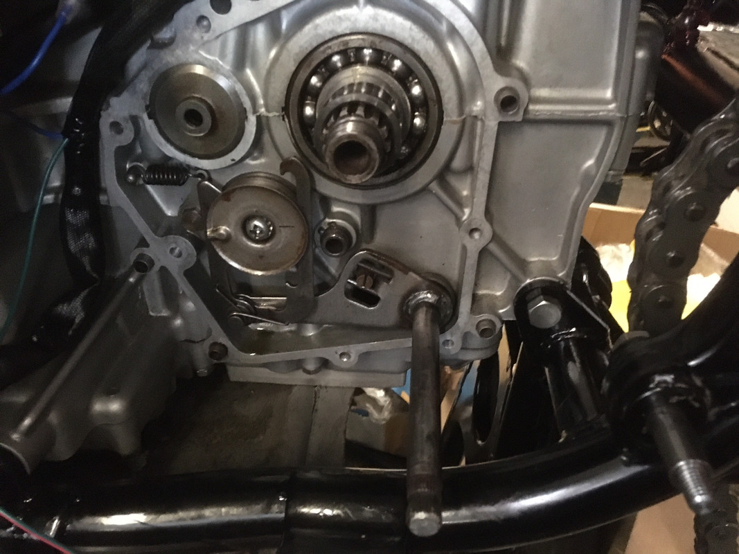

My suspicion was a bent gearchange rod, when I got the bike (in bits) the cover wasn't fitted, and the shaft could have been bent in storage if all the engines weight had ever been put on it. Suspiciously about the only spare part the bike came with was another gear change shaft, so I decided to change it anyway as the splines for the lever were in better condition. Here it is fitted, and all working perfectly. The return spring is the correct 3 turn early one. It is the shorter modified type, so there is no issue with the spring fouling the boss with the dowel. I presume I've got the arms into drum selector right, unless you can see different.

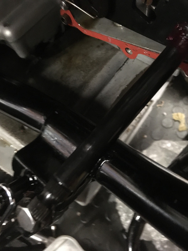

The new PMC gear selector rod was anodised black. A carp out of focus photo I know, but, where the gear rod crosses the frame tube, you can see a witness mark which corresponds to the hole thorough the alloy casing. I wondered about just getting this hole drilled oversize, but then you have support issues, and could bend or damage the inadequately supported gearchange when using it.
This has to be sorted. Although I can't see what's wrong, I eliminated the shaft by replacing it with a new one, now I need to try another cover.
