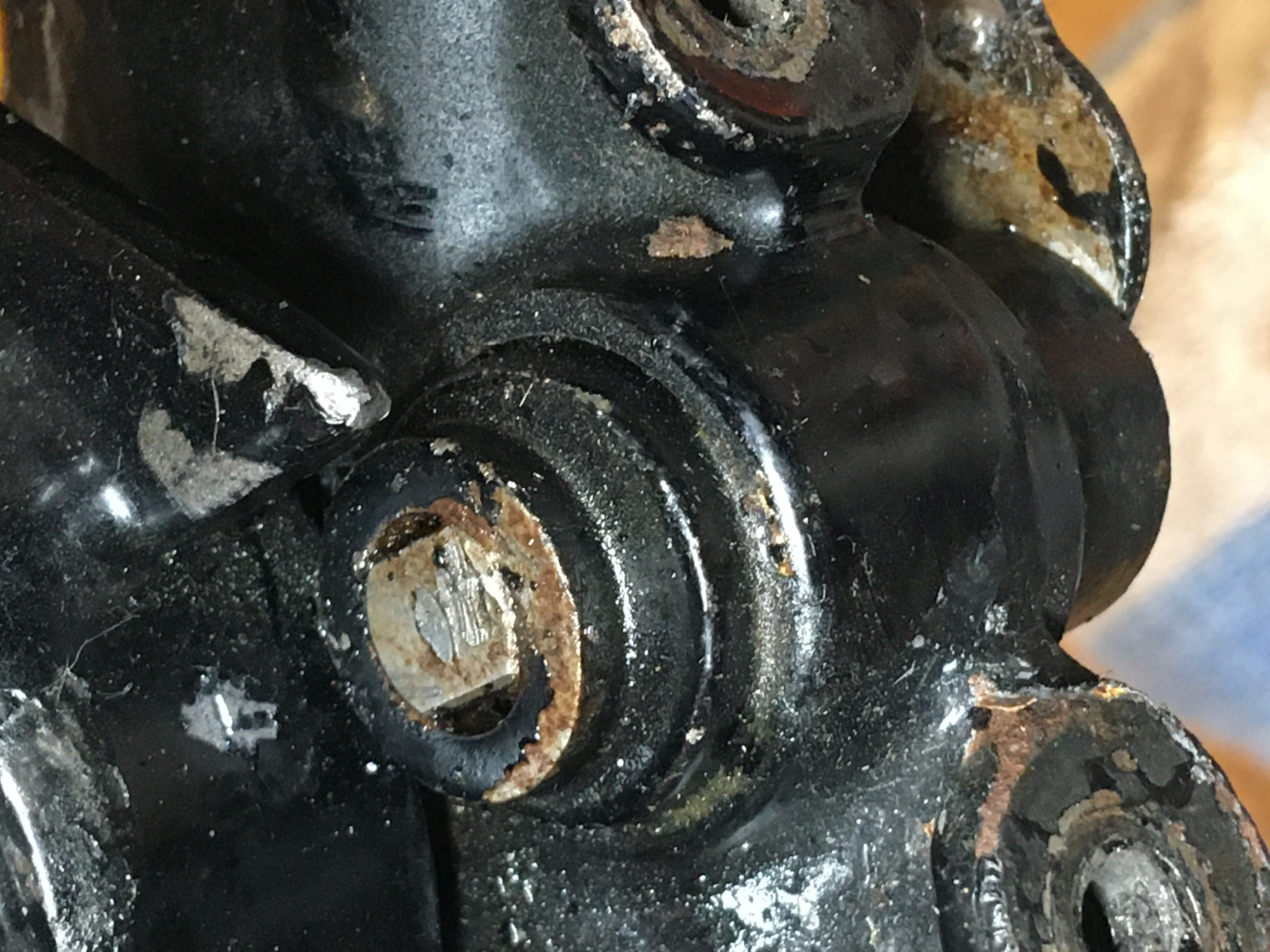

Having trouble with removing steering lock which is positioned at the base of the bottom yoke.
There is a hole beside the barrel but no locking grub screw visible.
Any ideas welcomed.

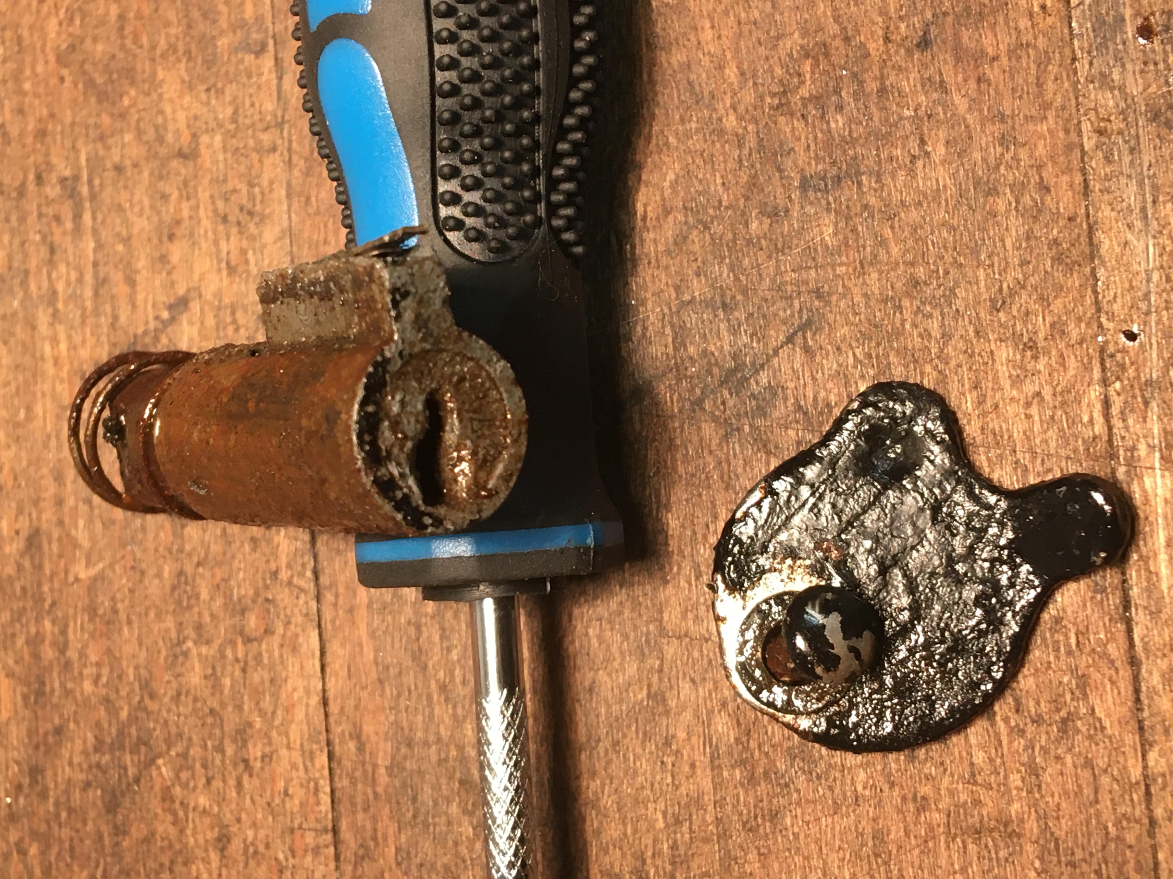

#2 PostAuthor: z1bman » Tue Mar 16, 2021 3:02 pm
remove the metal cover & knock pin & it should tap out from the top end of the steering stem

#3 PostAuthor: KwakaRascal » Tue Mar 16, 2021 5:06 pm
Hi Z1bman,
Thanks for the tip, drifted out with ease. :up
